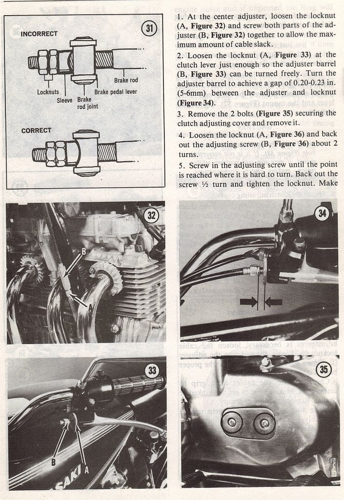

Re: '79 KZ650 Kickstart issue
16 Oct 2011 17:40 - 16 Oct 2011 19:59
On the opposite side there's the clutch mechanism behind the Sprocket Cover that pushes on the clutch push rod.
If the clutch mechanism is adjusted wrong, too far in, it will engage the clutch and may make the kickstarter useless.
Remove the two bolts that hold the small outside cover in the center of the Sprocket Cover.
Loosen the lock nut (A) that holds the center adjusting screw (
, and turn in the screw until some resistance is felt. (figure 36 below)
I'm guessing it's already turned in, maybe too far.
In this case, back out the adjusting screw counter clockwise, then turn it back in clockwise until you feel resistance, then back out the screw to what a manual states, I think it's 1/2 turn, but will need to confirm this.
Then hold the adjusting screw in place while you tighten the lock nut.
Make sure all 4 mounting bolts of the Sprocket Cover get installed if you've had the Sproket Cover off, and that the clutch cable is seated properly in the Sprocket Cover. (figure 38 below)
Then adjust the clutch cable so that there's 3 mm of free play at the clutch lever. (fig 37)

Adjust the clutch using the procedure in the manual. There's more to it than just the cable. Ed

Today i took off the cover with two screws, backed out the adjuster screw, and got the engine to turn over every time. Now my next step is the carb. Thank you for all the help on this, it was greatly appreciated.
