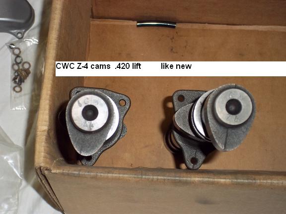

Did you buy it?
How Much?
I'm sure they are great cams for High Perf, drag race, High RPM!
CWC are cycle works performance from the 80's, that I know of.
I have a set that are stamped Z-4 CWC.
They are about .418 lift.
Just buy the stuff, worry about it later.
These are $200 bucks
How Much?

25 Sep 2011 21:53
Did you buy it? The whole bike? Just the parts?
Whatever, the stuff?
Just buy it, worry about it later.
CWC is from the 80's Here is a Z-4 cam set. About .418 lift
These are worth $200

Re: cams
27 Sep 2011 22:25
very good to know my cams say z-5 they measure out at 410 and 430.Yes I bought the entire bike every piece was stripped from frame.oh boy!

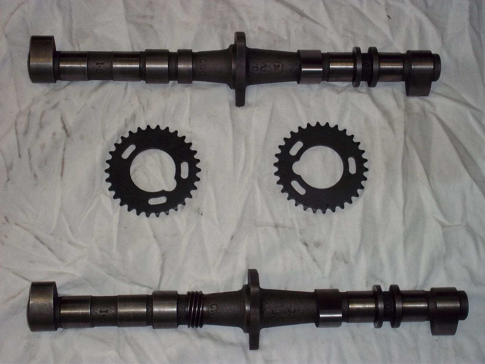

hello
this cams are cwc k259

27 Nov 2011 19:45
The CWC that is cast into the side of the cams in the photo that also has our cam sprockets, is the name of the manufacturer of the blanks. All American made aftermarket cams has the CWC in them. The company has had name changes or been sold several times, but the blanks still say CWC.
