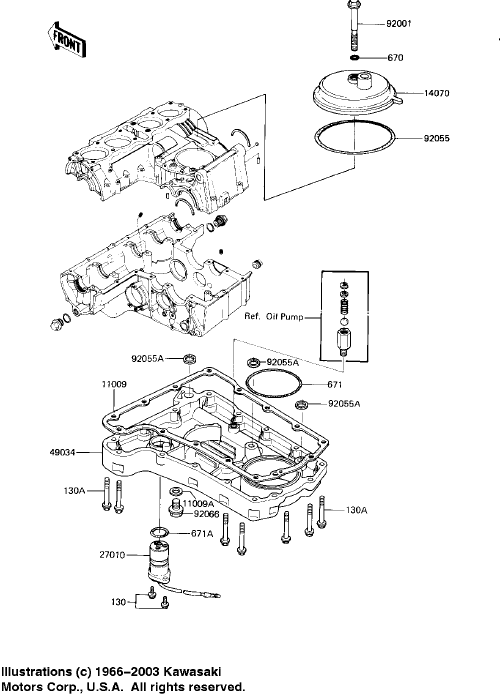

gengomerpyle wrote: thanks, i guess ill pull the cover off and check the connection. i got the filter from my local kawasaki shop so i know its the correct filter. i did replace the washer and spring that goes under the filter since they were all bent up and were put on top of filter.
All looking like this? Could it hurt to double check?

Re: oil light flashing
28 Aug 2011 22:00
#472399
While I don't see a Level sensor in the Diagram, it would certainly explain the "After Oil Change" scenario.
30 Aug 2011 02:19
#472744
You had the wrong diagram (Breather cover / oil pan section)
There you go ;)
30 Aug 2011 15:53 - 30 Aug 2011 15:54
#472898
yep, that would be the correct one. thanks
There you go ;)
