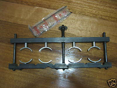

13 Jun 2011 20:51ELCouz wrote: ...Won't you need 4 clamps instead of 2 ? (4 pistons)....
Two clamps are sufficient when pistons are fitted two together at the same time.
Here's the factory tool whereby all four pistons may be simultaneously fitted.
Be extra careful when dealing with the oil ring, as it is the most easily damaged.

14 Jun 2011 10:48Patton wrote:ELCouz wrote: ...Won't you need 4 clamps instead of 2 ? (4 pistons)....
I had one of those and it was a pain in the ass to use. I like the chop sticks with a friend method.
