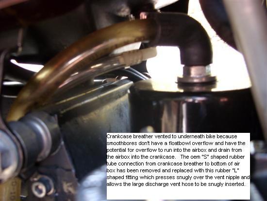

- Posts: 18564
- Thanks: 2103
Re: Crankcase breather connects to...?
10 Jun 2011 10:47 - 10 Jun 2011 10:57
Would not restrict the free breathing of crankcase to less than designed by Kawasaki.
Venting into the air box likely allows slight vacuum assistance toward relieving pressures from the crankcase.
Imo, the aftermarket accessory filters attached to the crank case vent nipple are about as helpful as blinker fluid.
Where stock S-tube or L-tube connection to the air box risks fuel contamination into the crank case (due to lack of carb overflow circuits or non-functioning carb overflow circuits due to blockage or whatever reason), a large i.d. tube may be used to route the venting to underneath or behind the bike.
My Z1 with smoothbores (no overflow circuits) is routed from the vent over the swing arm, and has served perfectly forever, including cross-country.
Attachment crankcaseventhose.jpg not found
