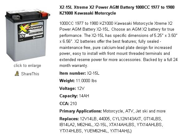

AGM for the YB12A-A,
www.amazon.com/Xtreme-Volts-Sealed-Batte...places/dp/B001MVG0CS
