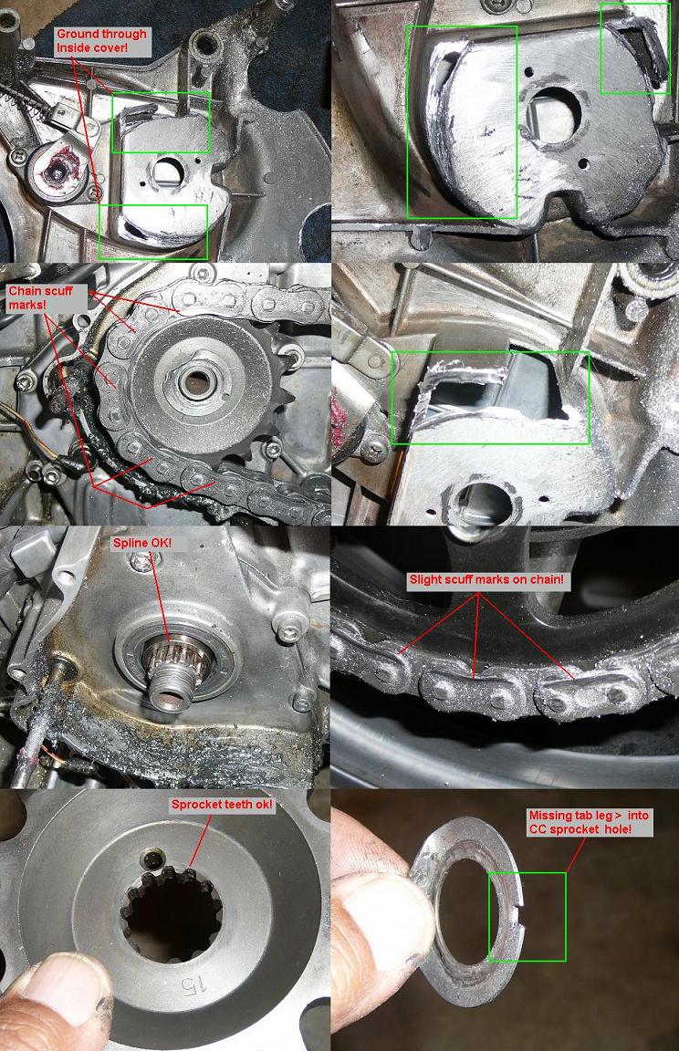

If not already done, would assure final drive chain is in good condition, well lubed, and free of any kinks. And that rear sprocket also remains serviceable.
And also check and assure that the front (counter-shaft) sprocket is in decent condition and hasn't come loose on the spline.
