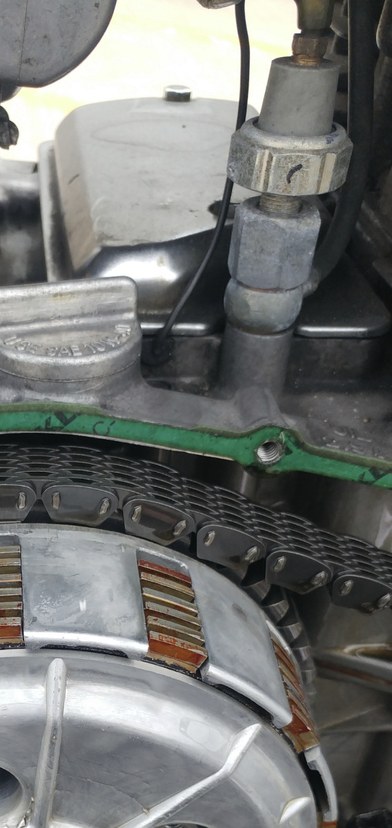

Re: oil pressure switch for 81 440LTD - where?
09 Mar 2022 18:22
Greetings!
This is how I found the bike when I got it the other week…
seems a clever use of JBWeld to “stop a leak”
19 Mar 2022 17:24
Why would anybody weld up the Oil Pressure Switch if you don't have oil you don't get far I have run 400s and 440s for 40 Years now and never had a problem the 440 runs a low pressure high volume oil lubrication system and the Oil pressure Switch used was used on most Kawasaki's from that era so there shouldn't be a problem finding one. The way to Test one is very Simple connect the +Tester to the Top and the - to the thread and then gently push the right size Rod up the oil Hole and the tester should register a connection.
