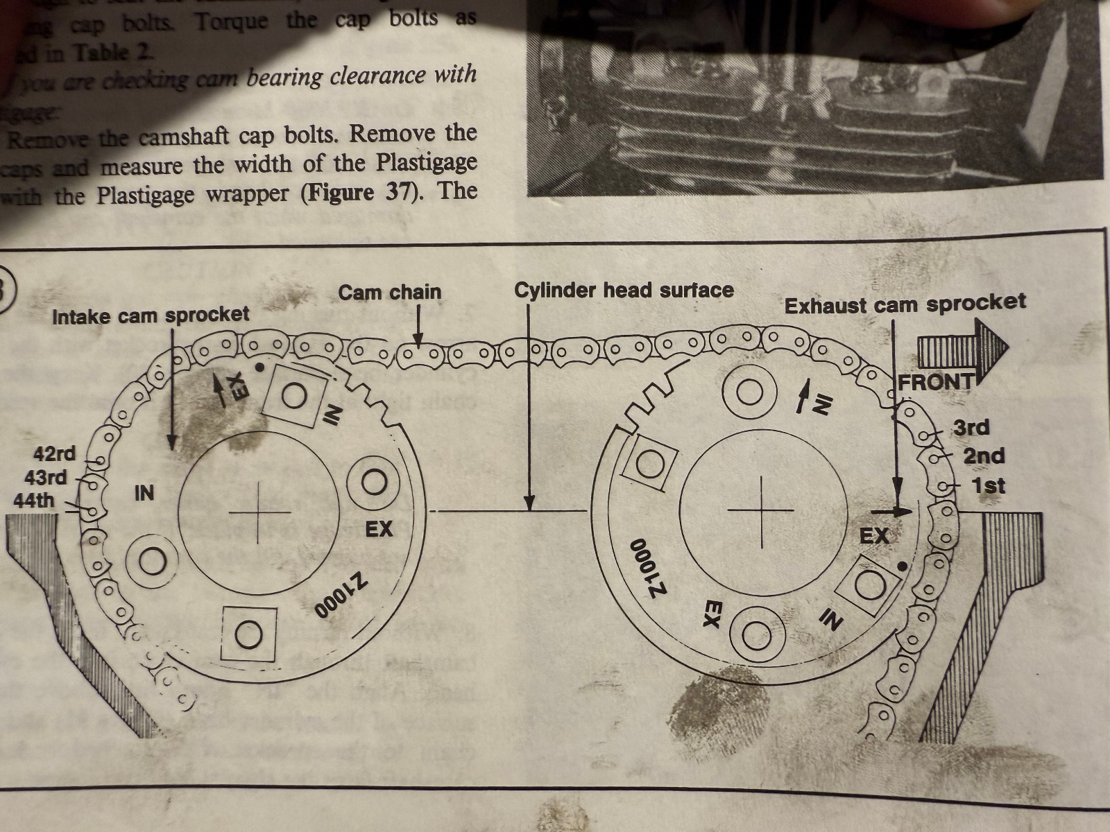

Anyone have the cam timing diagram? I need to verify that the cam timing is set correctly but I don't have a service manual for this bike.Also need to confirm the location of the cam caps. The front 2 look right but the rear two seem swapped to me.Does #3 cap go on the left rear or right rear?

No manual to verify pin count...sorry
Cam caps are left to right 1-2, 3-4.

With the Hyvo cam chain 44 pins

the exhaust arrow even with the head then count 44 pins in the chain and the intake arrow should line up even the head both arrow should point away from each other.... exhaust arrow points to the front and intake arrow to the rear..... the cam caps are exhaust cam left to right one two intake cam left to right is three four... hope that helps
