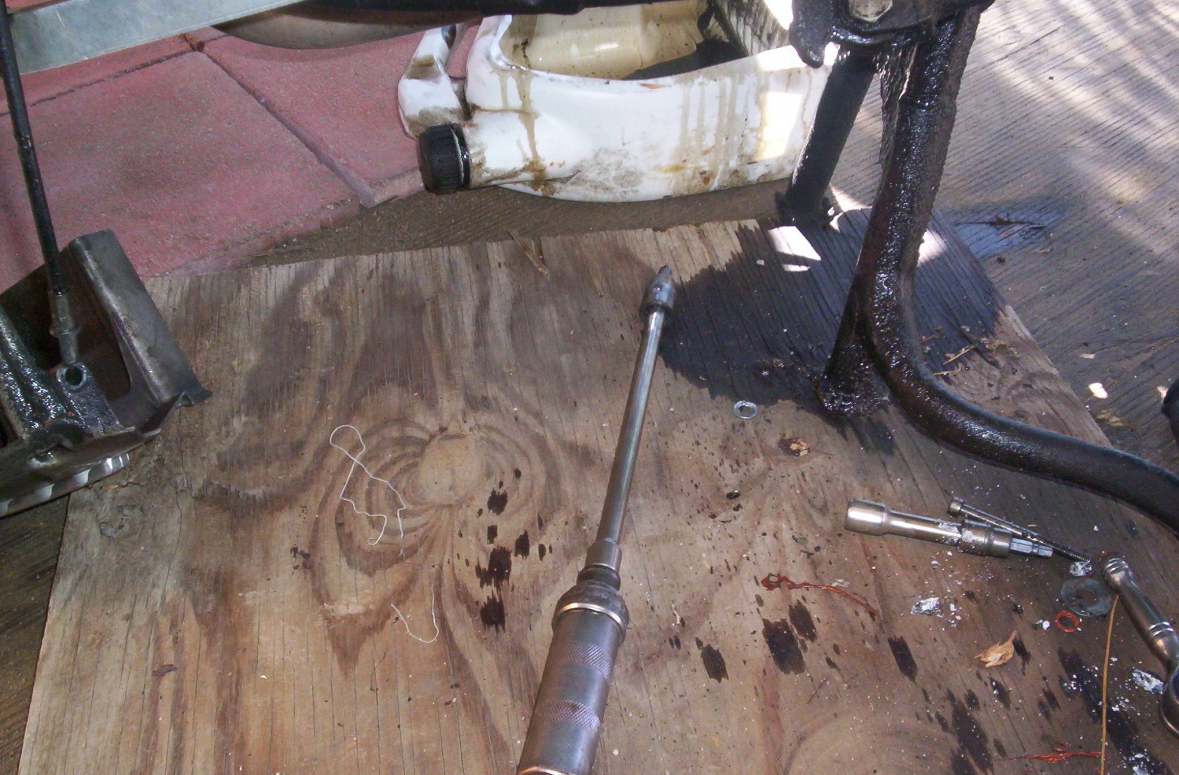

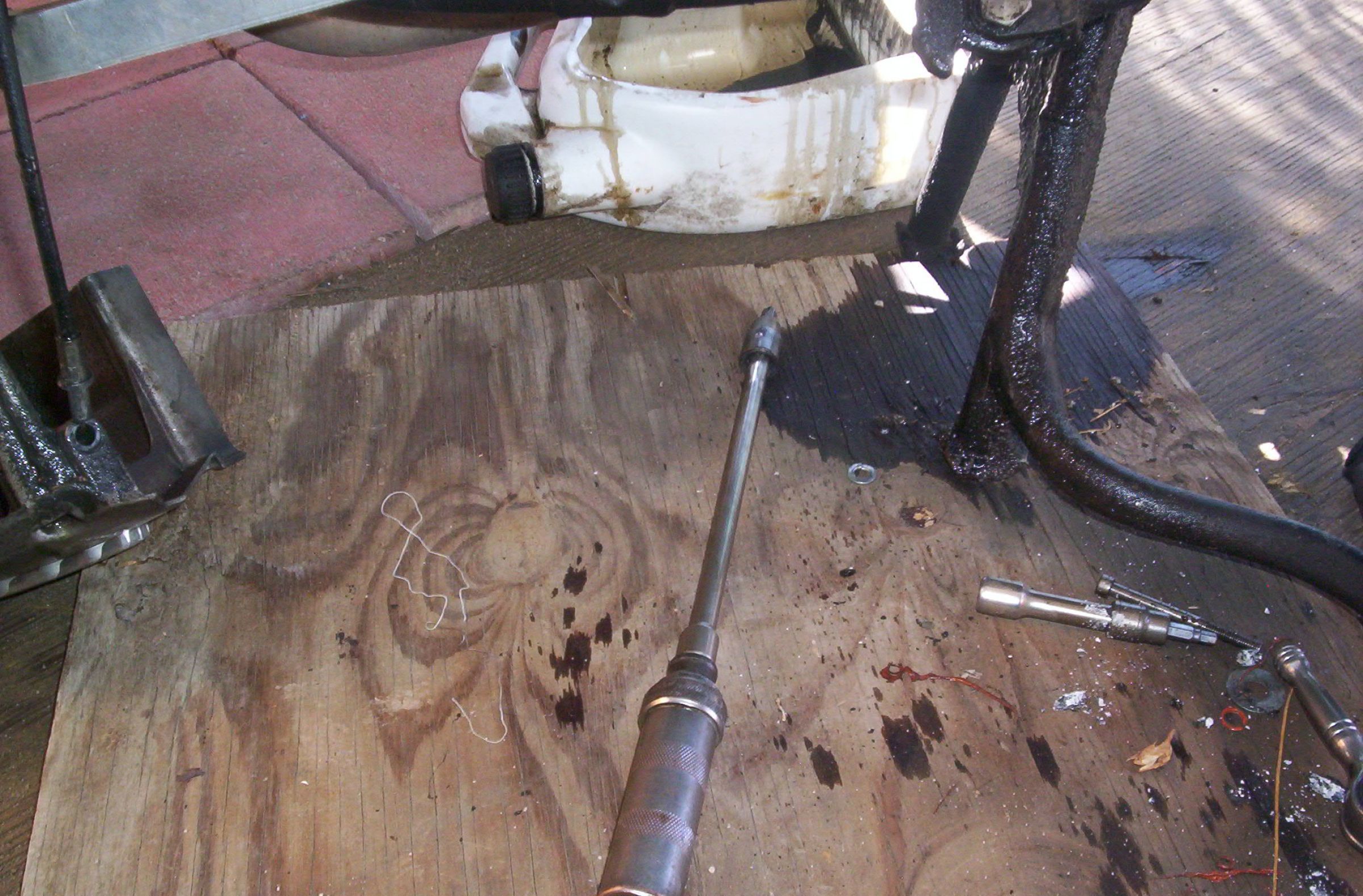

Wow! interesting time for me to receive an email on this topic as mine has just started acting up again. My '81 KZ 750 LTD has been a great bike with this one exception. Since there is no way to justify the cost of having someone else fix it I will once again do it myself. As I recall, other then a "clutch holding tool" there are no special tools required. What is required are a Clymer manual which should be studied thoroughly before you begin, plenty of time and plenty of patience. Nuts and bolts may be rusty and require a tool that you hit with a hammer to rotate them out (the name of which escapes me but it is very common) I use multiple boxes colored tape baggies and return labels to identify all parts when I I use multiple boxes, colored tape, baggies and lots of written labels to identify all parts when I reassemble. You will basically remove the exhaust pipes,oil pump and the clutch basket to get to it. Yes it is a big job and you may become frustrated with rusted items but when you are done, you hit that starter button and it starts right up you will be extremely proud of yourself and 1000% more knowledgeable about the mechanics of your bike. If you can, wait until the off-season so you are not in a hurry to get it up and running again quickly. Feel free to contact me here or by e mail: davehayward1@yahoo.com
