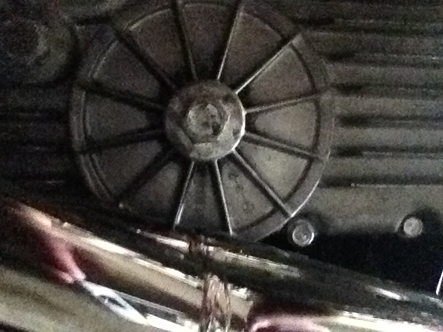

Pete, Does your V & H exhaust curve around the oil filter plate to allow easy access? I wonder if an 80' LTD is different in exhaust application than a 77' KZ?

13 Aug 2014 17:06
Vance & Hines curves around to the right of the oil filter, you just have to remove at an anglewhen it drops down close to the pipe & same with installation.
I have a Kerker on my 76 LTD 900, & it makes a sharp turn around the left of the filter, couldn't get a pic of the Kerker, too
dark in the back of garage
but here is a pic of the Vance & Hines on the 1000

Much appreciated on the picture Pete ! Kerker would of been interesting to see too. But can clearly see filter plate shouldn't be a problem to remove and certainly not drain plug. Jimmybon has a good theory about the V & H collector design. Don't know if it helps or not, but looks good? So seems with the Vance & Hines, there's a lot of good compliments on the header.

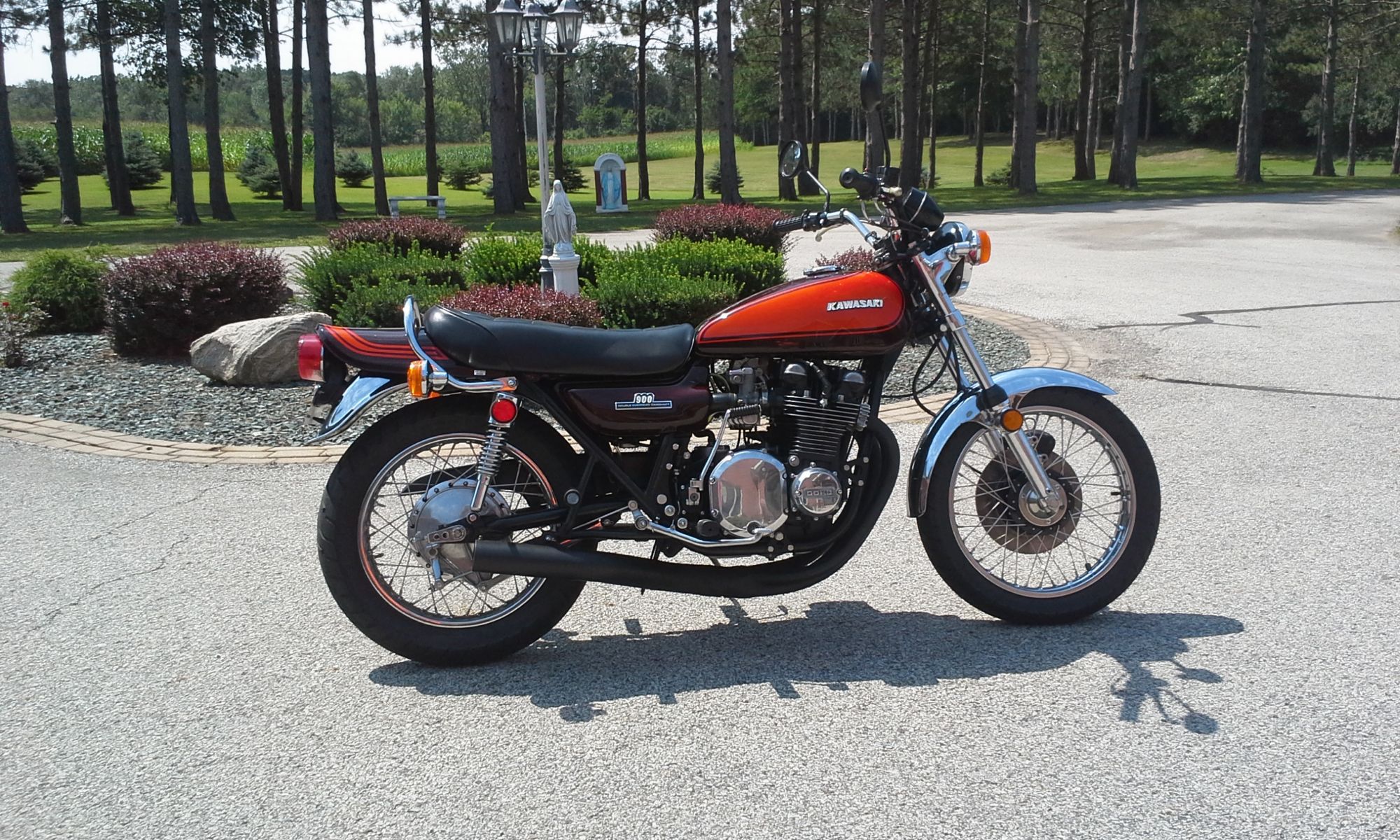

13 Aug 2014 18:39 - 13 Aug 2014 18:41Borrowed pictures from greg z,2 different sty;es of the old yosh pipe.
Anybody whos ever heard a yosh pipe without a baffle knows what mac was capable of doing back in the day.
Vance and hines made good stuff back in the day,now its just a name.
The new owners of ance and hines should stick with cake and ketchup! :woohoo:

I drain the pan with the bike on the center-stand, then down to the side-stand lean for the oil filter-cover/bolt, to keep oil off the header pipes.
You can easily change baffles with the V&H too...a real-nice option.

Definitely could see with that Yosh pipe on that 73' Z1 there would be a ground clearance issue. Not having seen a Vance & Hines pipe on a KZ in person, I couldn't say on the Fit and Finish. Just have to rely on Forum members who have the experience with them. And I greatly appreciate that from all the members who have responded to this post.
