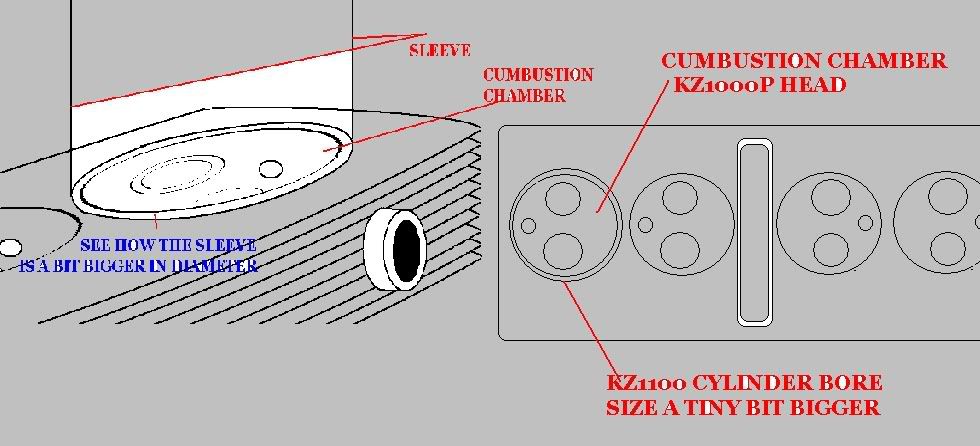

So I got the block and pistons today. Like I had Imagined the cylinder head cumbustion chamber is oviously smaller in diameter than the sleeves, so is it going to be a problem when I install the 1000 head on the 1100 block? or is ok the way it is?

lay your new head gasket on the head and scribe around it.post a picture of what youve got and we'll walk you through it;)So I got the block and pistons today. Like I had Imagined the cylinder head cumbustion chamber is oviously smaller in diameter than the sleeves, so is it going to be a problem when I install the 1000 head on the 1100 block? or is ok the way it is?<br><br>Post edited by: customkzft, at: 2007/04/26 20:17

Not a problem. Use the 1100 head gasket.
1100 sleeves will clear the crank.
Case may or may not fit. Luck of the draw AFAIK. Were it mine, if no fit, I'd split case and take advantage of the opportunity to replace all the seals and do any work toward planned future upgrades.

here is a rought drawing of what im talking about wireman, I'm at work right now so I wont be able to take any pics so this is all i could do for now

obviously a graduate of the wireman school of picture posting!:whistle: :woohoo: :silly: :woohoo: :silly: :woohoo: :silly: :woohoo: :silly: :woohoo: :silly: :pinch:here is a rough drawing of what im talking about wireman, I'm at work right now so I wont be able to take any pics so this is all i could do for now

if its just a little bit past the gasket take a file or dremel and just knock the sharp edge off the combution chamber so it doesnt become a hot spot

OK well here is the news
The 1100 head fits perfectly on the 1000 cases!
Is the head gasket supposed to be the same size as the sleeves? or a bit smaller?

the same size, you dont want it sticking out in the way.are you using a 1000 gasket or an 1100 gasket? the 1000 will be smaller for the smaller bore, but you can dremmel it to the right size. I cant see your pic tho, page not found
