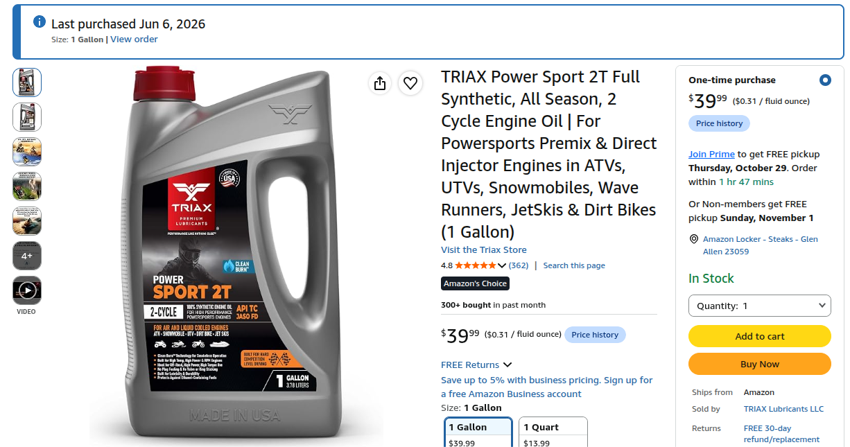

I use this in my 2-strokes. Full synthetic JASO FD rated.
