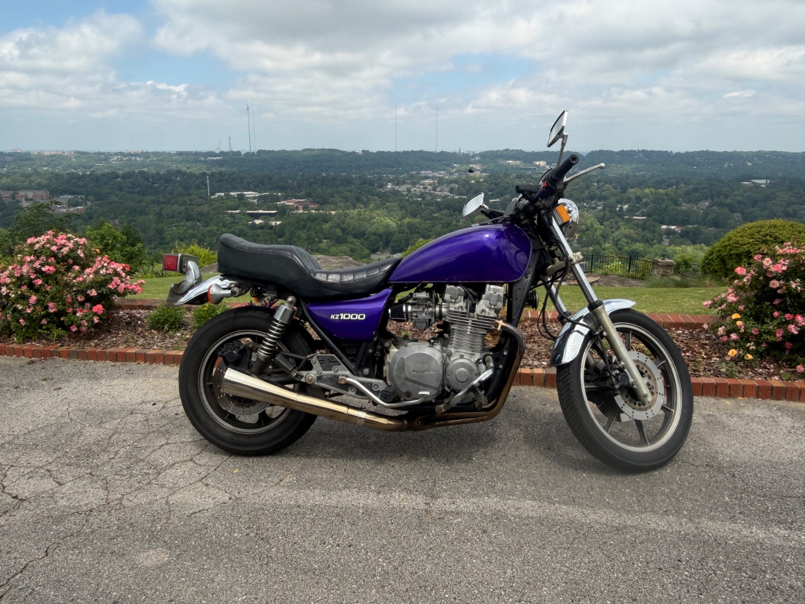

Hey guys over the past year I’ve gotten more serious about riding. Love it and want to ride everyday which is what I’ve been doing unless it’s wet out. Mostly commuting to work and just cruising around on fun solo rides. Bike runs great, but question is anyone else using theirs as a daily driver? I know the bike is tough, but I don’t want overdue it being 40+ years old. Zero issues out of the bike right now. I’m staying on top of maintenance. I work as a bicycle mechanic and have found a love for doing maintenance on this motorcycle and learning about it. I’m not concerned about adding milage on the bike or keeping the bike in amazing picture taking shape or thinking it will be worth something one day. I really just want to ride this bike like it was intended. Do you guys feel it’s fine to ride an 82 ltd everyday? Or do you think I should look into another bike for daily driving and commuting?

Bike looks good in purple:) using it shouldn’t hurt it if you stay on top of the maintenance- sitting in a barn for 20 years does them no good at all

It's all about maintenance, and the condition in general. The things people rarely do, like lubing wheel bearings, swingarm bearings, steering head bearings, clutch release mechanism, and lubricating cables. Also, keep up on valve adjustments, which some people neglect. I could go on, but you should get the idea.
Your pipes look heavily colored, and I see china pods. I'd get some real K&N's, and make sure the jetting is proper, and not lean, cooking the pipe and engine. Fine details matter as you rack up the miles.

I hear ya and I’ve since taken those cheap pods off. They were on there when I got the bike a year ago. Replace with UNI pods last month. Thoughts on those? Anyone use them? Yeah pipes are nasty and trying clean the blued seems to make it look worse so just letting it be unless someone knows what to clean them with that works? Doesn’t bother me too much if it’s cosmetic, but how do I know if it’s running lean other than hot pipes? Been trying to figure out if I should change jets or not from day 1 a year ago when I got the bike in “good running order” which it was. What are other signs the bike is running lean? I don’t have back firing, idle is steady and drops right back down when I rev it. No hanging rpms. Never dips then goes back up to idle. Pipes hot yes. Starts right up every single time easily too. What else are signs it is lean? Bc runs good otherwise.

Guy had the pods on there when I got the bike and I’m not sure if he changed the jets or not when he installed the pods. What I haven’t done is synced the carbs. Would that cause over heating? Cleaned them of course.

Spark plug color can tell you about mix....synchronizing carbs have to do with smooth idle mostly,....does not affect much at higher RPM.,,,but just the same I'd check that too.
Pitty does not have factory air box and exhaust, .......in general ' extra power' you get out of that is actually pitiful, not worth bastardizing bike from factory, and making it nosier...but if you say is running fine, it should OK by now I suppose.
