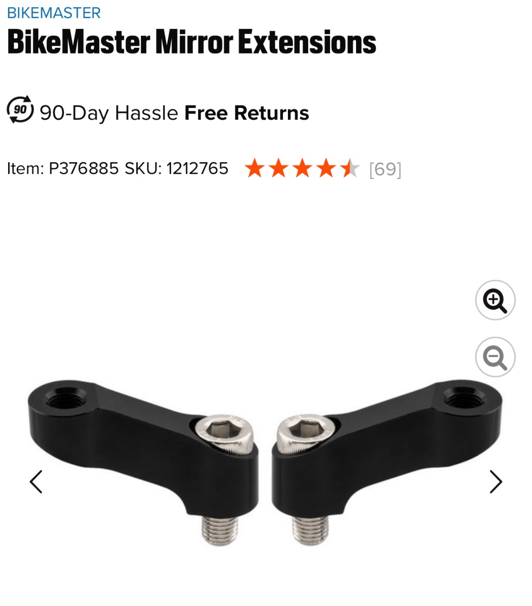

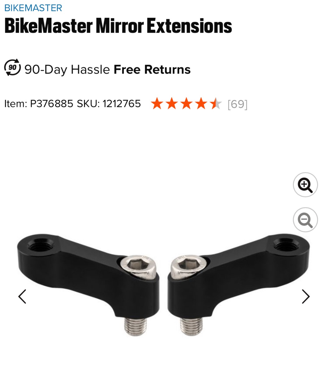

Re: Mirrors that stick out further and still look good
20 Aug 2025 06:47
You may want to look at “mirror extenders”. They basically offset the mirror base out. Fairly inexpensive and still keep the stock mirrors. No idea on how the harmonics are affected like Asphalt mentioned.
