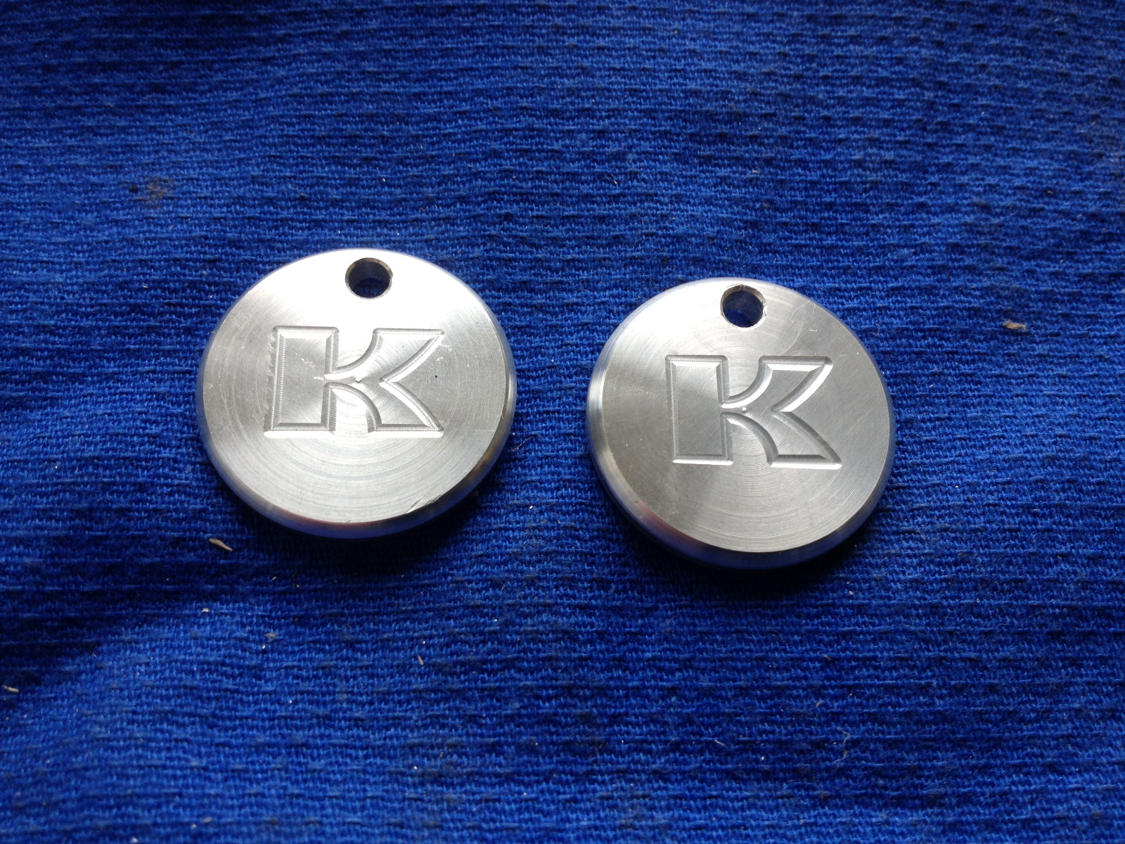

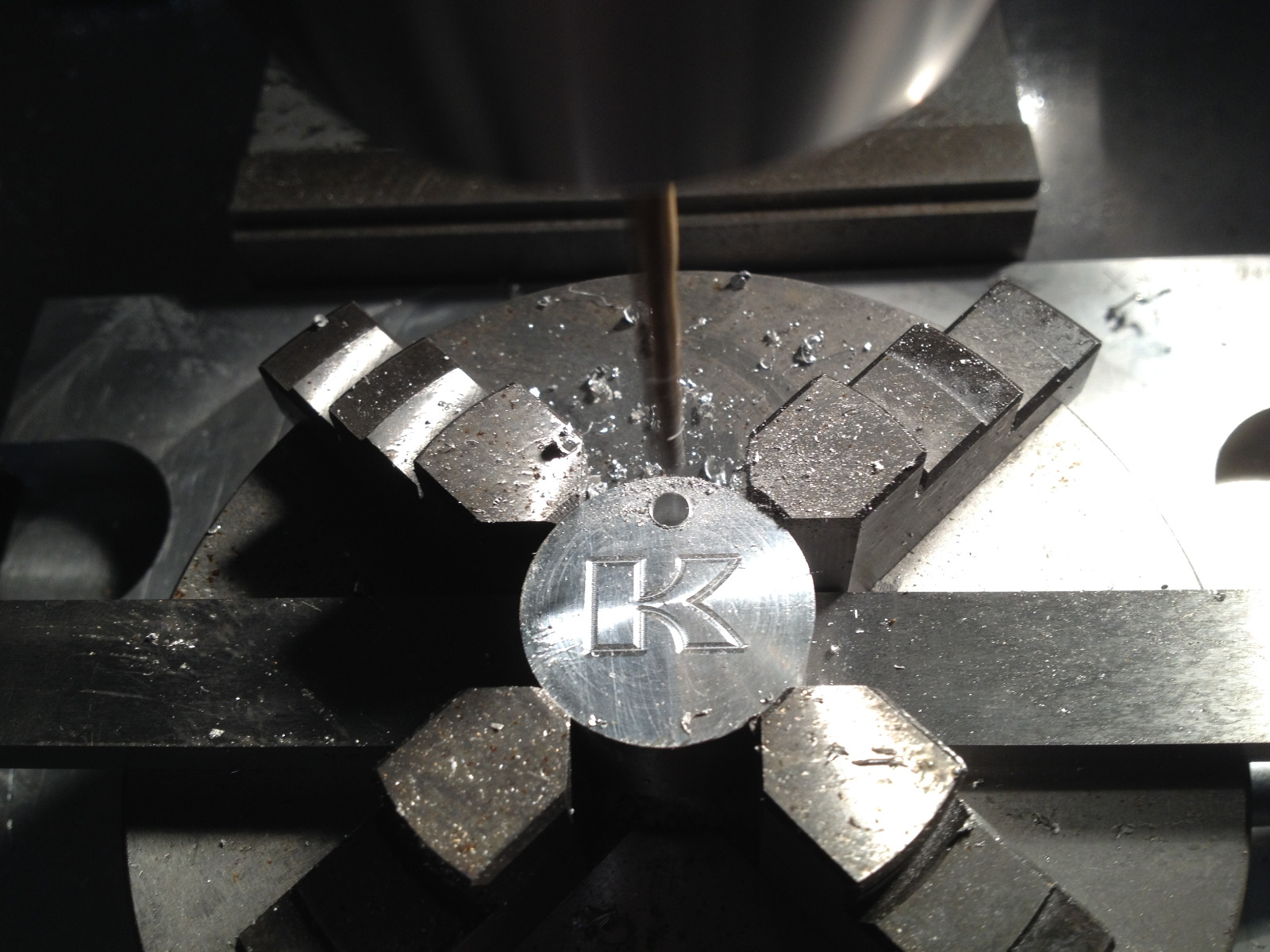

Yesterday I looked for a suitable key chain, but couldn't find anything suitable. So today I made one myself. (Sure, it didn't turn out to be the perfect "K", but being old-fashioned as I am, with an old CNC milling machine, I'm unfortunately not able to program free trajectories...But it´s OK for me, and it havn´t fly to the moon
The machine itself is 37 years old and still works very well and precisely, but it is not a modern CNC and I do not use CAD/CAM for it (or rather, I am not capable of it, the machine is not plug and play, I have to program all data sets in X, Y and Z directly into the machine).

11 Mar 2025 13:35Yesterday I looked for a suitable key chain, but couldn't find anything suitable. So today I made one myself. (Sure, it didn't turn out to be the perfect "K", but being old-fashioned as I am, with an old CNC milling machine, I'm unfortunately not able to program free trajectories...But it´s OK for me, and it havn´t fly to the moon
Your "old" cnc is still a step up from mine.
I have next to no chance of doing that "K" with my manual Harrison.

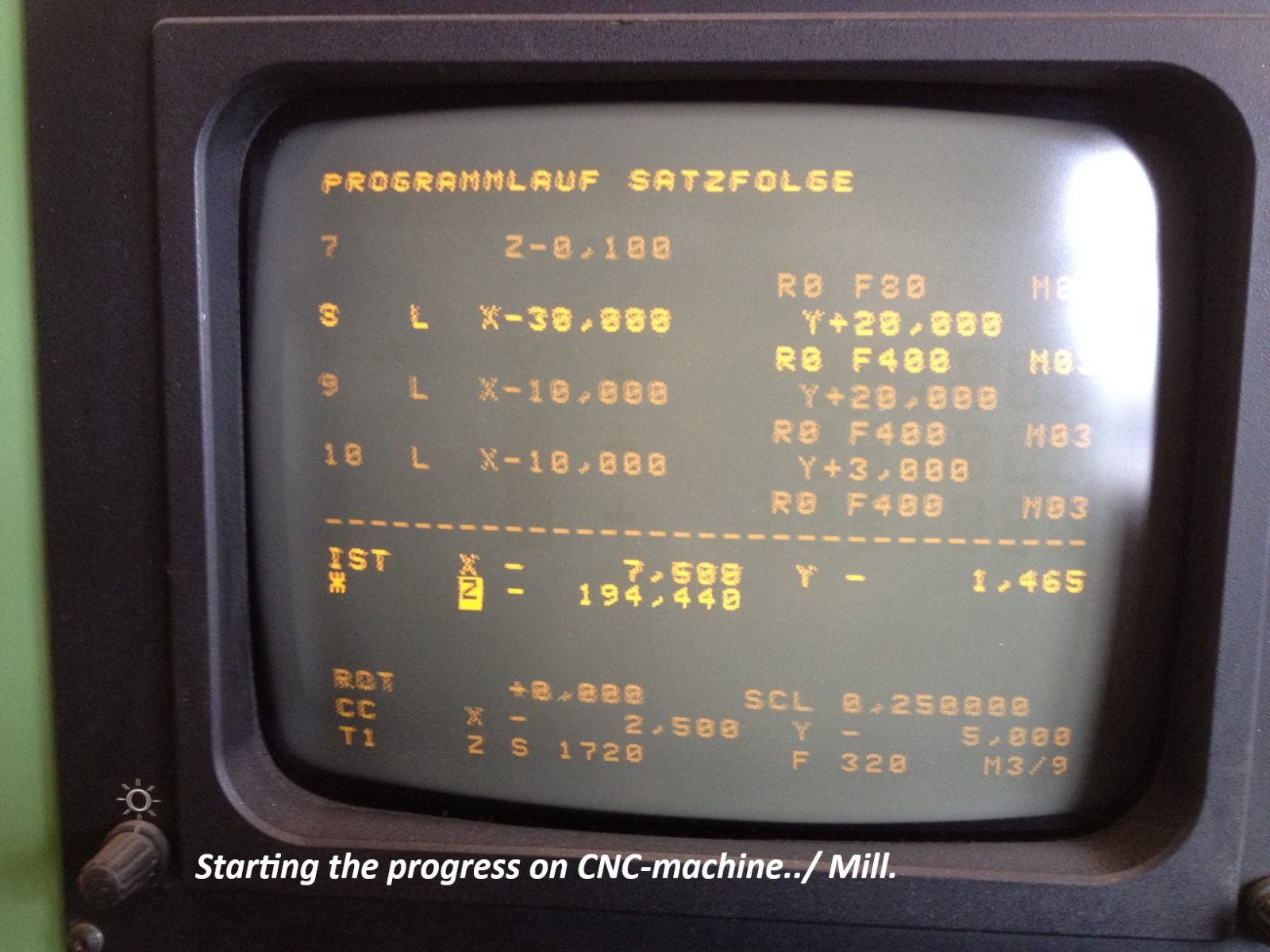

@zed1015Yes, Robert, it's possible to engrave a "K" with your machine: If you have a dividing head! (Of course, the workload is immense, but in my case, the radii on the "K" are all graduated circles of an exact diameter, NOT expanding trajectories!
Unlike modern CAD/CAM systems, my planning begins with a drawing on graph paper. Then I calculate the necessary coordinates, paths, and trajectories, and program the machine directly on the screen.

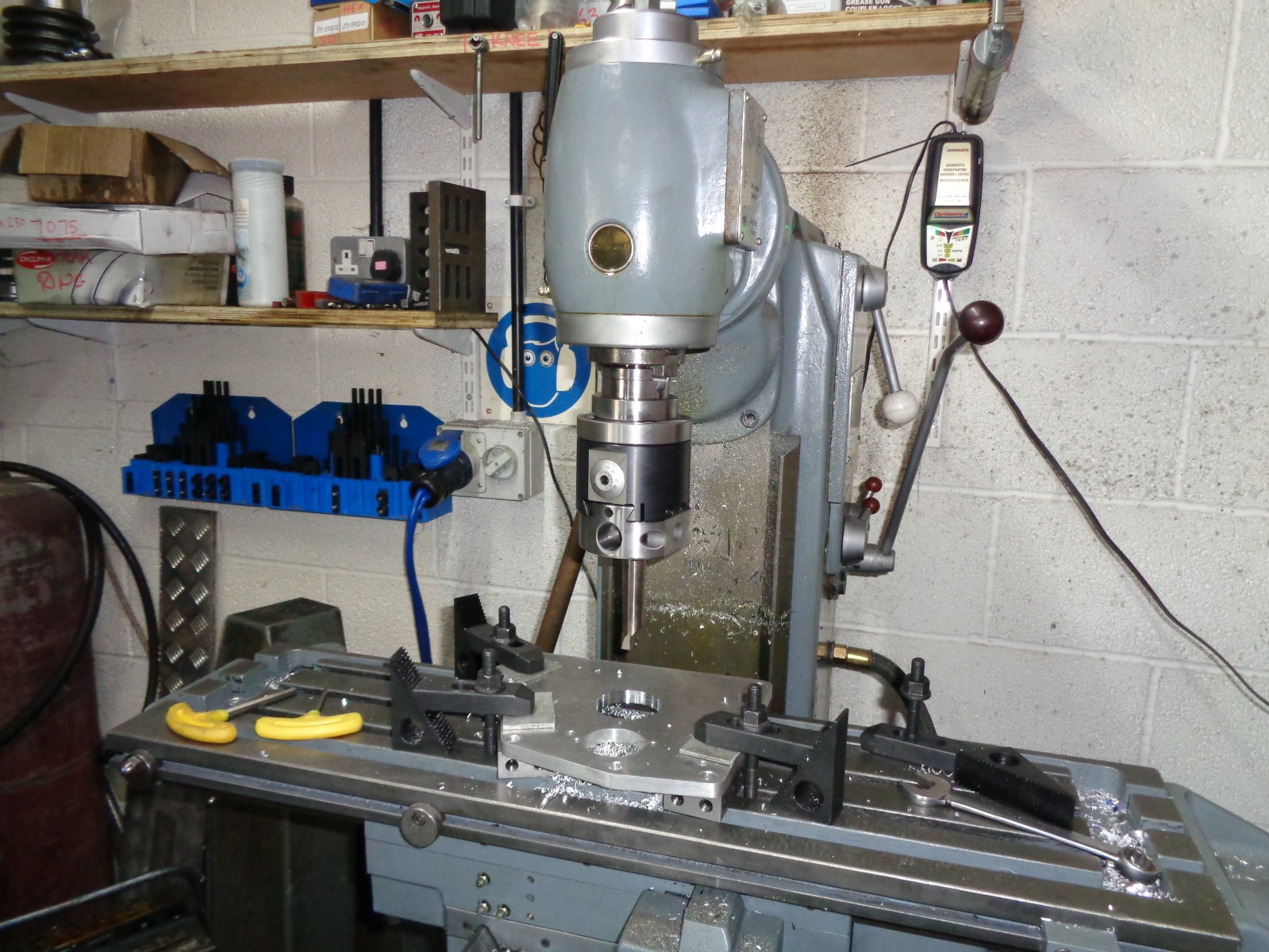

I run an Bridgeport interact 412,..it´s in fact a 2,5 D CNC mill,..with dialog-programming only direkt on the machine,..( Heidenhain 151), sure, more possibilities as on a just mechanical mill,..but not really 21. century

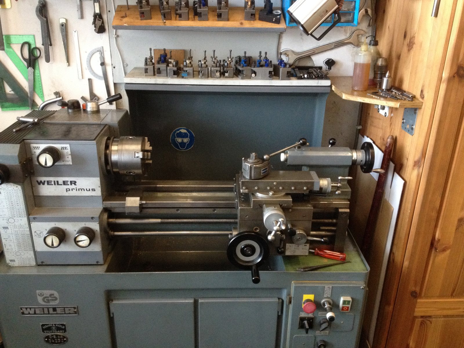

My lathe is a Weiler "Primus", fine little thing, but also limited in wideness to clamp-diameters: 125 mm max.

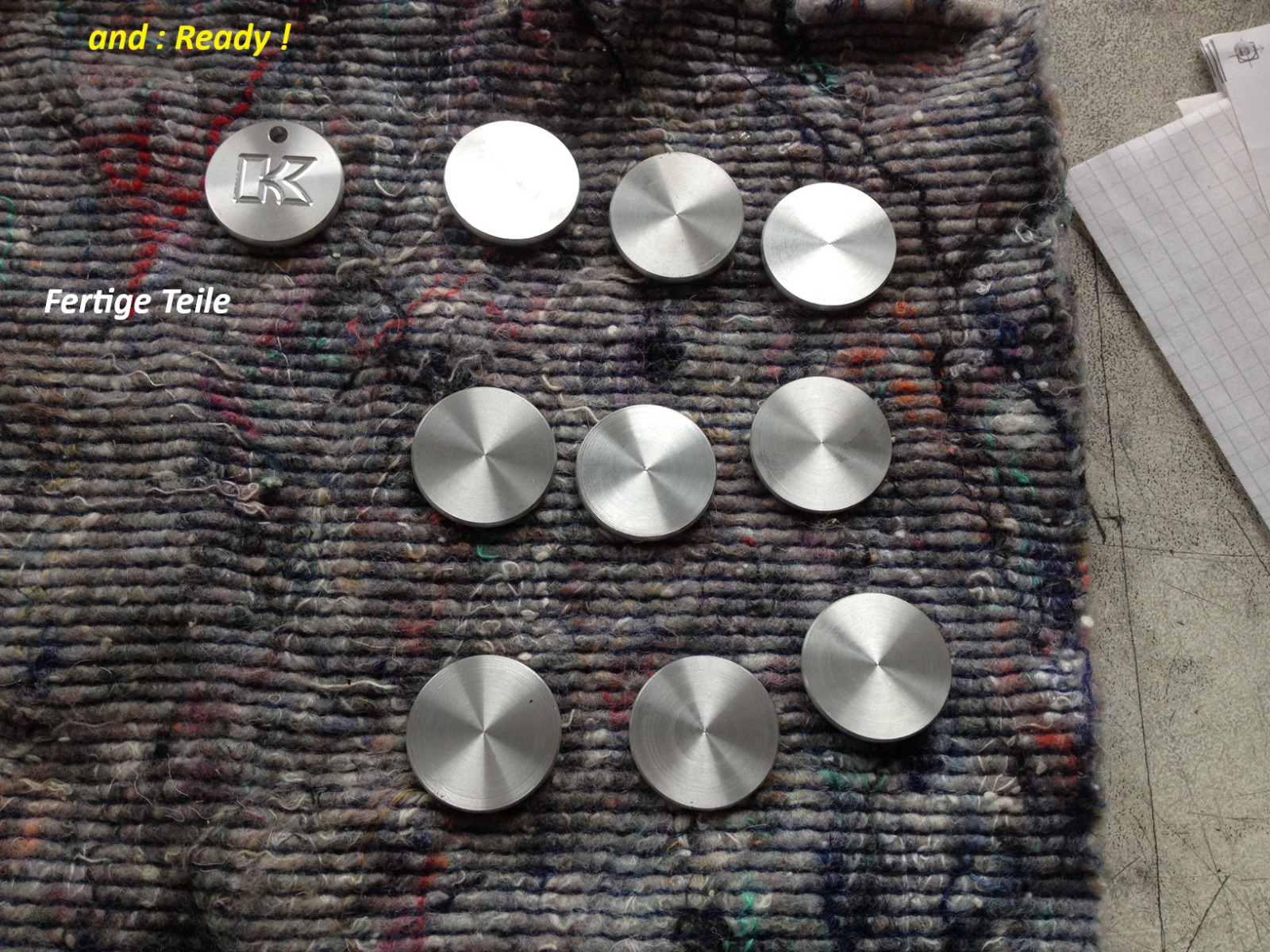

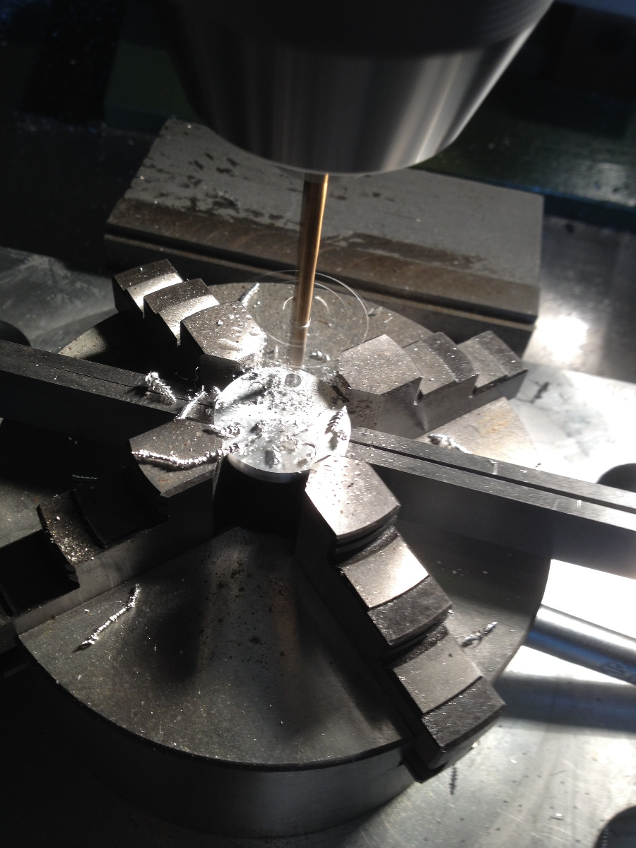

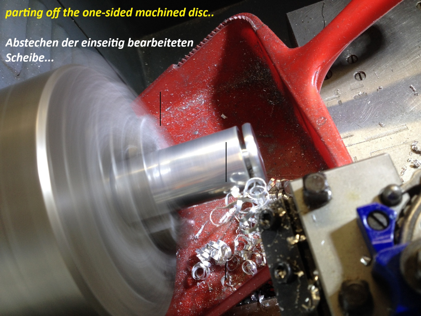

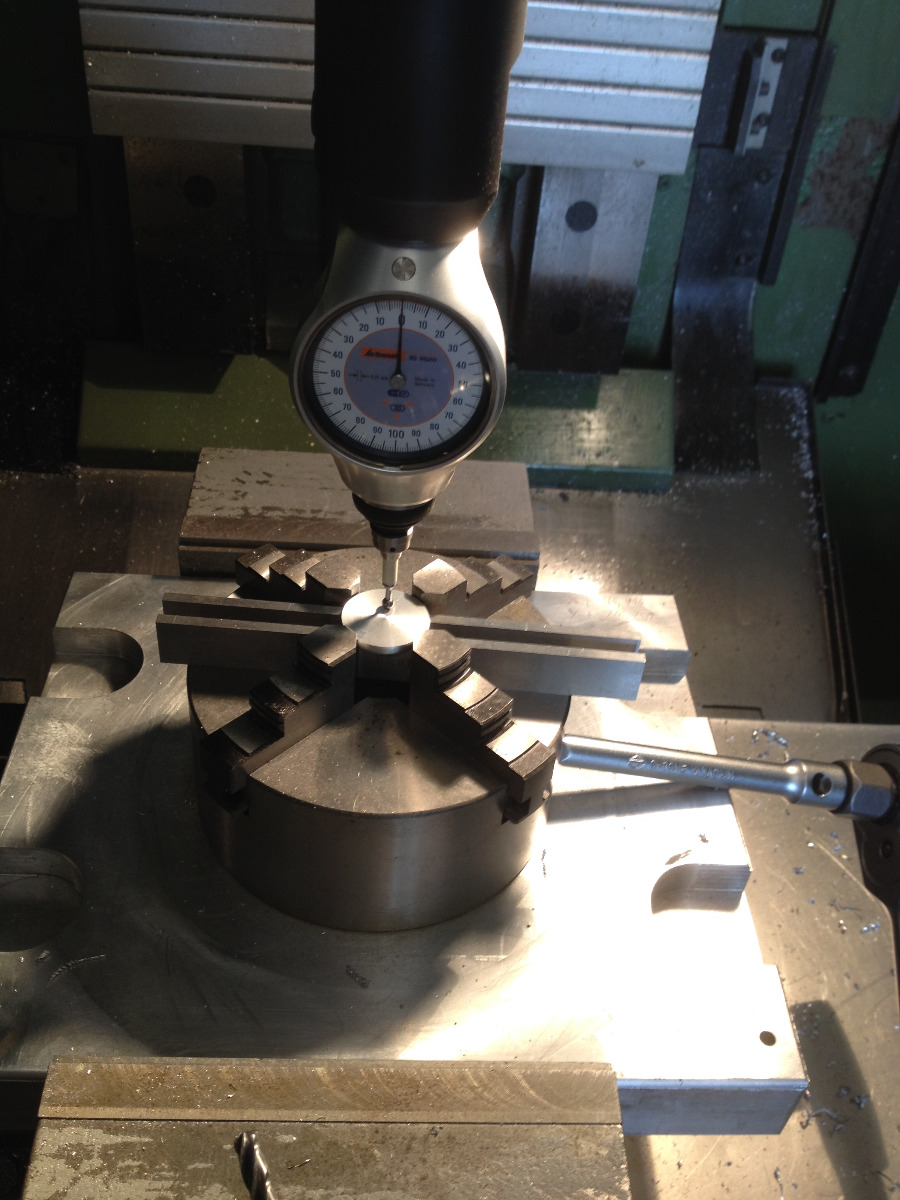

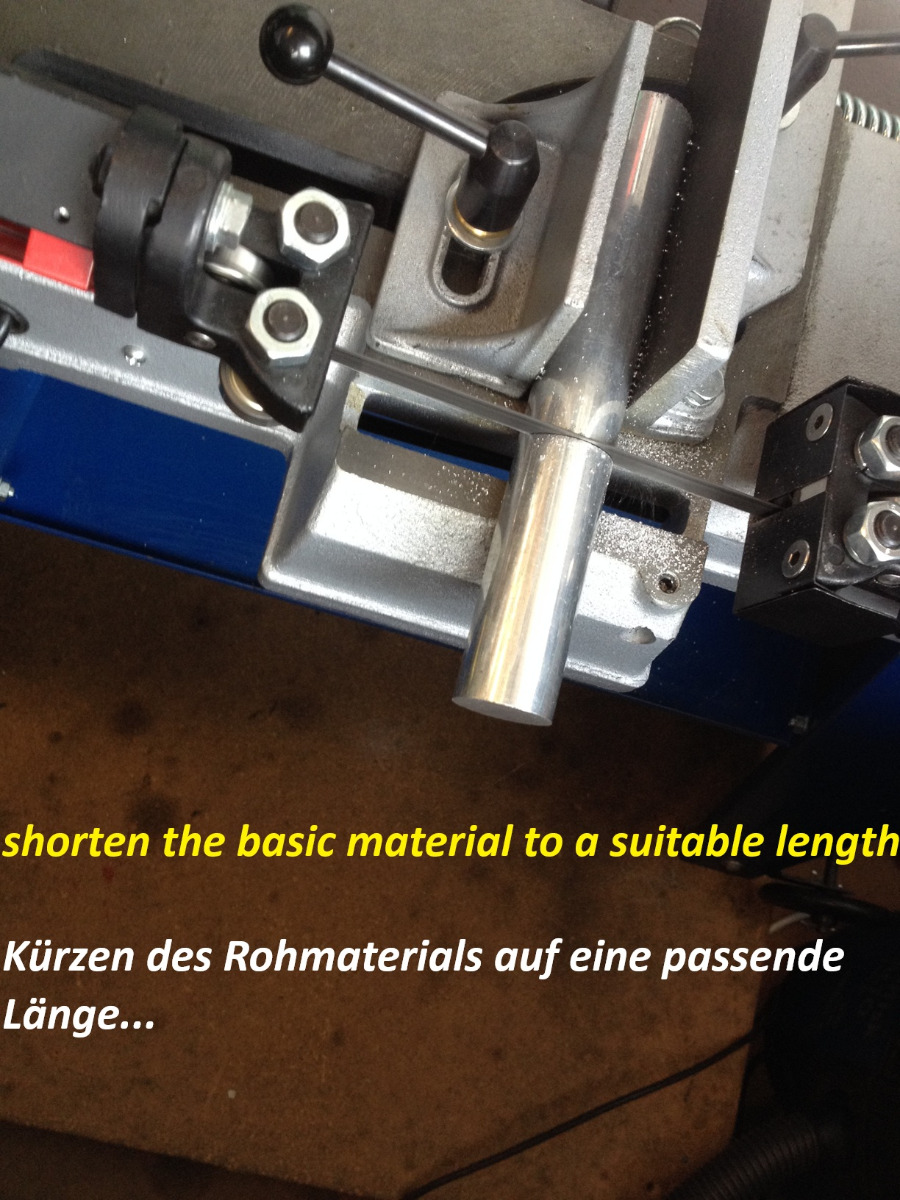

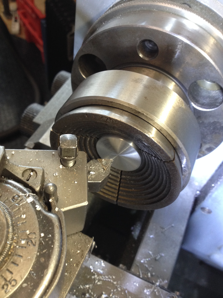

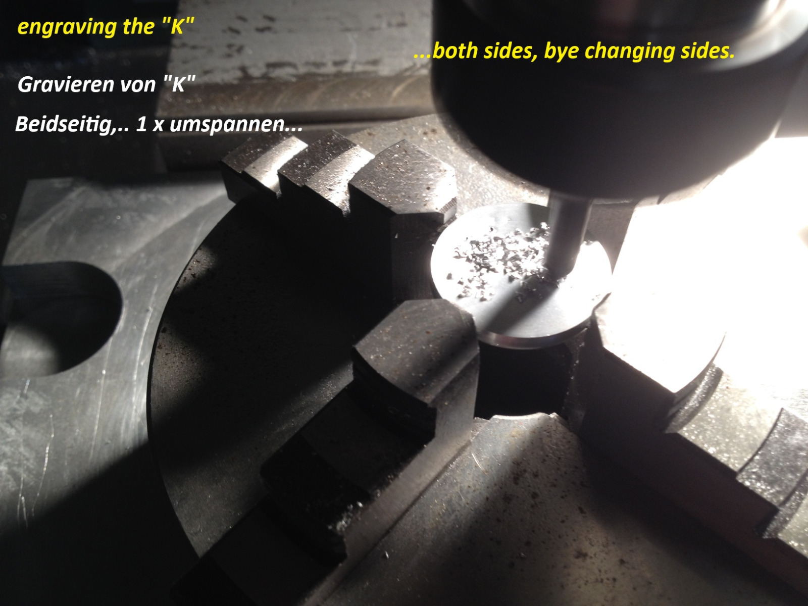

Today i´ve done a limited unit of the hanger-discs a little more professional:
Here I will simple guide you through the process of making the ring discs...3 machines are involved to made the whole progress:
First a bandsaw, ( not realy necessary
Second the lathe
Third the CNC milling center.
Second the lathe
