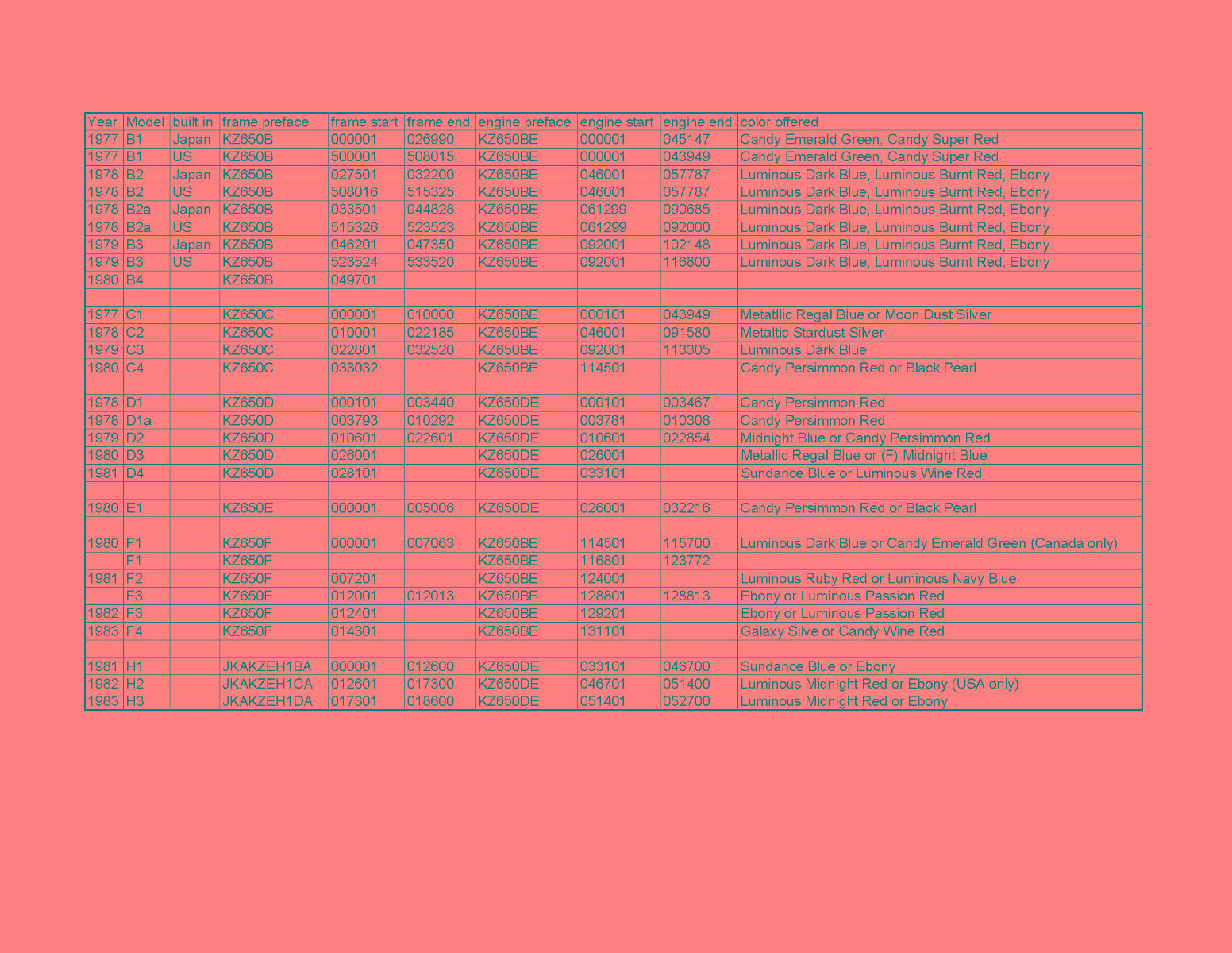

I do not currently have a frame or engine number I want info on, but am interested in learning more about your data set. In the past I created a table of frame and engine numbers for the (K)Z650s from info I could find and make some sense of. Never claimed it was/is correct. You say you can provide info on machines other than the Z1s. Do you have info on the 650s? Again not a single machine info but the start and end numbers for them?
I have attached said table, what can you tell me about and if anywhere near correct?

Hi! Thanks for taking the time to ask the question and even bigger thanks for making the effort to make the database!
The Z650 has never been in any serious focus for me, I am just cleaning up the database to answer your question
What has struck me instantly (and these numbers have been on my database for 20 Years) is that the Nebraska bikes appear to have been Imported into the U.K.! I never realised that!
This is going to have to be a work in progress for a few days
