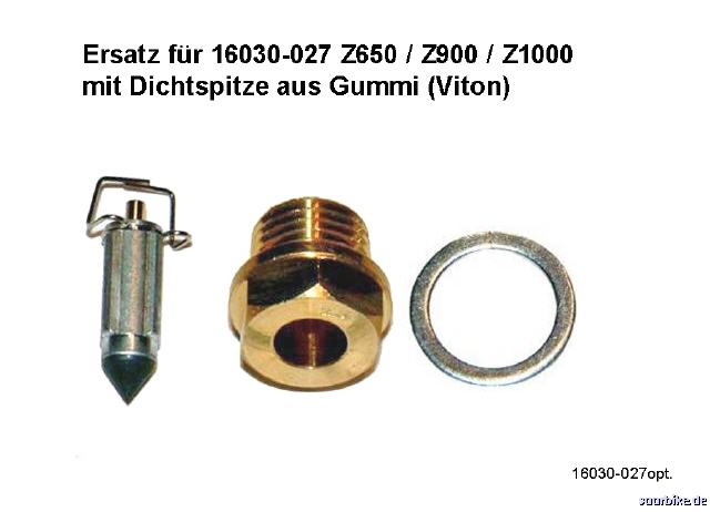

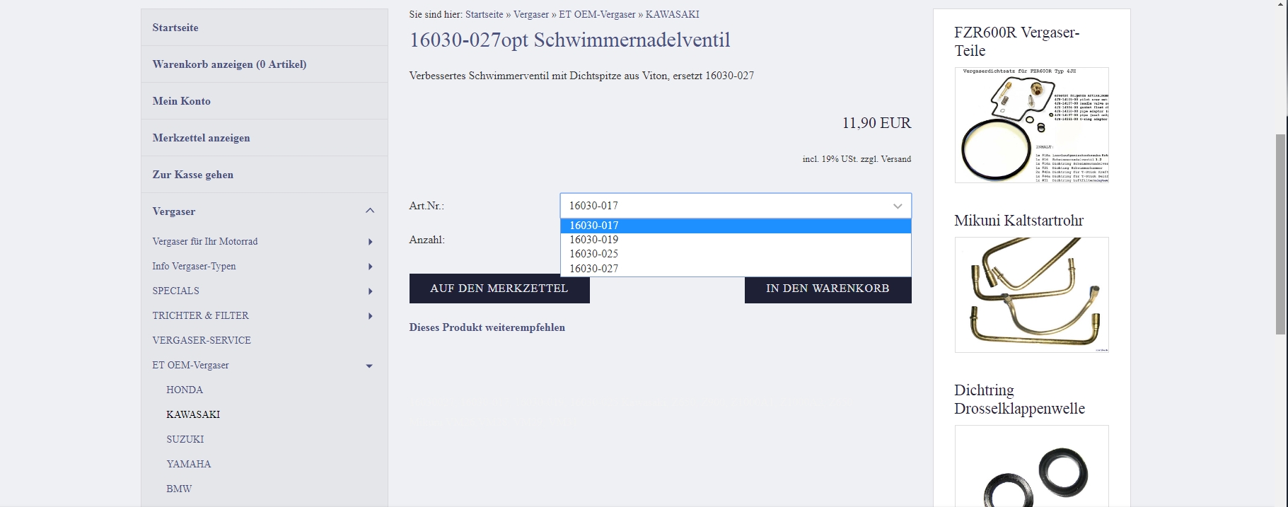

This shop sells needle valves sets with a viton rubber tip.
vergaser.saarbike.de/vergaser/et-oem-ver...r/kawasaki/index.php
