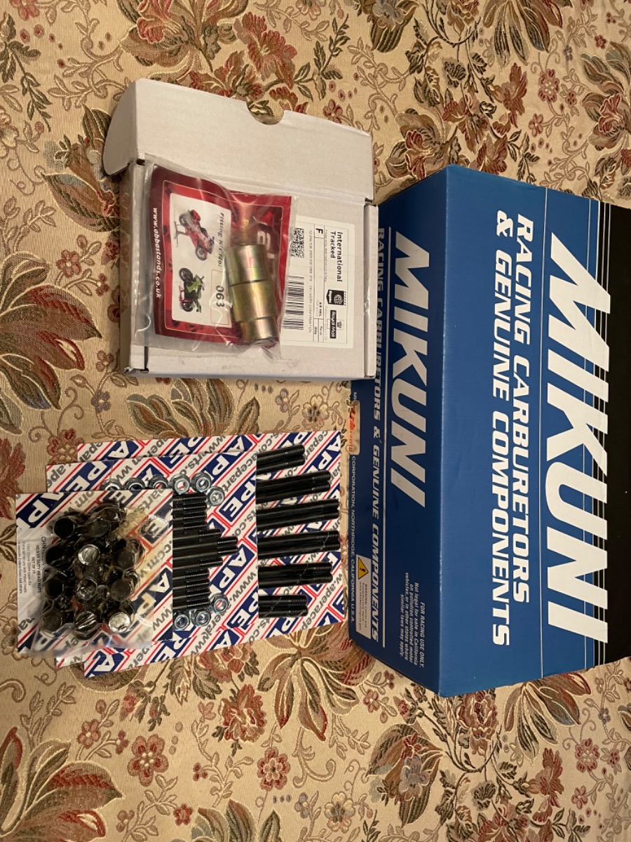

Welp, my KZ has lived disassembled in the back of my gayraj far too long, so I am finally gathering what I need to get it back on the road. I will start a proper build thread soon, but wanted to begin with this thread, as I will have some preliminary questions. I have been accumulating some parts along the way, and here are the most recent arrivals.

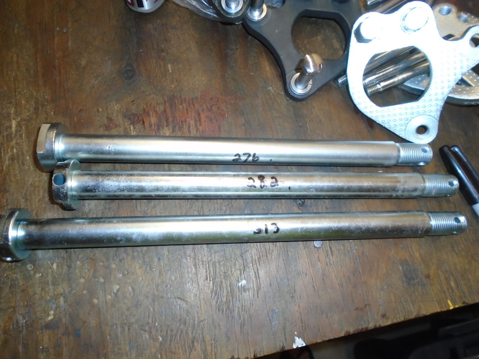

You would be amazed at selection of Kawasaki, solid of course not hollow, axles out there. I've got three that from memory are shorter than the KZ1000 already plated. Thinking they came from various triples but all correct diameter to match the bearings/brake plate/sprocket collar and adjusters. Establish Your length, are you in the states?

20 Apr 2024 18:14I need 20mm, same as stock KZ, but it needs to be longer. From the bottom of the head to the beginning of the threads should be about 310mm. The stock KZ axle measures about 267 and the GPz looks to be about 330 or so.What diameter is it you require, the 600 bandit axle I am using is hollow and much smaller than a GSXR
