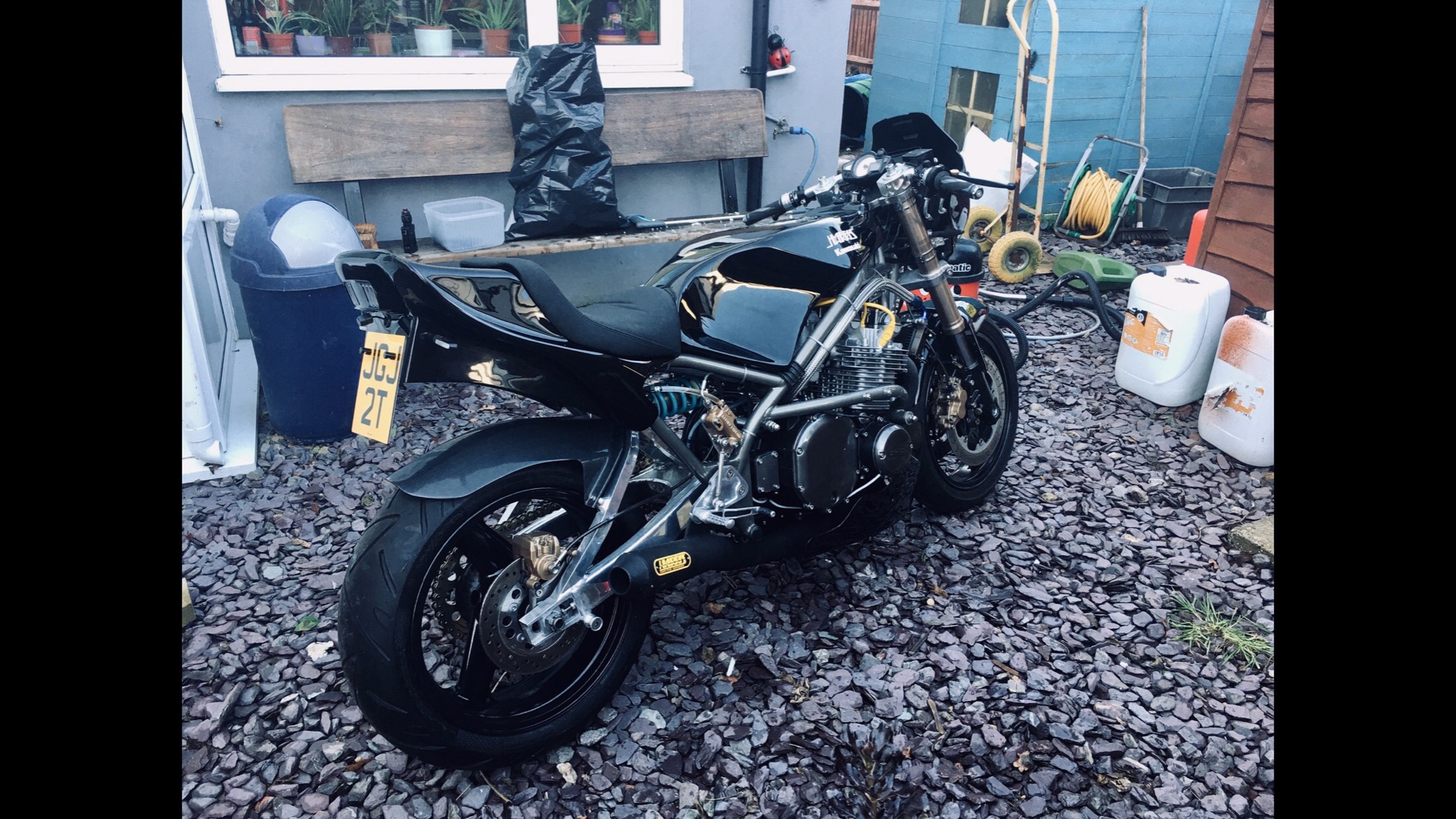

Hi can anyone help with a problem I have with my 1976 z1 900. Got the usual stuff done to it Wiseco 1015 cams big valves mikuni 29mm smoothbores what’s happening is it starts first go it ticks over fine the plugs are a good colour it’s when riding if you’re moving at a steady speed 40 50 60 it runs a bit rough and you get spiting from the carbs but as soon as you open it up it flys should I be looking at the Carbs all the timing

Hi thanks for your reply
bike is only done 250 miles since rebuild so the valve clearances should be okay The problem is only When throttle is partly open so I’m guessing it’s the pilot circuit the air screws are only turned out between 1/4 and 3/4.carbs 2and 3 are open the most as the tank smothers them a bit . As for the timing am using dyna s and dyna coils with the timing on full advance thanks
ps I’ve only just got back on the road after 23 years
