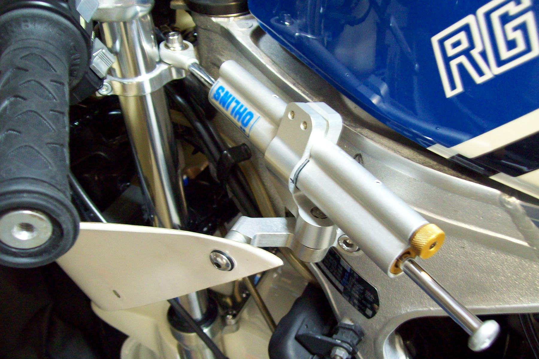

If you ride your bike hard enough through corners or over pavement that has some ripples or bumps it will shake the bars or worse start going into some form of a wobble. It just depends on how hard you push it. I myself won't ride any motorcycle without a steering damper. I have had some scary high speed wobbles on and off the road race track!! And not just on Kawasaki motorcycles. A steering damper doesn't eliminate wobbles, it just makes them controllable.

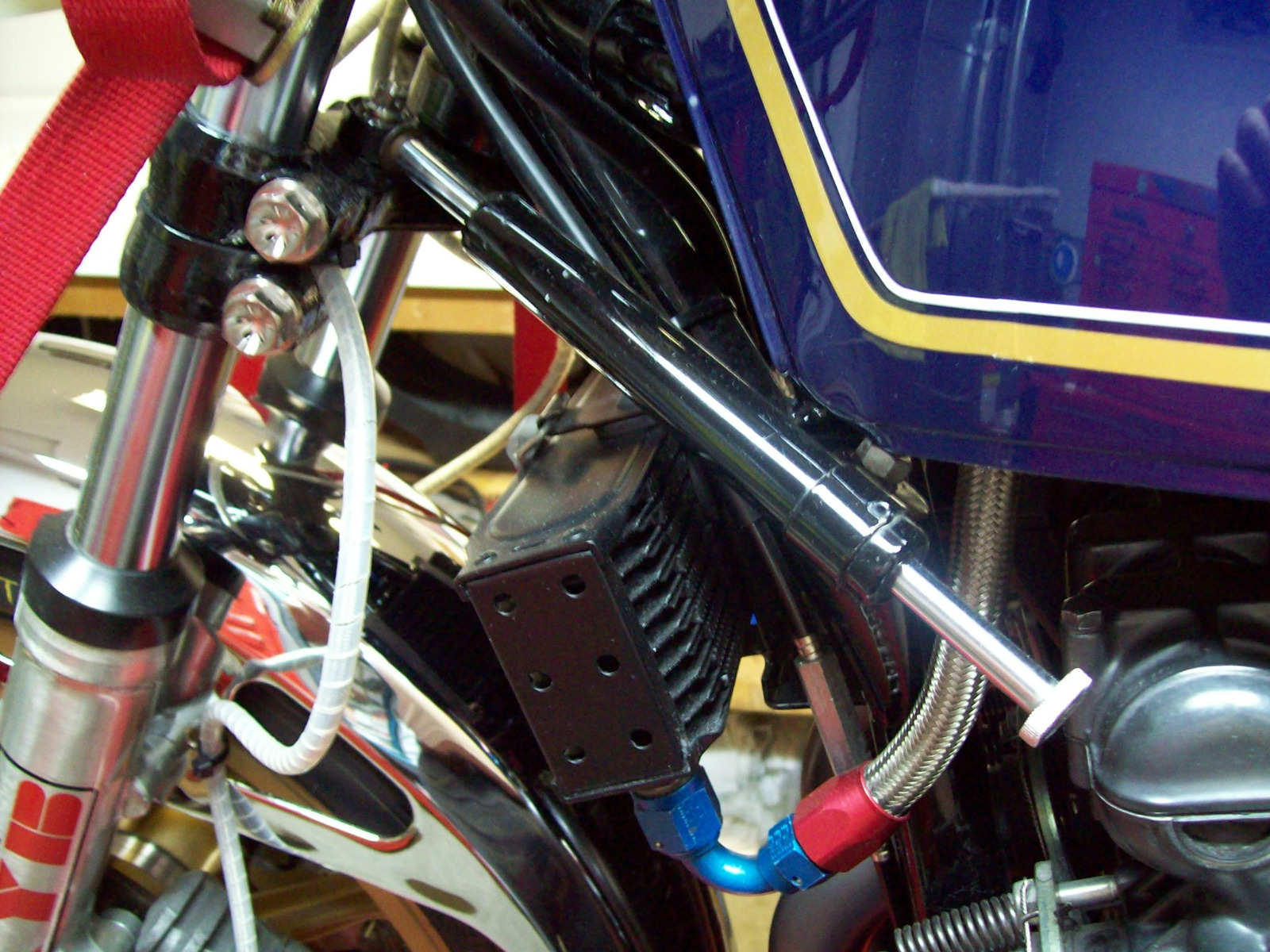

I'm with Dr. Gamma on Steering Dampners
But I have pushed my bike way past normal limits racing
I learned with my 750 H2 what a Death Wooble is............. Not Fun Had to accelerate further to break loose of it
Tapered steering neck bearings make a huge difference
All our frames can flex if pushed to hard. 95 percent of riders don't push to that threshold
So , Be carefull and keep your bike maintained tight and enjoy

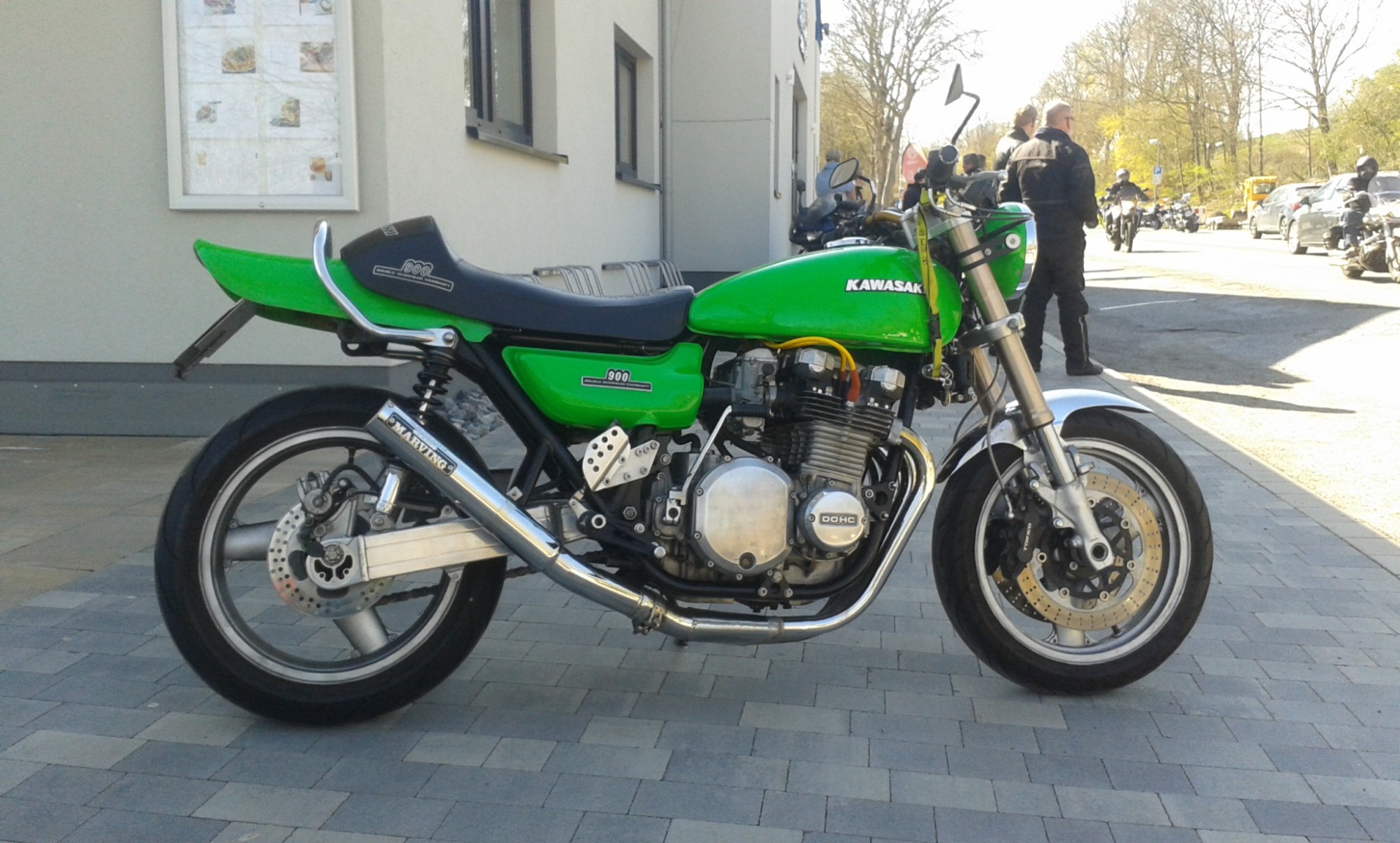

Re: Safe speed in a Kz.
04 Jun 2023 15:10

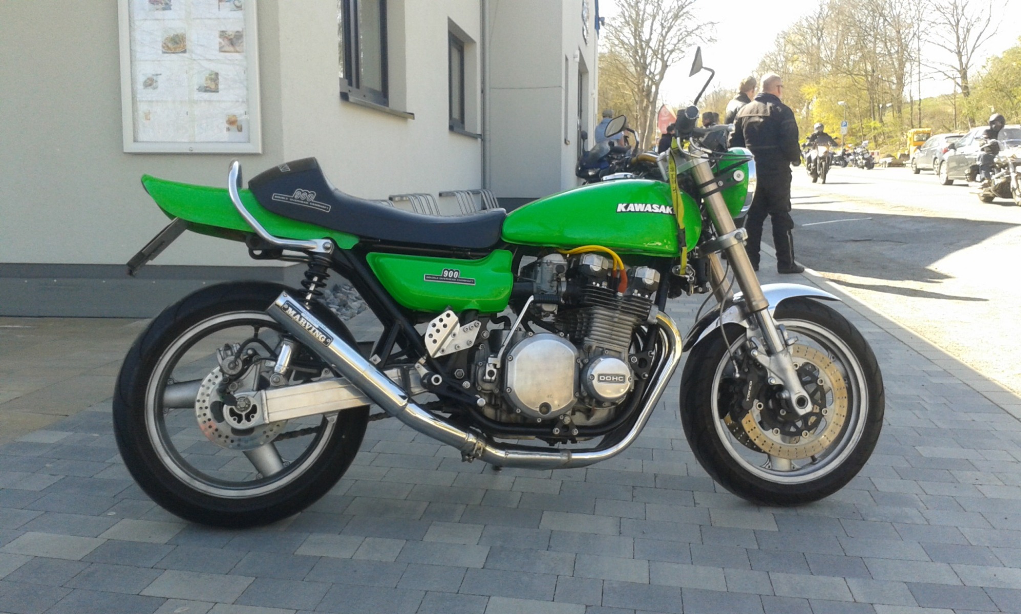

To upgrade the cronering performance and high speed stability, i did upgade to a beefier swing arm/wheel combo in the late 90th.
Than:
and now five years ago:
Than:
The following user(s) said Thank You: MLMG
