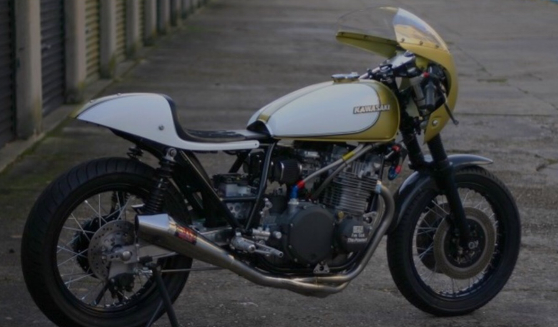

The planning is for a few projects I have in inventory not listed in my sig. The words “race replicas” keeps coming back to me and the AMA Superbike series would be the Grail. Anything I have that competed in the series would be considered and I just happen to have picked up a 74 R90S which, as I’m sure you’ll remember, Reg Pridmore ran in the first year for the win. It’s a stretch because it’s really just a frame and a block and had been sitting in a yard down in CT for who knows how long.
Year 2 saw Reg do it again albeit on a 76 KZ900 but the Racecrafters entry interests me not and nor does the Yoshimura tribute bike a video of which is on the tube if you wanna see it. I saw a replica of this bike down in MA by a guy named Rob but he goes by Harry. It was sweet but I really like this un by these guys. And I’ve since gathered a bunch of stuff for it. The frame has been blasted, painted and sports a proper period correct front end.
rocket-garage.blogspot.com/2008/05/bol-d...-z900-fat-racer.html
Others include my GPZ and the GS750ES. The GS had been race wired for track use so it has some pedigree. It became the “ride of choice this past summer because, well, I don’t know why really, it just was but the RS, now that it’s getting chilly is going to take over I’m sure.

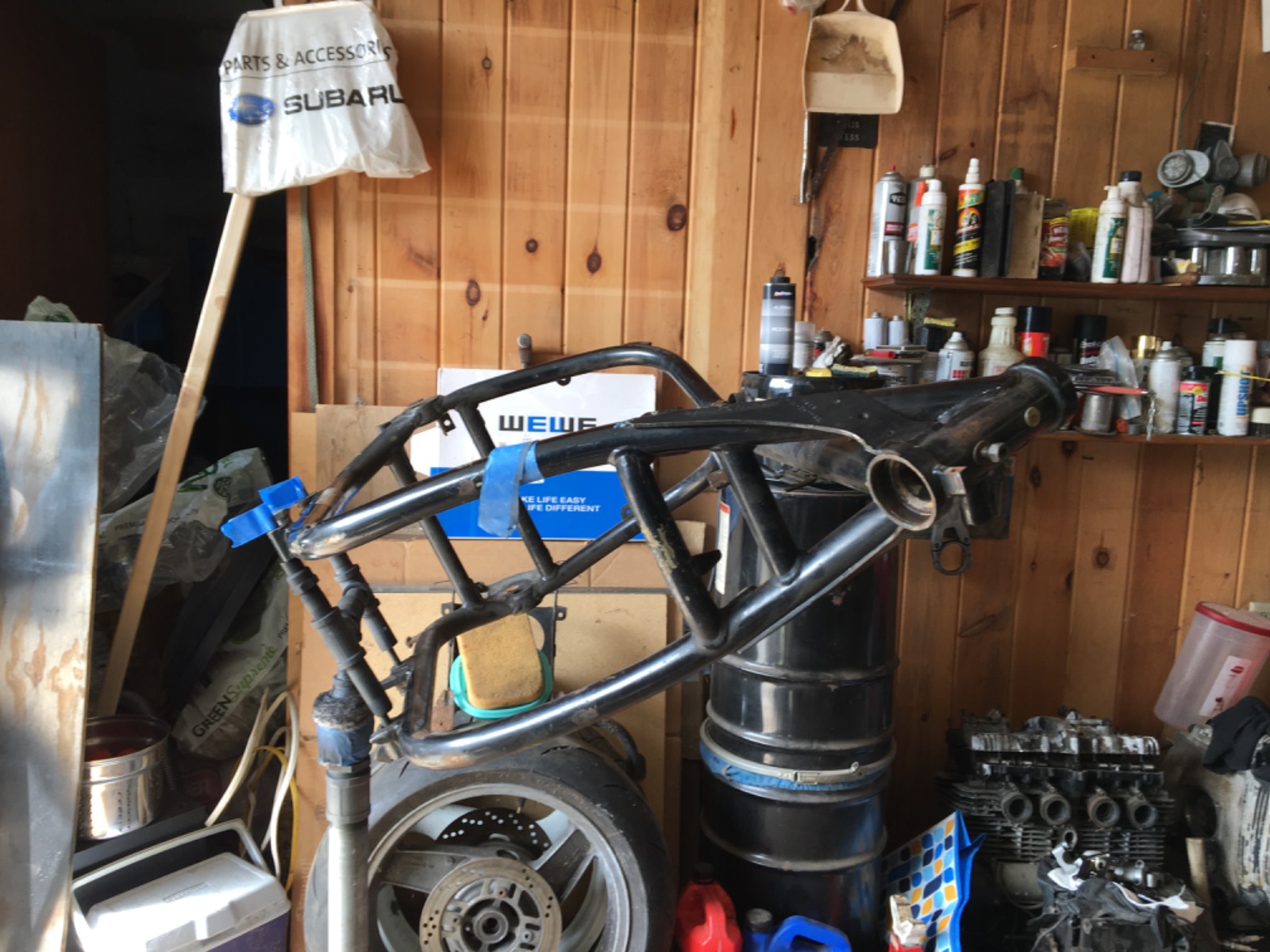

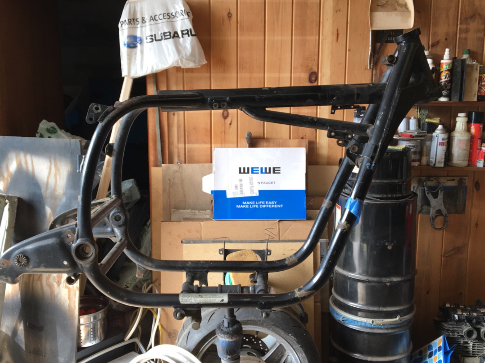

I made a jig out of pipe fittings I had around the shop and some pipe I was able to thread and attach to a rolling platform. I’ve a few frames to do so it made sense and works well. My compressor is gas powered by Honda and never needs to recoup pressure. Damn rig could cut off a limb it could. Love it.
I’ve opted to use lacquer instead of the alternatives because bikes of this era used it and if I need more durable then a urethane clear 2K would work but then I’d sacrifice the unlimited recoat ability or spot touch up. It dries so fast too and is not as hazardous to MY health. Keyword being “my”. I’ve got 3 done now and the 76 frame is blasted but needs primer and paint. I’ll post pics of a painted matte frame when I can.
I call my shop “Primordial” because it’s pretty oozie right now. I folded up my construction tent but still need to do stuff for my ex and relatives. My version of the “Theory of Relativity” varies substantially from Einstein’s. I’ll figure it out and get it all organized. It’s better than it was and soon enuf outdoor activities will ebb and I’ll be stuck inside with my projects. First time I’ve ever looked somewhat forward to winter.

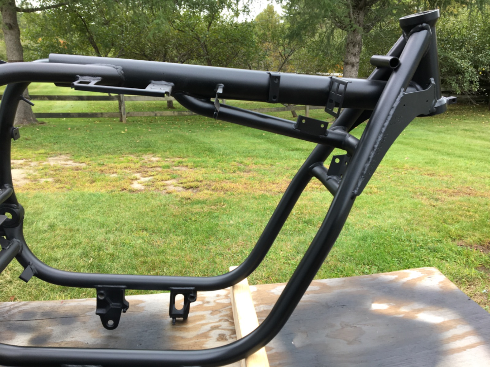

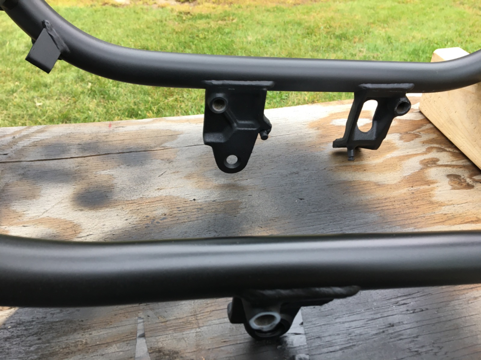

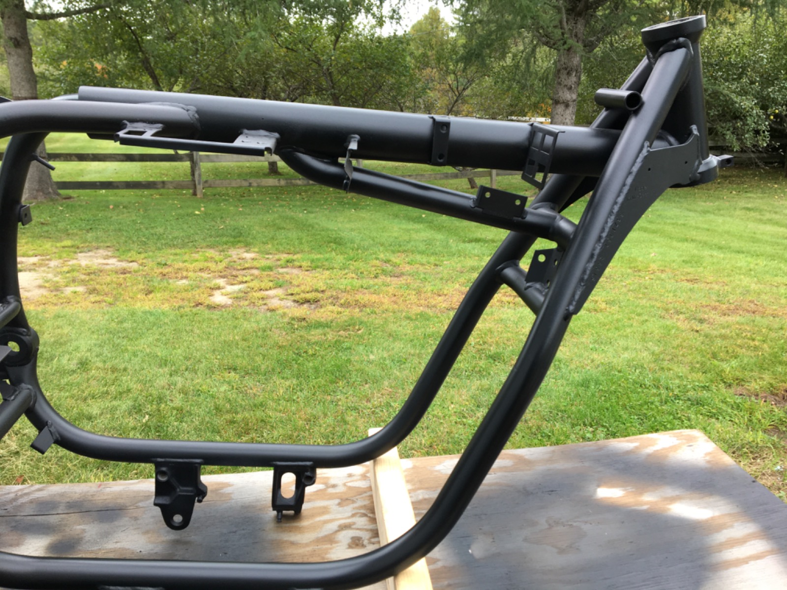

These are those painted frame pics. An 82 R65LS, another forlorn and forgotten motorcycle part out if ever I’ve seen one. And I’ve seen some recently, bought some of them too. It’s not the R90 type of forlorn. That was parted out to within a hairs breath of its life and I’m gonna show y’all what was in the block with those rusty after I do this.
Wait, what was I doing anyway…oh yeah, those pics.
You know, I did a rethink on not topcoating urethane 2K and then took a rag with some lacquer thinner on it and checked 3 things, 2 KZ frames, one, a 76 and the other an 82 and it took off paint. Gas and brake fluid are harsh. I then re-wet the rag and took it too my RS fairing and it din du nuffin to it. Just thinking, er, typing out loud here. I’ll figure it out. Wrongly perhaps but then it becomes hard earned doesnt it? Love hard earned.
The plan for this one? Nah, best save that for another time. Nah, I’ll spill it now. I ain’t like that. An 800cc kit and bigger carbs. Make it a straight black R80RS fairing and livery. Solo seat. No pinstripes, doesn’t need
That short stroke crank with 10.25 compressioned 800cc and some del orto carbs and these hills will be alive with the sound music alright.
But moreover, the frame jig articulates so I can blast and paint all areas without handling the frame which is key in reducing mishaps and extra handling. Obviously not the case here but this is just show and tell. I’ve no doubt I’ll arrive at a repeatable line to get as quick as possible to the next point in a frame up race. The drive.

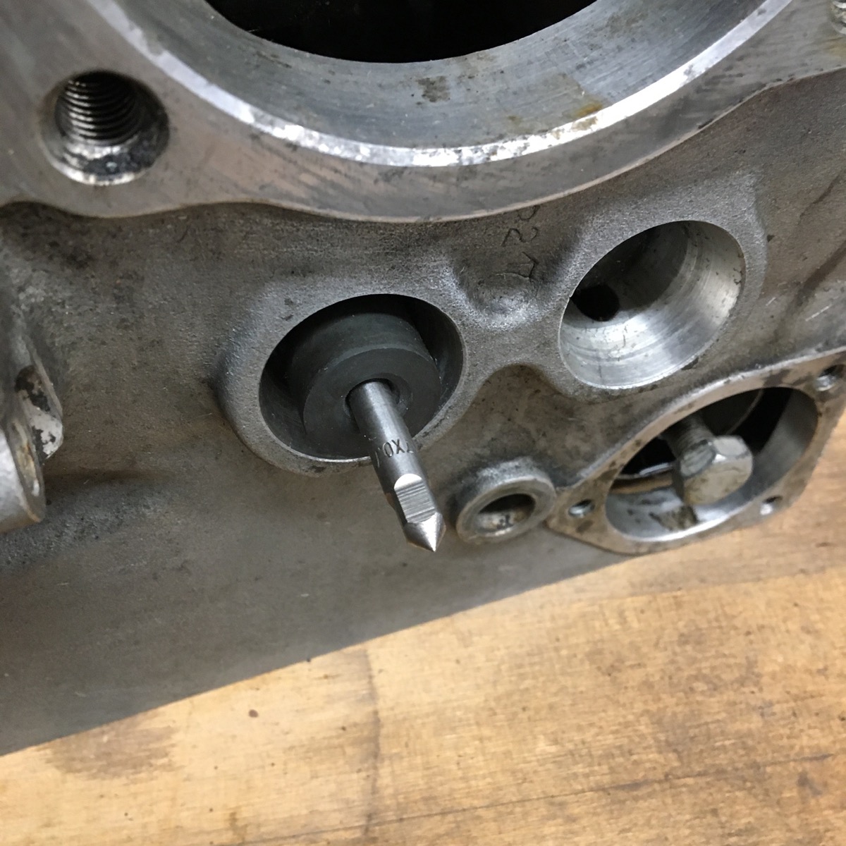

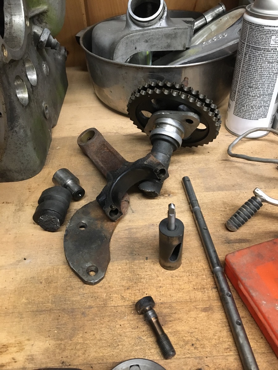

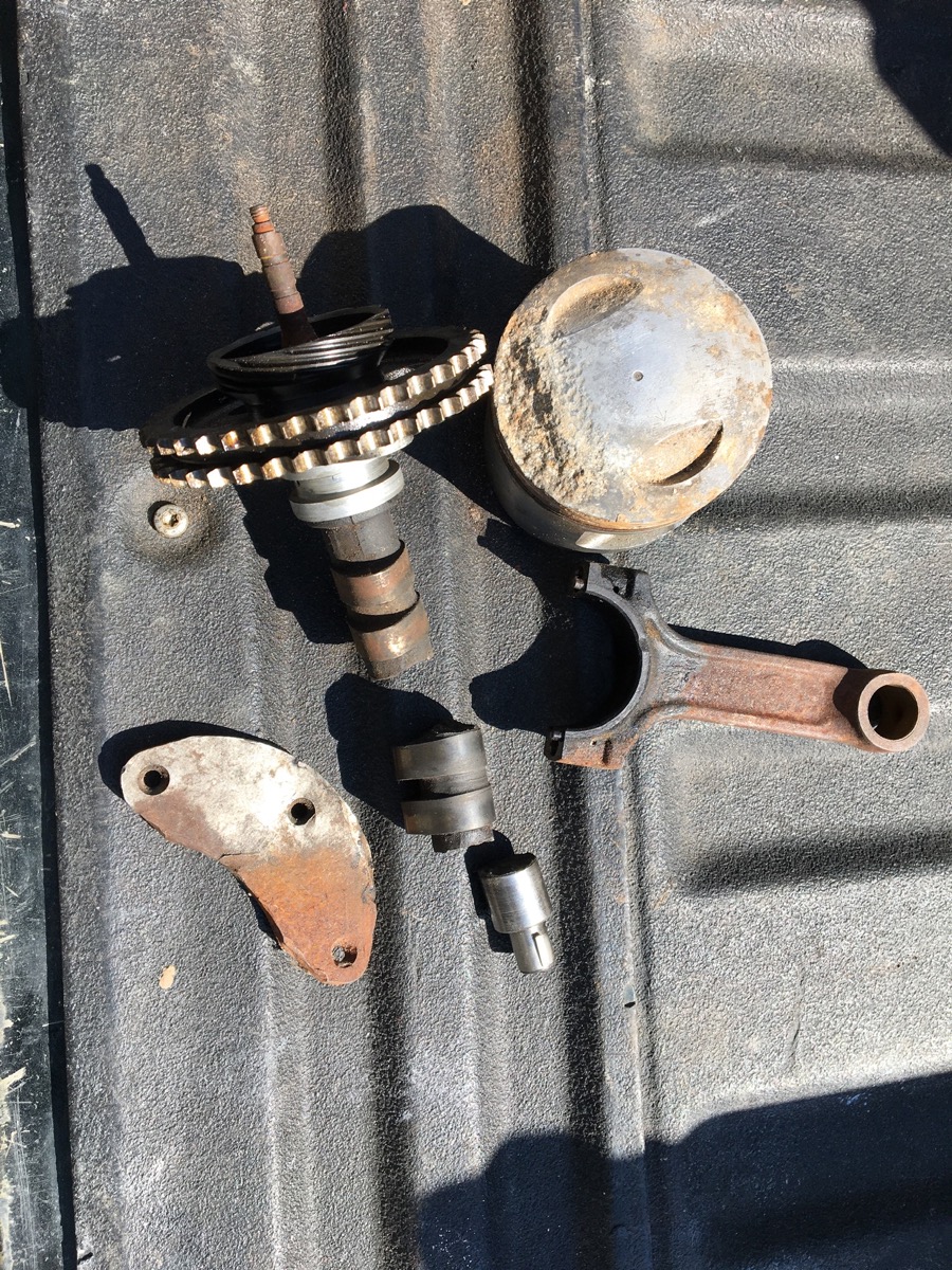

Before we start on the drive train…what the heck is with that copper color crap they line frying pans with now anyway? Is that a “stick” coating as opposed to non. Sheezus!
Quick Quiz, (didn’t you love those?)
How big a racket did this engine make and how long did it make it?
How concerned was the rider when it happened?
in your own words of course.
the cam follower I made into a hone because when that cataclysm occurred something dented the casting drilling for the follower. Some lapping compound on a follower that I honed with a slight taper trued the hole. Seems fine now but we shall see.
Now, I’ll stash away this BMW stuff and get with the focus here. Thanks for the leeway. I really can’t see joining other forums and it is somewhat generic in bike related which I like. Oh, but I would like to also at least give a snippet to that GSX at some point. in the not too far off. I just don’t have it in me to give short, erm, any shrift. What a fun bike. I should do a Rumble video of that Banshee with the Kerker and the 34mm Mikuni Flatslides and pods. You’ll like that. It idles at 600 and is so sweet then becomes a real snarled bitch. Love that.
