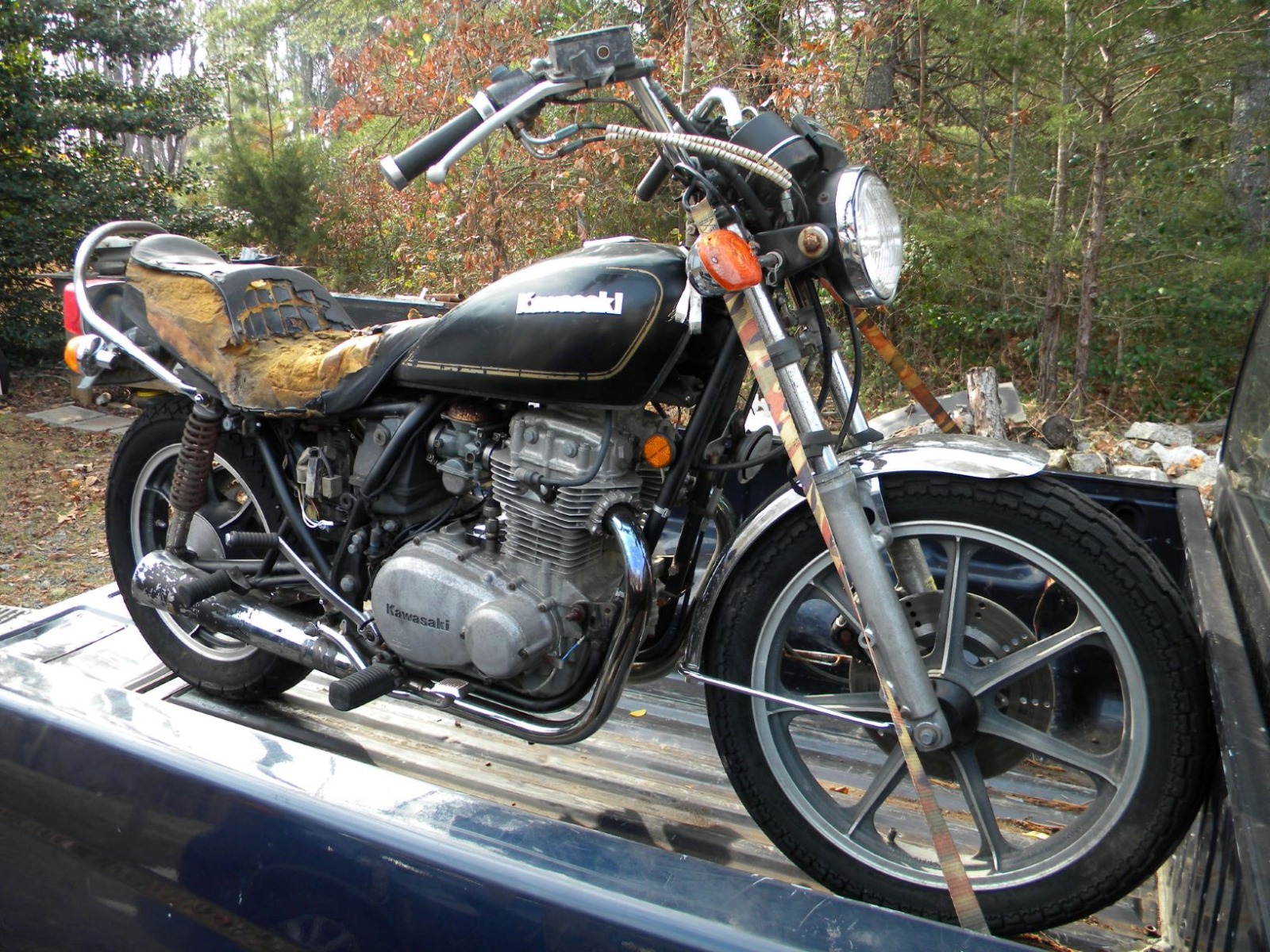

I'm in a bit of a pickle here - I have a '79 KZ400 LTD that needs a lot of work after sitting outside for 25 years or so - pistons are frozen, fork tube caps are toast, exhaust cones have rusted off the headers, bolts breaking off everywhere - you name it, it needs it! But I can't find ANYTHING parts related/specific for this bike!  Since I'm kind of a 'parts specific' guy, is there another KZ400 that this bike interchanges with?  Am I not seeing the forest for the trees here?  To top it off there's a 1976 KZ400-S2 that is teasing me and my wallet that 'needs work,' but it's all there and parts for THAT bike are Everywhere!  I can't even find a parts catalogue for the '79...I'm caught between putting money into the '79, or dumping it and going for the '76, mostly because I can't find Jack-Squat on the '79...I'm starting to believe the 78-79 KZ400H LTD is a pretty rare bike - or am I wrong?  Which is the better bike? Any and all opinions welcome!

...and ThatGPzGuy, you got that right...I had no idea parts for the H-model were so scarce. I may have to back-burner the H-model and go with the S2, because it seems parts for THAT bike are more readily available. My thing is I did a lot of reading on the KZ400 and it seems like it's a great bike, so of course I tried to find one, and I did. I've got a '78 KZ650B in the garage already that I restored a few years ago and Love it, and thought it would be fun to have another example in there next to it - and honestly the S2 IS a better-looking bike; it's all there, plus I'm a spoked-wheel kind of guy anyway...but this is what I have:
Yes, it looks okay on the surface, but both the spark plugs broke off in the holes, the mufflers and cross-pipe crumbled off the headers, the pistons are frozen in the cylinders, the case covers are being difficult, the carb diaphragms are torn, the points plate and advance are shot, the clutch and brake levers are of course frozen and any number of things yet to reveal themselves. The PO said it had been stored outside for years, which is just insane to me, but it was cheap - $100...Grcko, is there a specific gasket set for the 400 in your avatar? Did you rebuild the engine, what gasket set did you use (if any) and are you just sourcing parts wherever...?
