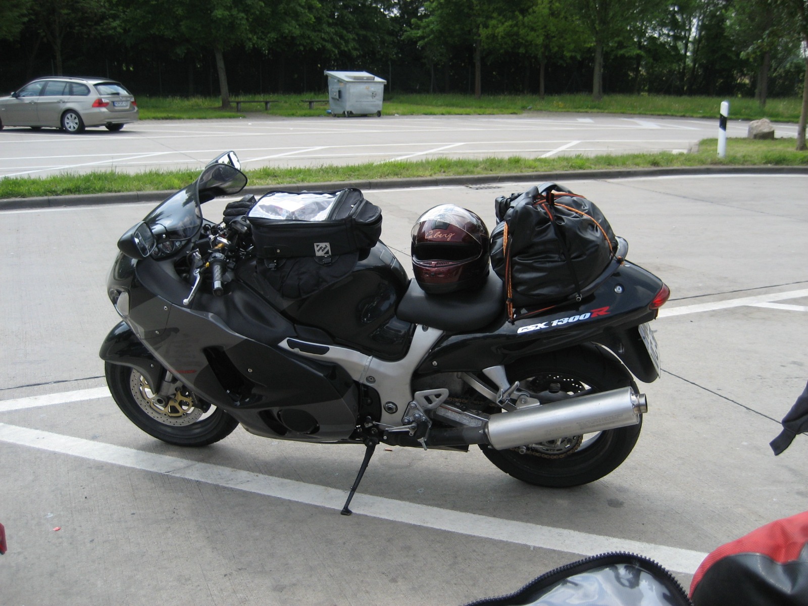

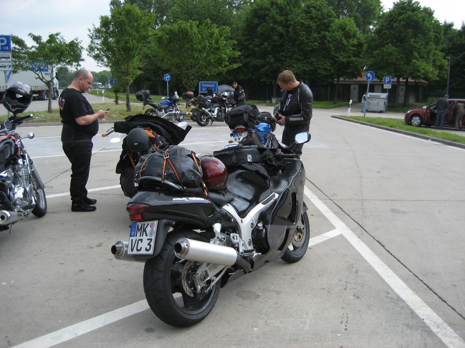

A chain and sproket set life time is dependent of the driving condition, like in wet/dust/dirt terrain and the periodic maintance, like cleaning, lubing and a correct chain tension adjustment. So more often you clean, lube and adjust your chain/sprocket set, so more life time you get. A fresh chain lub catch up/attractive street dirt and dust.
Cleaning the chain and sprockets every 1000 miles with diesel fuel and lube every 500 miles. Let the chain lube thinner dry out for 30 min before take off or you will slingshot the lube all over the rear wheel and frame parts, (more cleaning). A good maintance chain/sprocket set will last more than 30000 miles. The chain/sprocket set on my 2000 Suzuki Hayabusa high speed autobahn/long range touring bike was changed in 2009 (20000 miles ago) and didn´t show any massive wear at all.
(I think, the chain set will last the next 20000 miles, i hope so ).
I my self prever only rivet chain master links, and i don´t want to bet, terminate or trust my life beyond 300 kph on a clip on master link.
