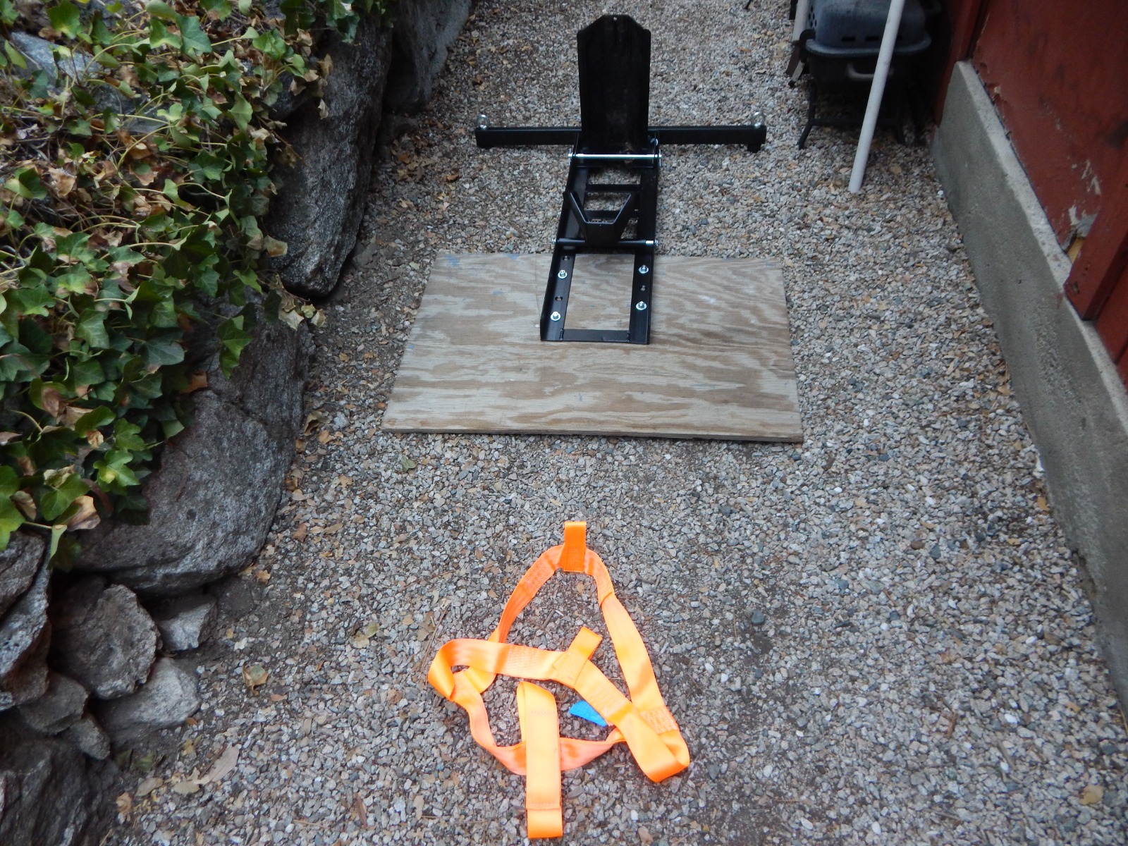

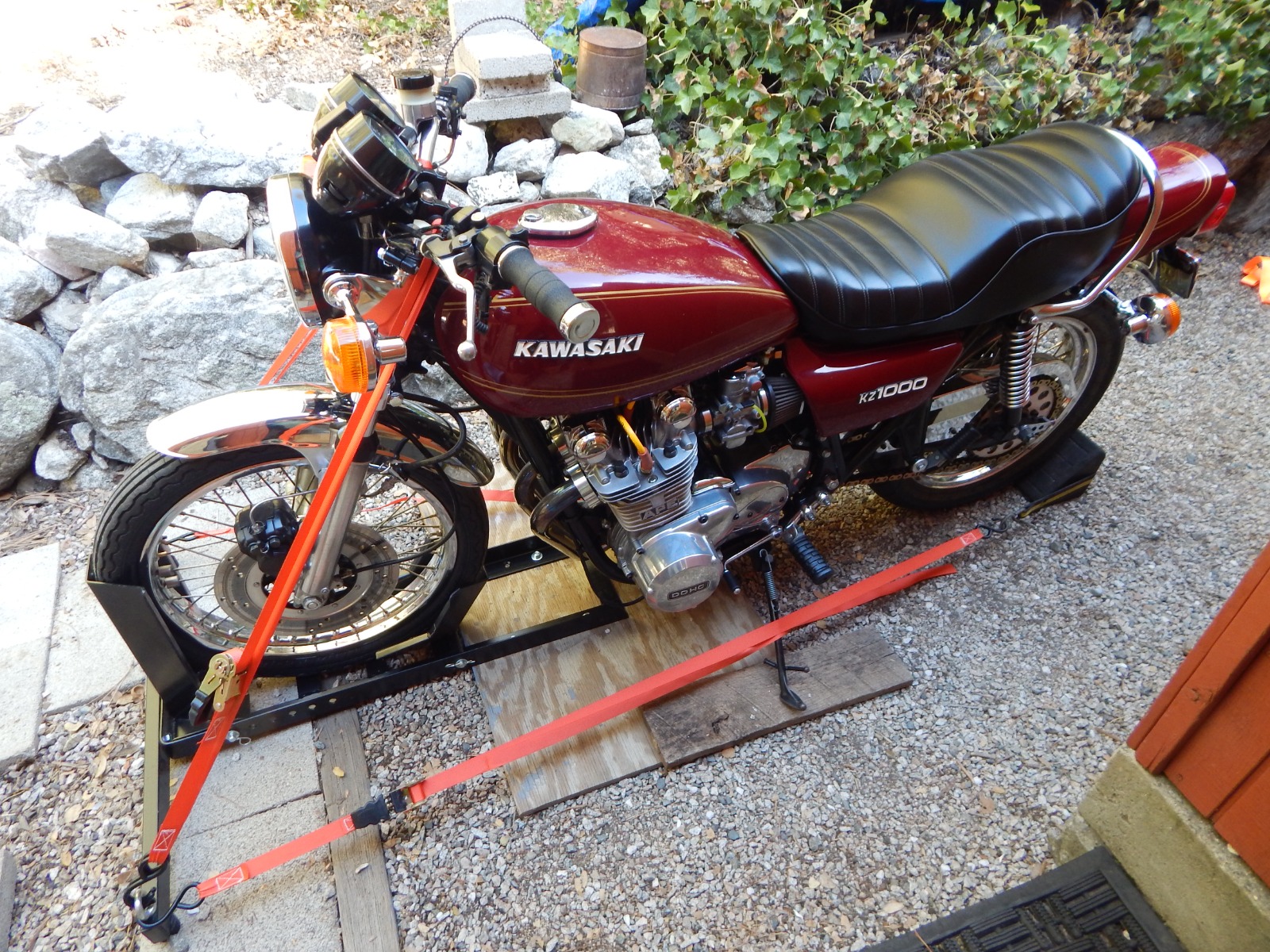

Thanks all. I was planning on moving the bike myself inside the moving truck, the trailer will be for my 4wd. I already have a mc stand fitted to a piece of plywood that will hold the bike, with a rear wheel harness strap that will also be secured to the stand. pic. I think I should be ok, barring any roll-overs. It's knowing the equipment will be there on moving day that is uncertain ? Also DOCH, I be just outside of Ligonier, not to far from the Burgh.

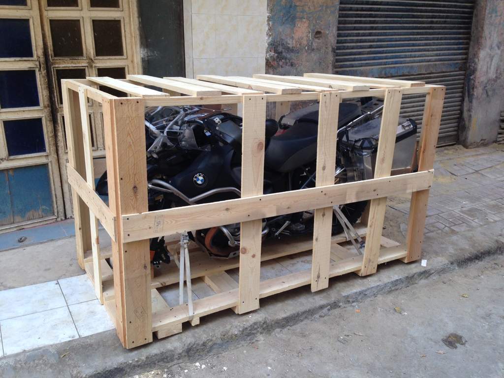

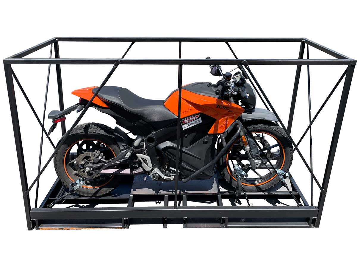

I would ask your local motorcycle dealers for a used motorcycle crates. They dump them in the scap metal bin anyways.

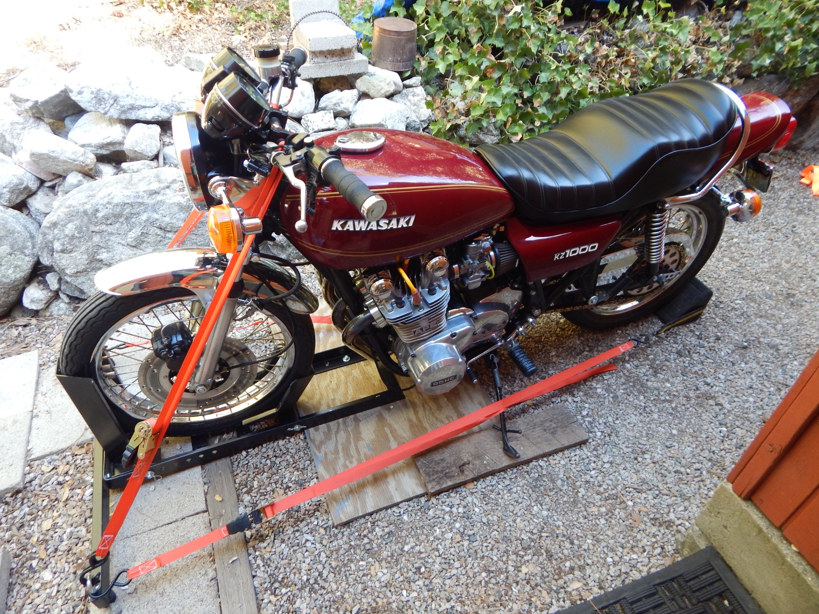

Thanks, I will check for a crate as that would offer more protection from the other stuff that will be in the truck. If I can't find a crate this is about what it should loo like inside the truck, but will be double strapped.

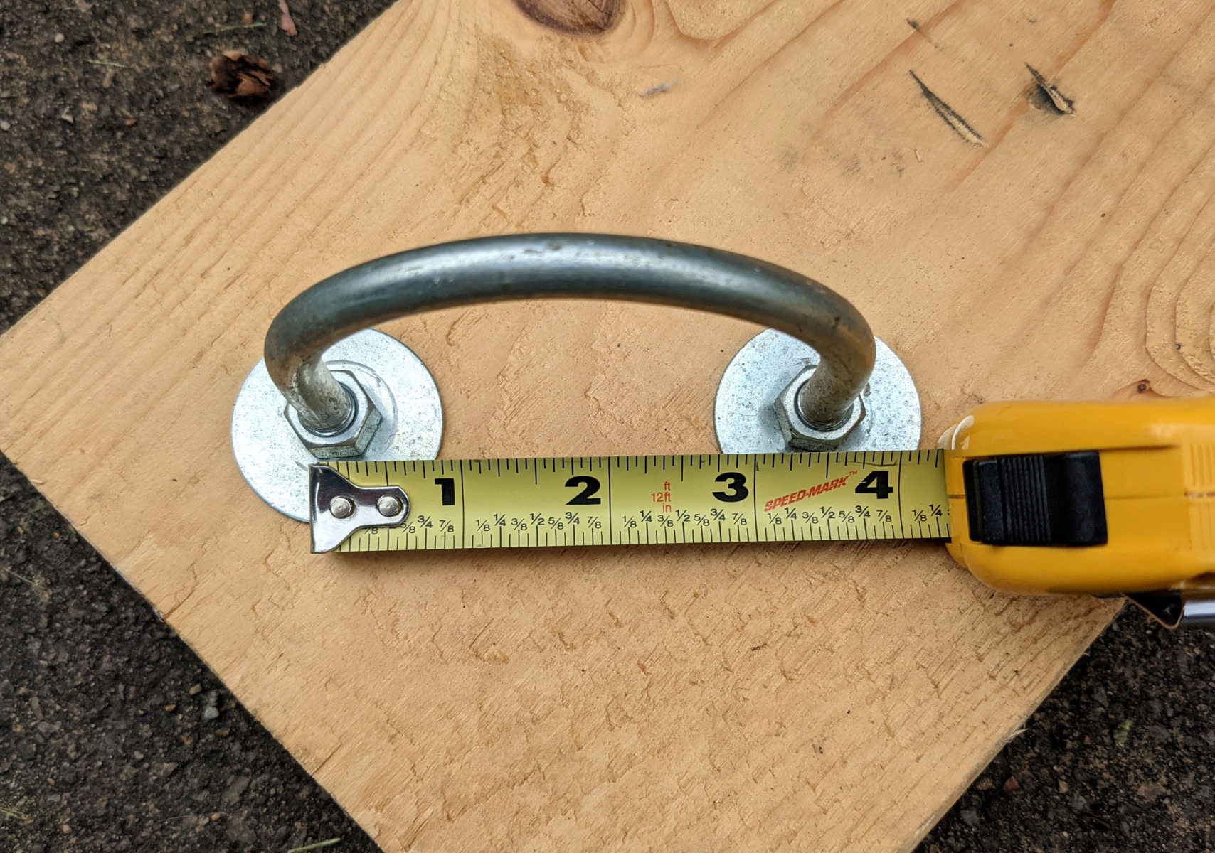

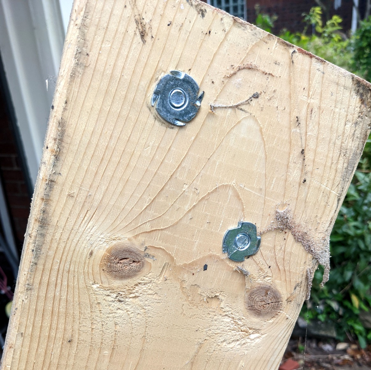

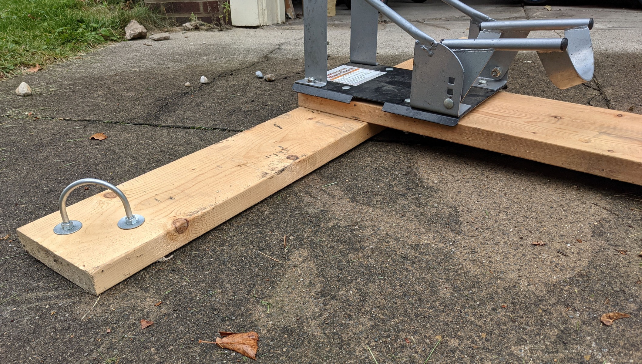

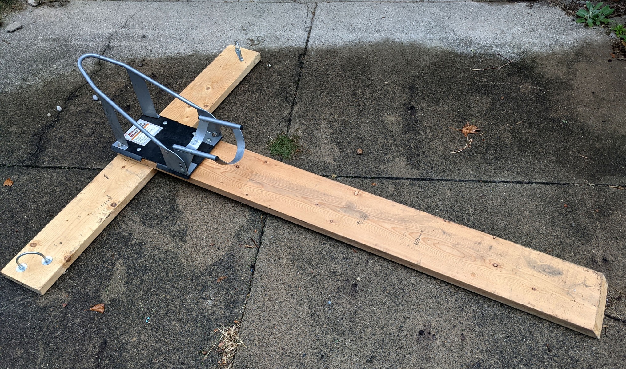

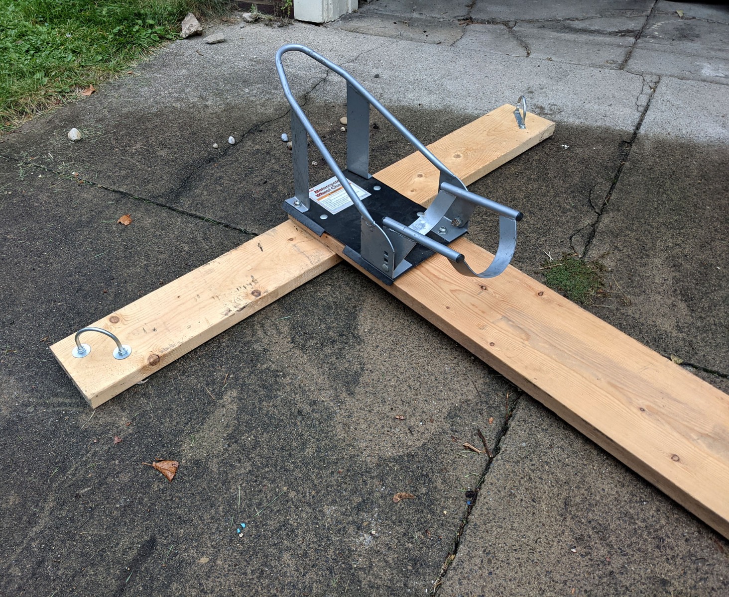

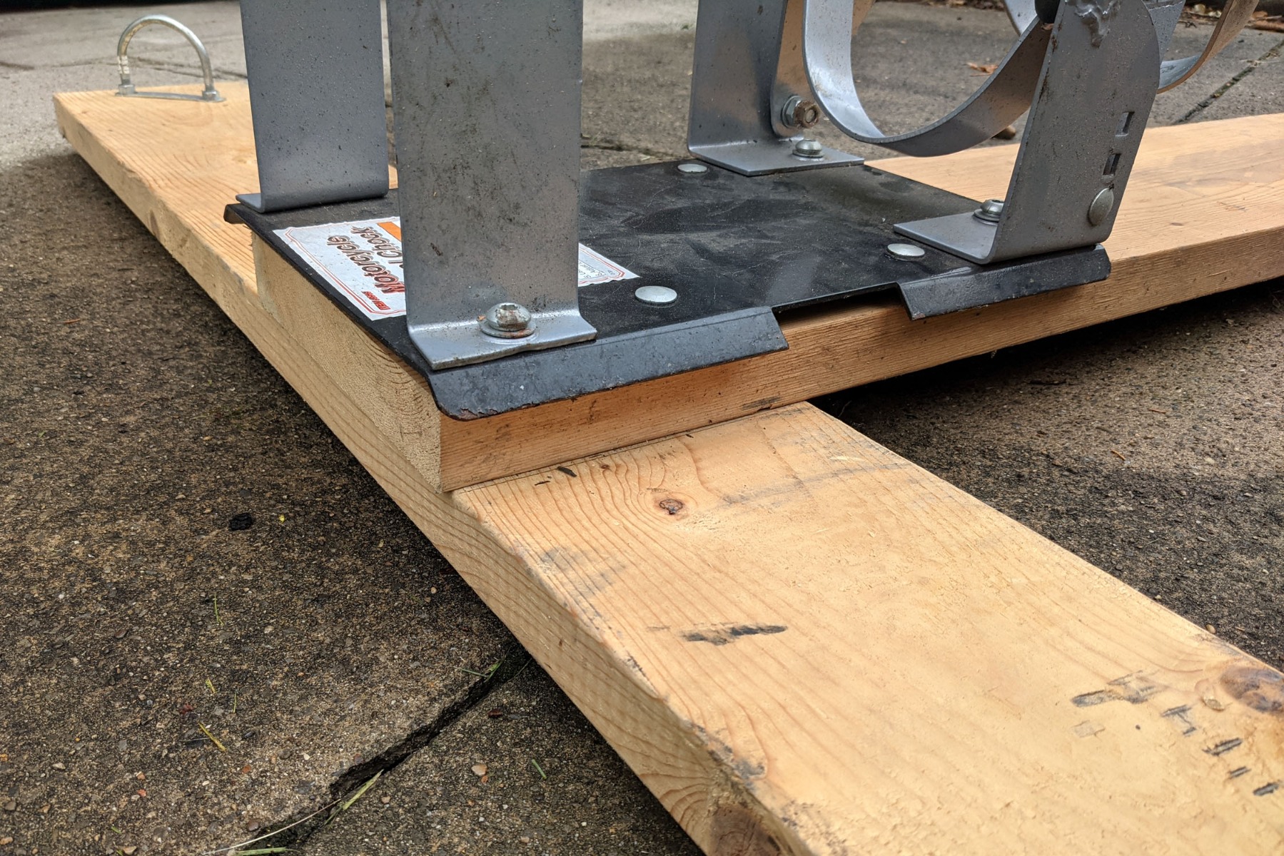

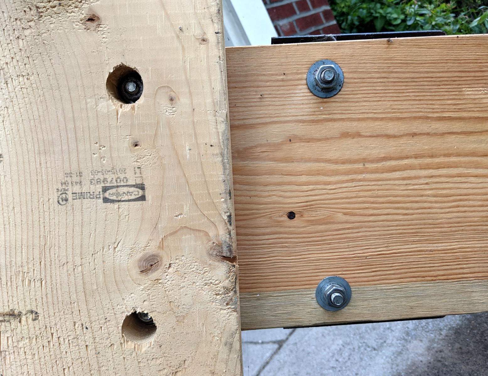

I've moved bikes maybe 6+ times with box trucks, using a stand made with wood and a Harbor Freight wheel chock.
www.harborfreight.com/motorcycle-wheel-chock-69026.html
I made the stand in the shape of a "T" using two pieces of 2x8 or 2x10. The top/horizontal part of the T is about 5 feet long, and the vertical is the length of the bike. The vertical lays over the top of the horizontal, screwed together with deck screws. The chock bolts to the vertical (and since it's raised up the bolts don't hit the floor), and the ends of the horizontal have U-Bolts with flush nuts on the bottom. The bike rolls into the wheel chock, and I run ratchet straps from the handle bars to the u-bolts. I also sometimes strap the rear wheel to the vertical bar as well. Now the bike is locked to the stand and can't go anywhere. It's very stable and has worked very well for me. The only challenge really is getting the bike into the box truck.
All of the wood and hardware came from Home Depot. The last time I did this I used a one-way truck rental. I just took the chock, hardware, screws, and a drill/screw-gun, then went to a local Home Depot and had them cut the 2x10 into two pieces, then built the stand as I picked up the bike.
Of the trucks I've rented, the Penske trucks have had metal floors, and the U-Haul trucks have had plywood decking. I have never seen a box style moving van with D-rings or tie downs on the floor of the truck. I've only seen them with wood rails along the walls.
With the wood floors, I used 3 or 4 deck screws and just screwed my stand to the floor. When I pulled the deck screws out I couldn't see the holes. This is how I moved 2 bikes from Boston to Austin. With the metal floors, I've used straps to hold the stand to the rails on the walls of the truck. In this case I pushed the stand up against the front wall, and used the u-bolts as tie points to strap the stand to the truck rails.
It's the same general idea as the stand you have, but the arms are wider and the bike sits completely on the stand.
One word of caution. When you carry around a stand like this, which is very cross shaped, people give you some really weird looks.
