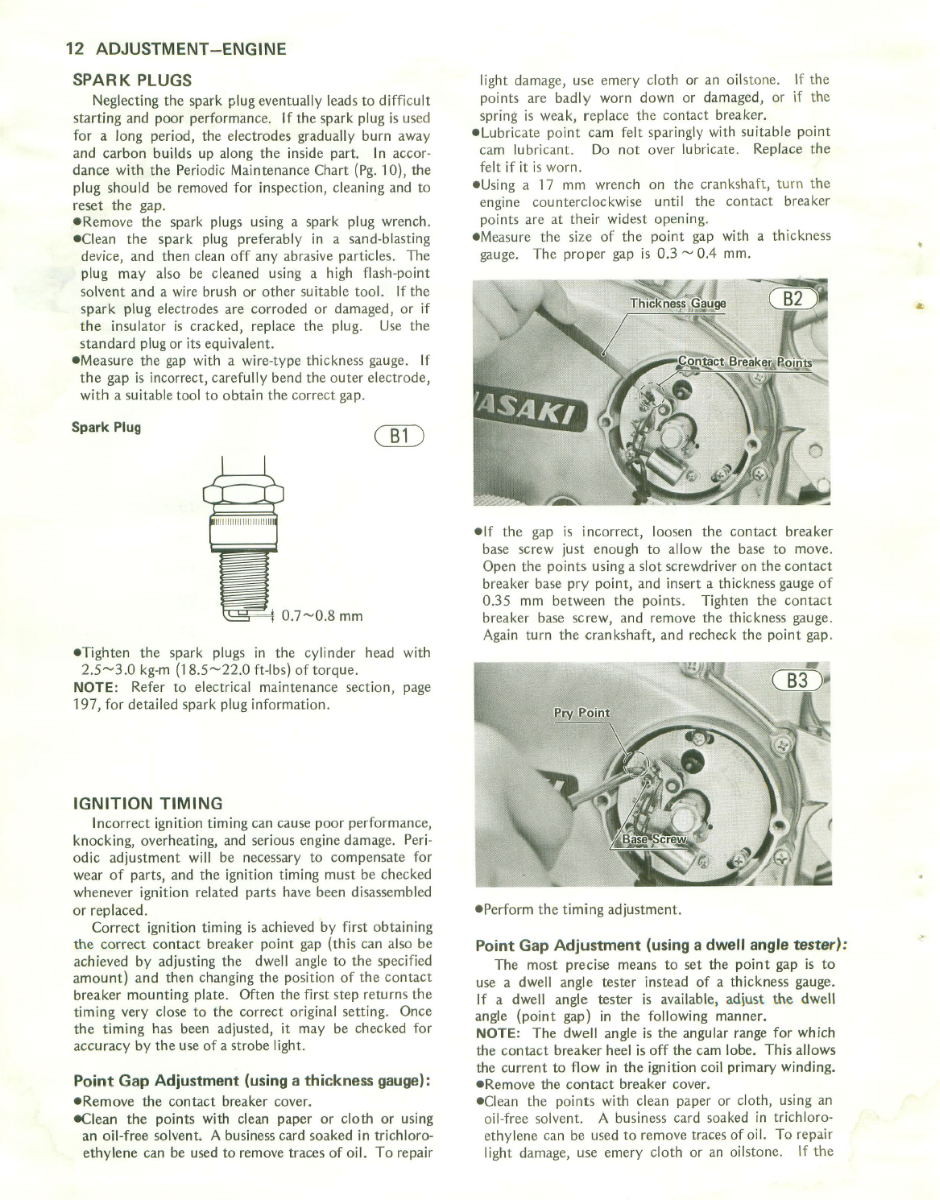

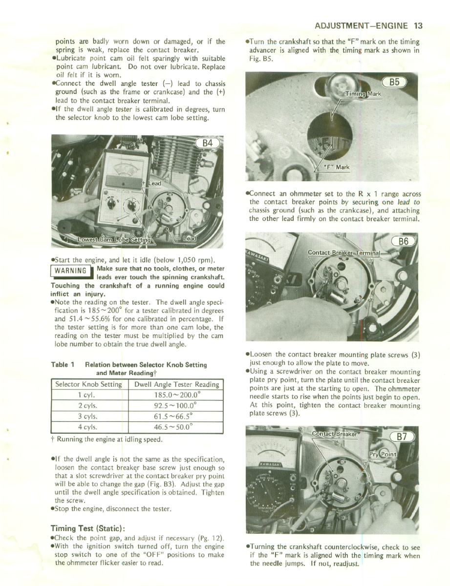

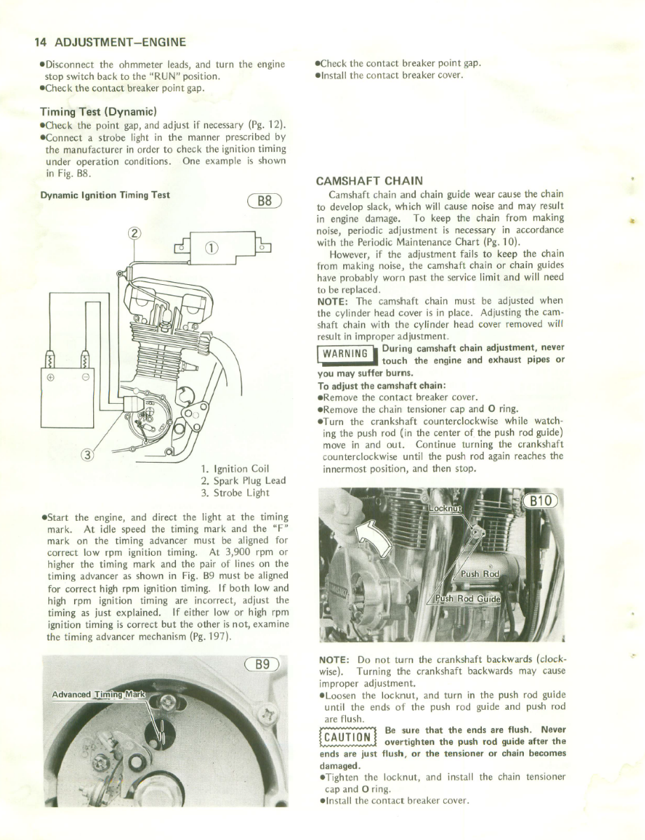

In your original post you mentioned with a timing light it was on the F mark. I mentioned to use the timing light and watch the F mark as you increase rpm. The F mark should move away from the timing pointer cast into the case, if the advancer is working. So, you have proved is the bike is not timed correctly. That will most definitely cause it to run poorly.
- Did you check that the advancer is working?
- Did you reset timing as described in the manual DoctoRot posted?

The advance dial on the timing light does not correlate directly to degrees on Kz. The light's advance knob is usually calibrated for a car using a mechanical distributor. This means the light is expecting to see one fire every 720 degrees of crank rotation, but on the Kz it sees one fire every 360 degrees of rotation. As such, the timing knob is off by a factor of two.
If the knob reads 30 degrees, you are seeing the strobe flash at about 15 degrees of Kz crank rotation after the actual fire happens.
So ideally on the Kz, when the knob is set to zero, the strobe should flash when the F mark is lined up (at idle). When the knob is set to double the Kz's timing spec., the flash should happen when the T (TDC) mark lines up.
The Kz timing marks are very convenient in that it gives us an F mark, so we don't really need a light with an advance knob. I just leave it at zero. I actually put a piece of tape to hold it at zero because if you unknowingly bump the knob and set the timing, it will throw off your timing.
At higher RPMs, there may be a further set of timing marks to indicate the timing at full advance. Sometimes it will be two marks and the timing needs to be anywhere in between those marks.
It's hard to see where the flash is happening on the video due to the nature of how digital video scans the image over time. That's why you get that moving flash appearance. If you have a slow-motion capture ability, that will probably give a better result. I'll try to look again at the videos.
From what I can tell, I agree, the timing looks a bit to far advanced.

thank you, Yes, I did use the timing light, when I throttle to higher RPM, the timing marks do advance (and move back when I release throttle)
I set the static timing by aligning the F | mark on the on the compression stroke and setting the points to a gap of 0.330 (using gap gauge)
