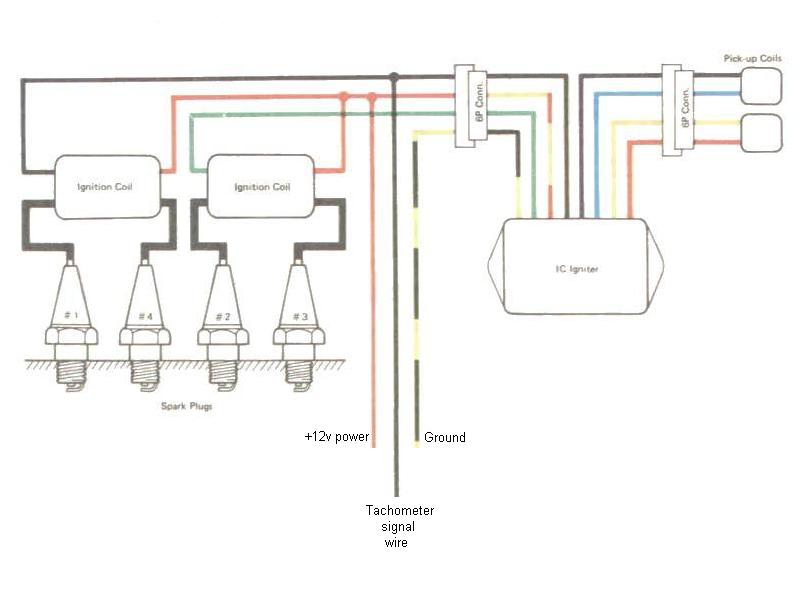

good day i am looking for a wiring diagram on z1r i dont have spark and i have tested my ig igniter on another its working and my pickups are working. what i have noticed is my coils + and - have permanent power and my pickups have permanent power on both wires and my casing of ig igniter has + power on it . can someone please assist me.....

With a factory electronic ignition, it is normal for the + and - of the coil to have 12v most of the time. The negative side will have brief pulses of ground to charge the coil.
I'm surprised to hear the pickup wires have 12v on them. You might want to look at the wiring for that. The pickup wires should go to the igniter and nowhere else.

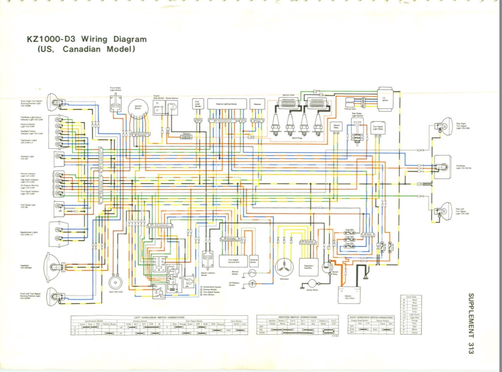

This diagram is not necessarily for the Z1R, but is basically the same for any Kz1000.
Sometimes the red wire will be red and yellow.
Some bikes won't have the tachometer signal wire.
