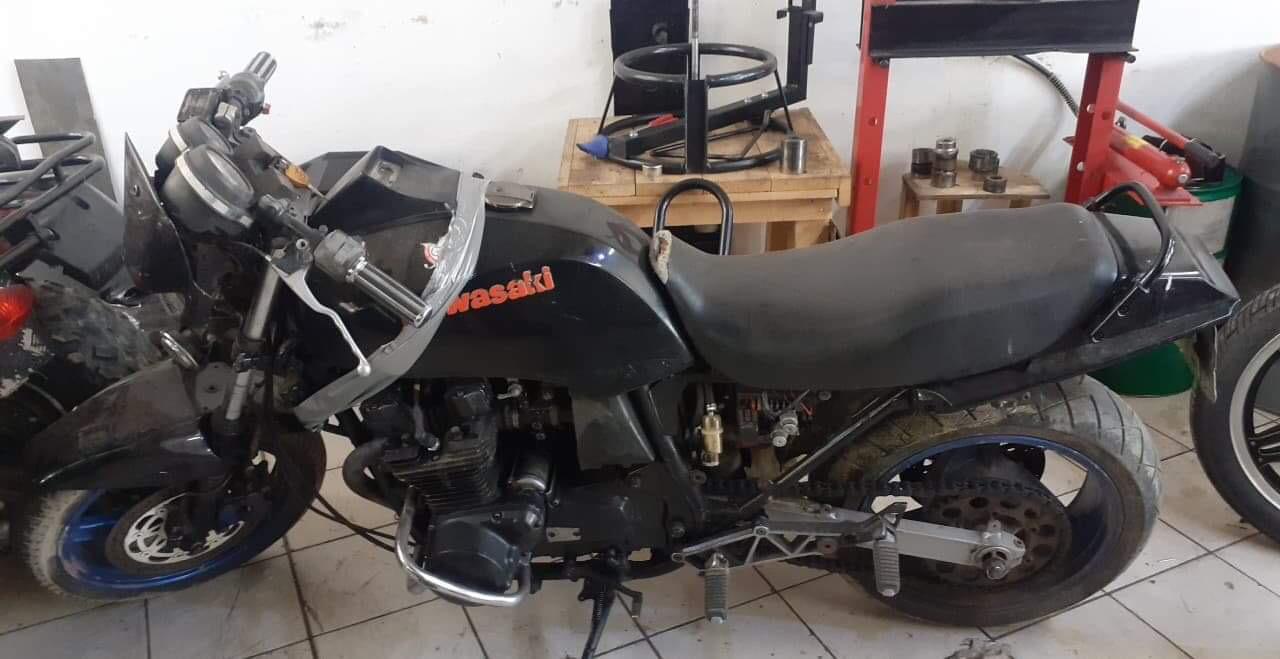

So im very close to securing a 1984 gpz1100-A2 "project bike" in the next week or 2, Iv owned the GPZ 500s, 550 and 750 unitrack in my past bike life and am excited to have the 1100-A2 in my life. The only thing is it has been stripped down and streetfighterd to use the term loosely. Parts for her body wise are nearly non existing over here in Ireland but thare are a few more GPZ 750 out there, im just wondering body wise are the parts interchangeable? Mostly the headlight and mounting bracket, the difference is 700 euro vs 250. Also im keen to run regular carbs on her rather than fuel injection, has anyone done a conversion, thanks in advice for solid information.

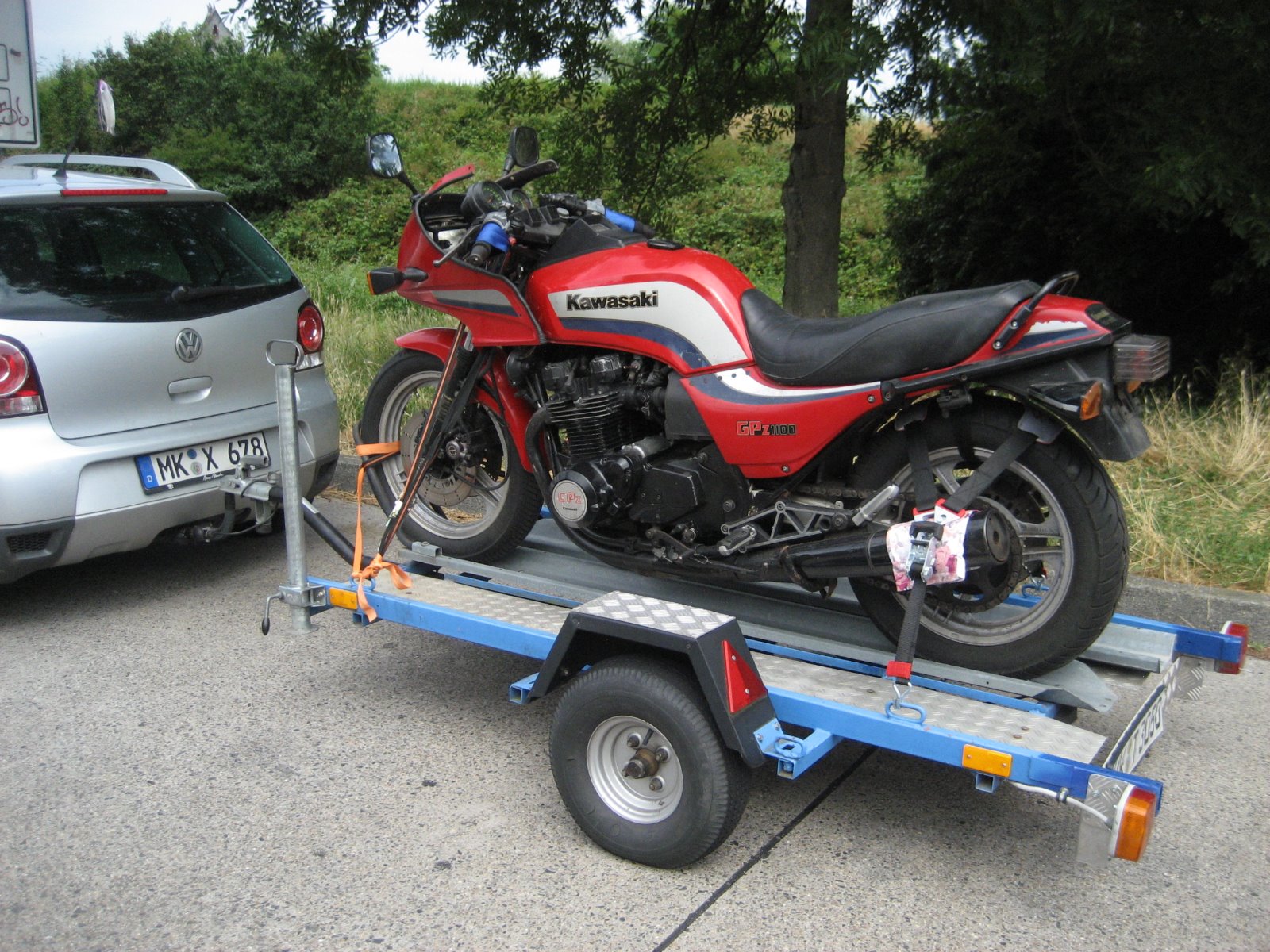

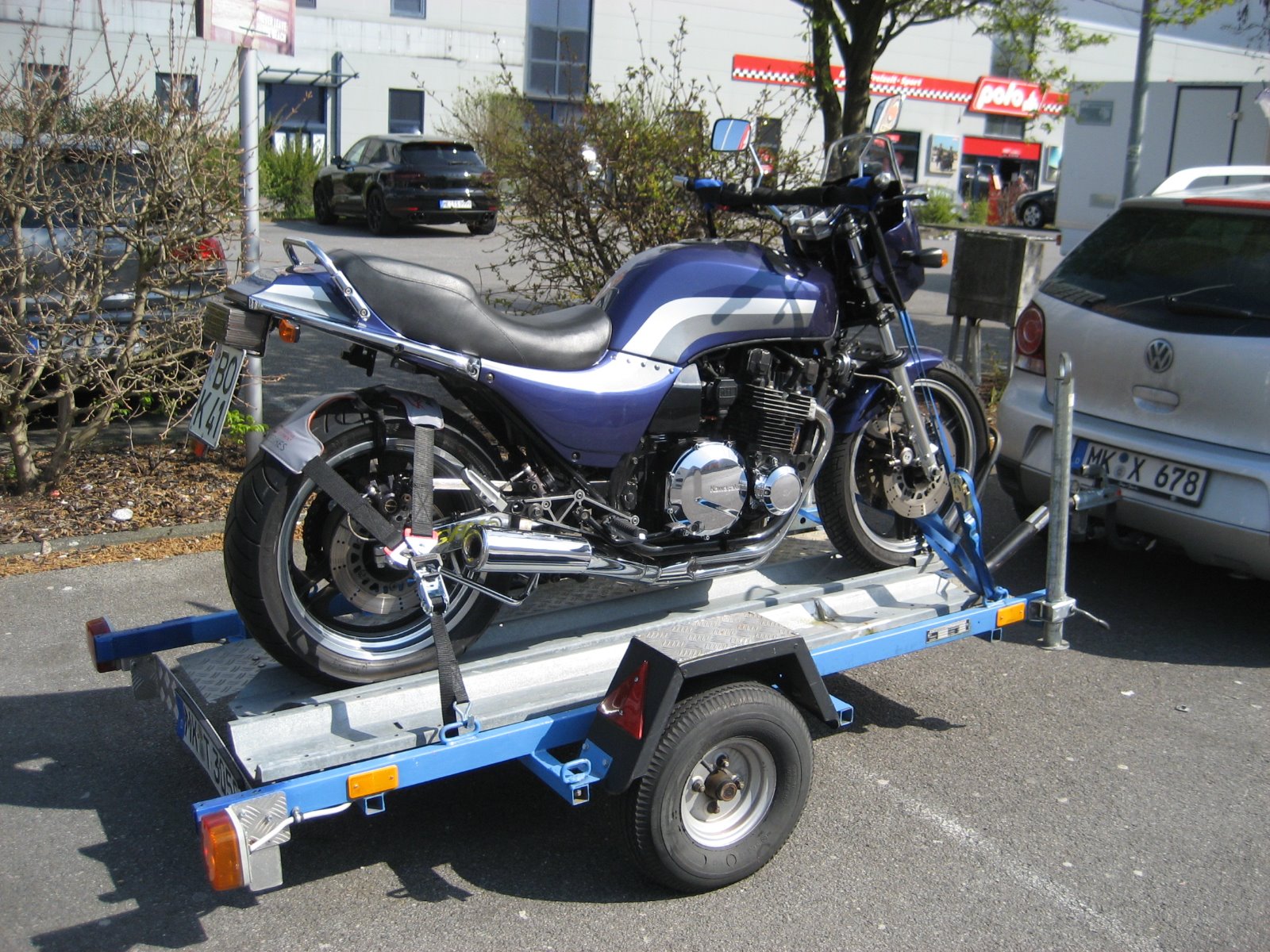

I have two GPZ1100UT, both in driving condition and one as a parts bike. The EFI injection system is bullet proof and easy to maintance/adjust/repair.
Will upload an EFI Troubleshoot and Training Manual tonight to the filebase.
