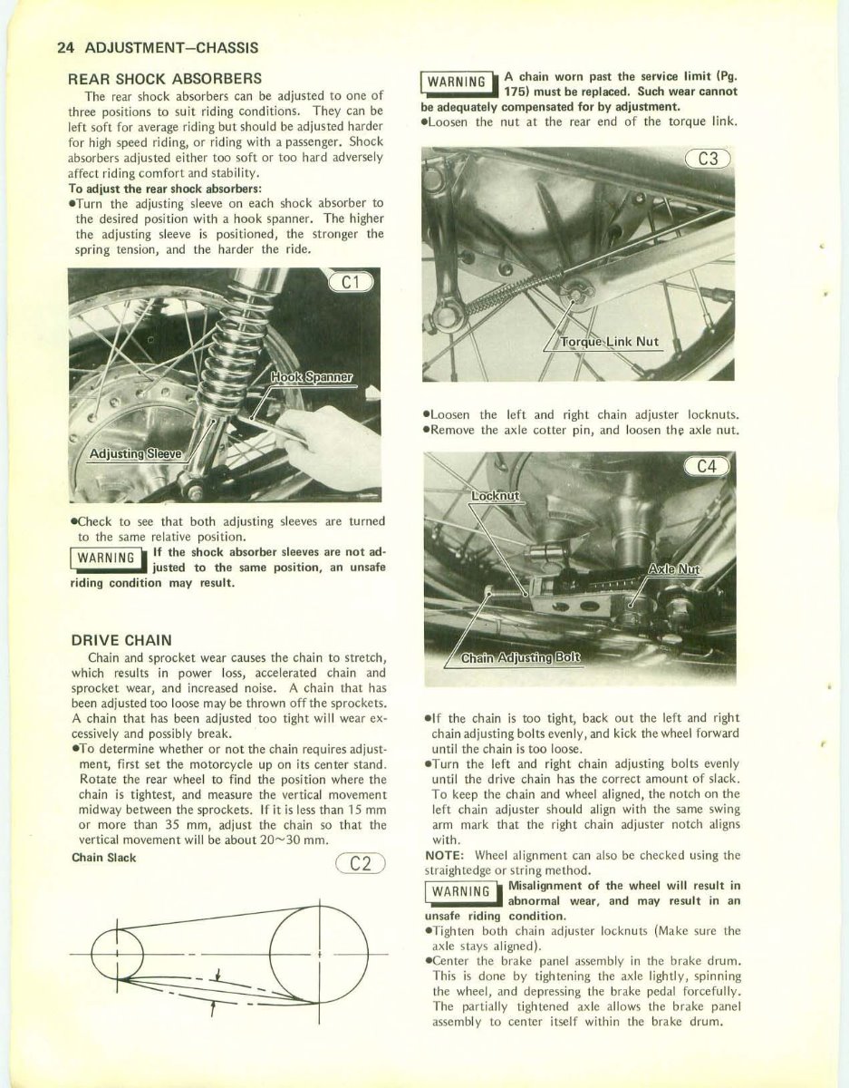

Did you check you drive chain slack? A to loose chain could rub on the sprocket cover housing or swing arm and mimic the clutch clicking.
