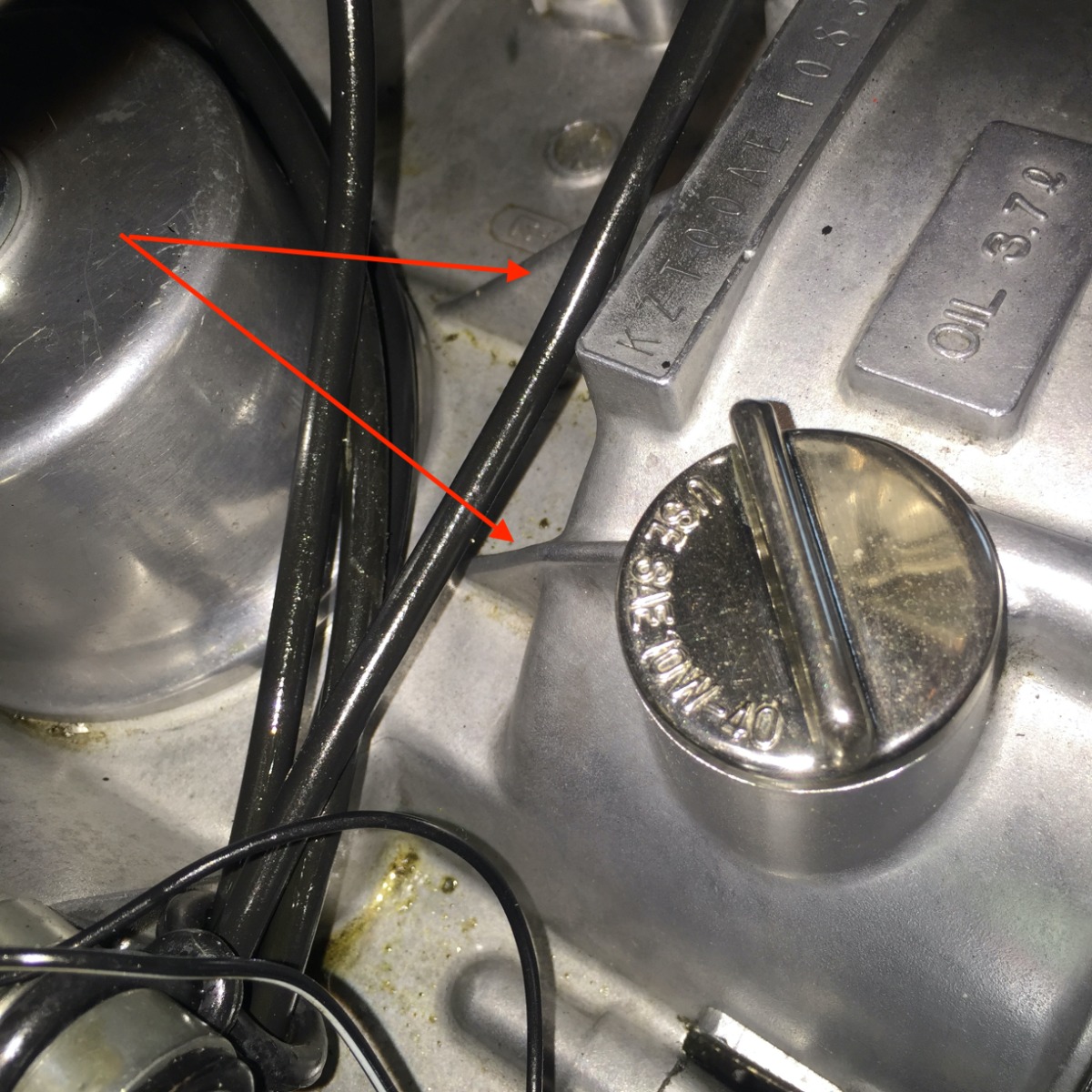

Look at your engine, near the oil filler spout. If you have the two braces as shown in the photo it's a Mark 2 engine. You can confirm it by counting the number of teeth on your cam shaft sprockets. They will have 32 teeth. Earlier engines had only 30.

Great thank you all for the help identifing my bike. So i do have that rib at the filler neck.
