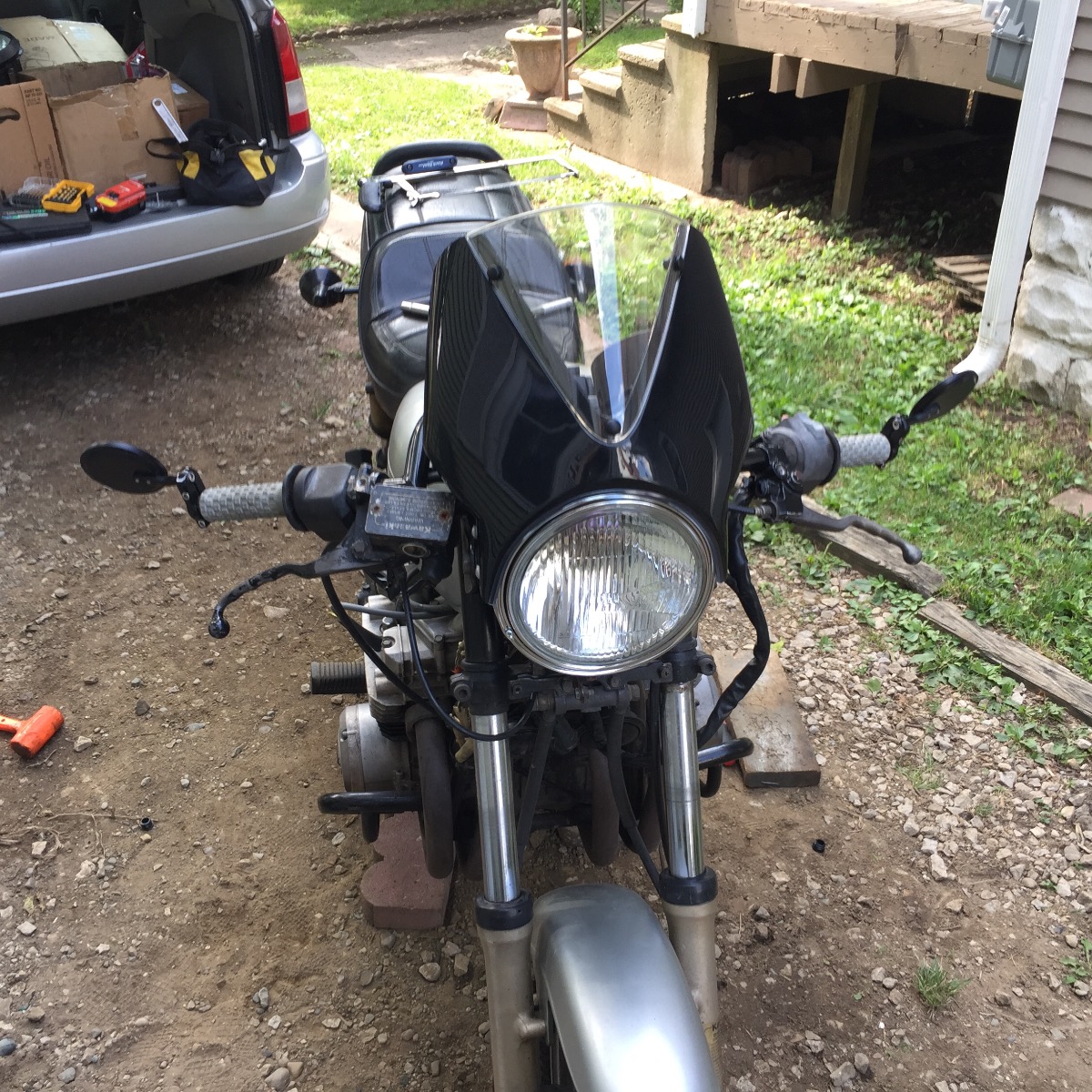

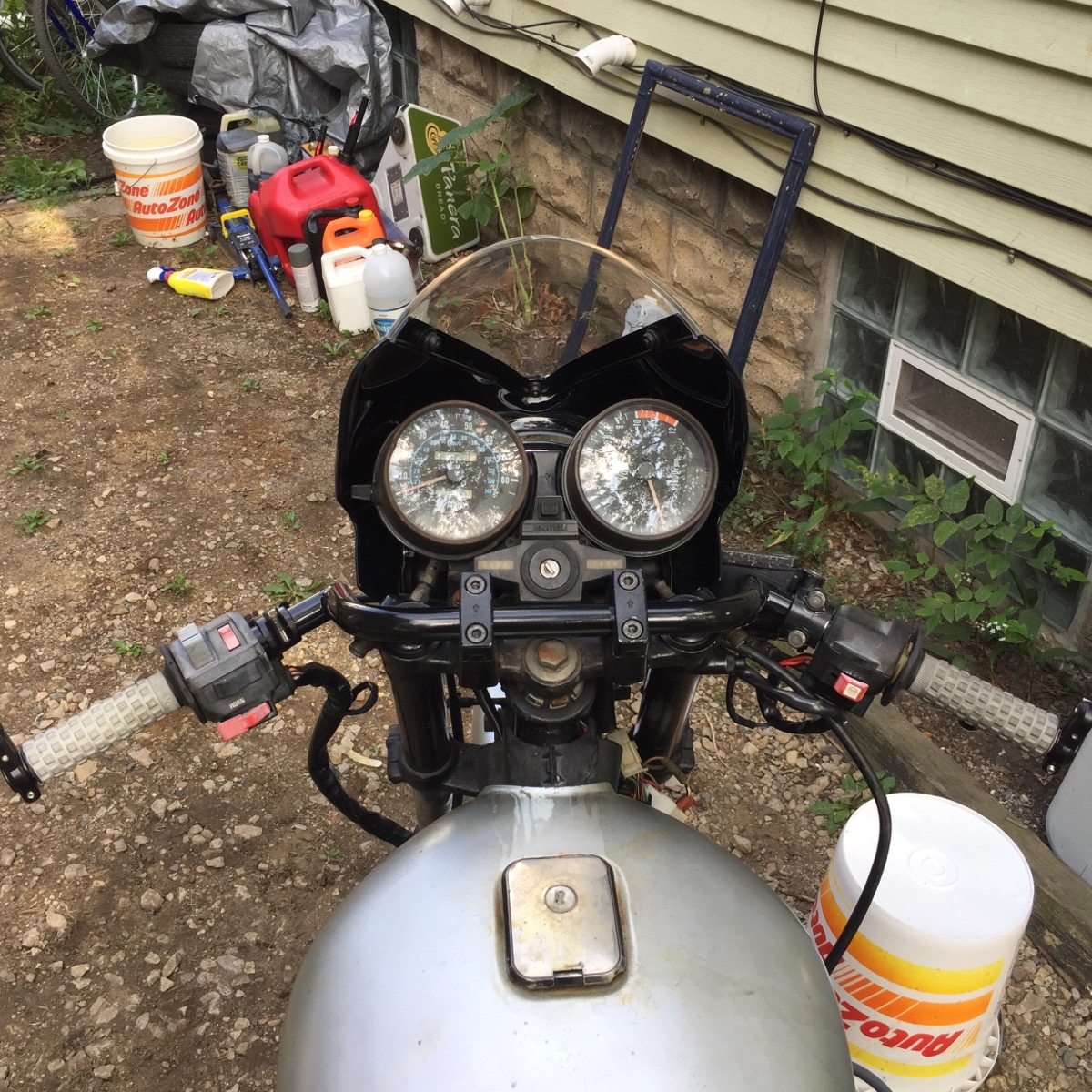

Thought I’d post my results for all to see! Might help someone make a decision. I’ve had superbike bars for a couple months, but they’re too upright for me (I’m 6’4 unfortunately) and look weird. So I took a chance and these just BARELY fit with stock master cylinder - and at that it’s likely only because I have them at a downward angle for ergonomics.
I’m not sure I’d recommend buying these bars - the finish needs to be taken back for the throttle tube to fit, they chip and scratch easily, and while they feel fine I’m not sure about the weld quality - but I know a lot of people are like me and prefer to buy dangerously cheap accessories.
Also shown is my Puig Vision windscreen, which is extremely nice! Fits like a glove.
EDIT: By the way, they don’t come close to hitting the tank at all!

Your front brake reservoir looks like it's in the wrong position. It should be level (horizontal) not angled down the way it is shown in the photos. Ed
