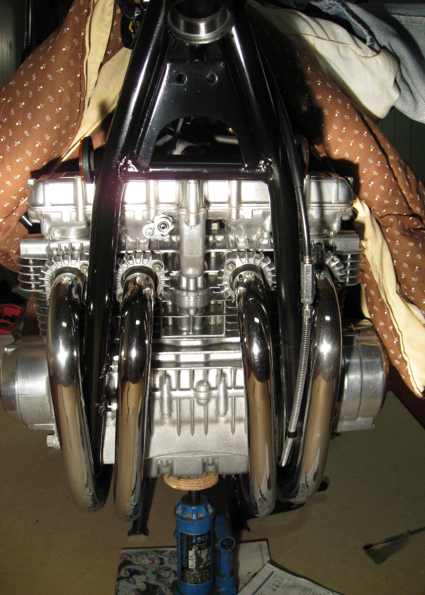

So why not simply re-install a center stand? With that you can not only easily check the oil level you also can work on the front or rear of the bike. The centerstand is the only thing needed to remove the rear wheel, swingarm, etc. , and only a bottle jack and the centerstand is needed to remove the front forks. Ed
