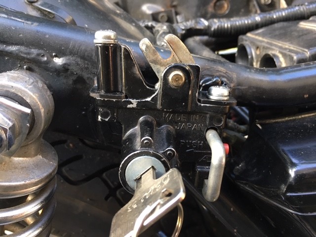

I am looking for a picture and dimensions for the right hand seat/helmet lock bracket.The PO cut it off and now I have a keyed set of all the locks/ignition switch/gas cap, I would like to get it put back on. Thanks

From EB pics the bracket looks pretty simple. Just a flat rectangular piece of metal welded to the frame and it has a hole for the helmet lock pin plus a hole for the fastener. I couldn't find a great 440 pic, but I assume the bolt hole is threaded.
item number: 402080280769 >> i.ebayimg.com/images/g/0cEAAOSwiS9eQBGX/s-l1600.jpg
item number:233314811672 >> i.ebayimg.com/images/g/CzMAAOSwr~9dSeMw/s-l1600.jpg
KZ305 >> item number:164163752337 >> has good photo of the mounting plate.

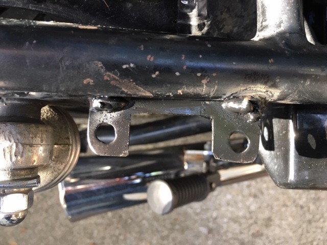

Thanks for the response. I finally for a picture of them. Two straight pieces of metal with a hole is correct. Should be simple to do.

I made one and got it welded on. Works perfect.

I assume you'll have to use a bolt & nut to attach the helmet lock. If so, I would use a locking nut & loctite thread locker.

The bolt goes through the hole an threads into the lock body. Loctite is a great idea though. Thanks.
