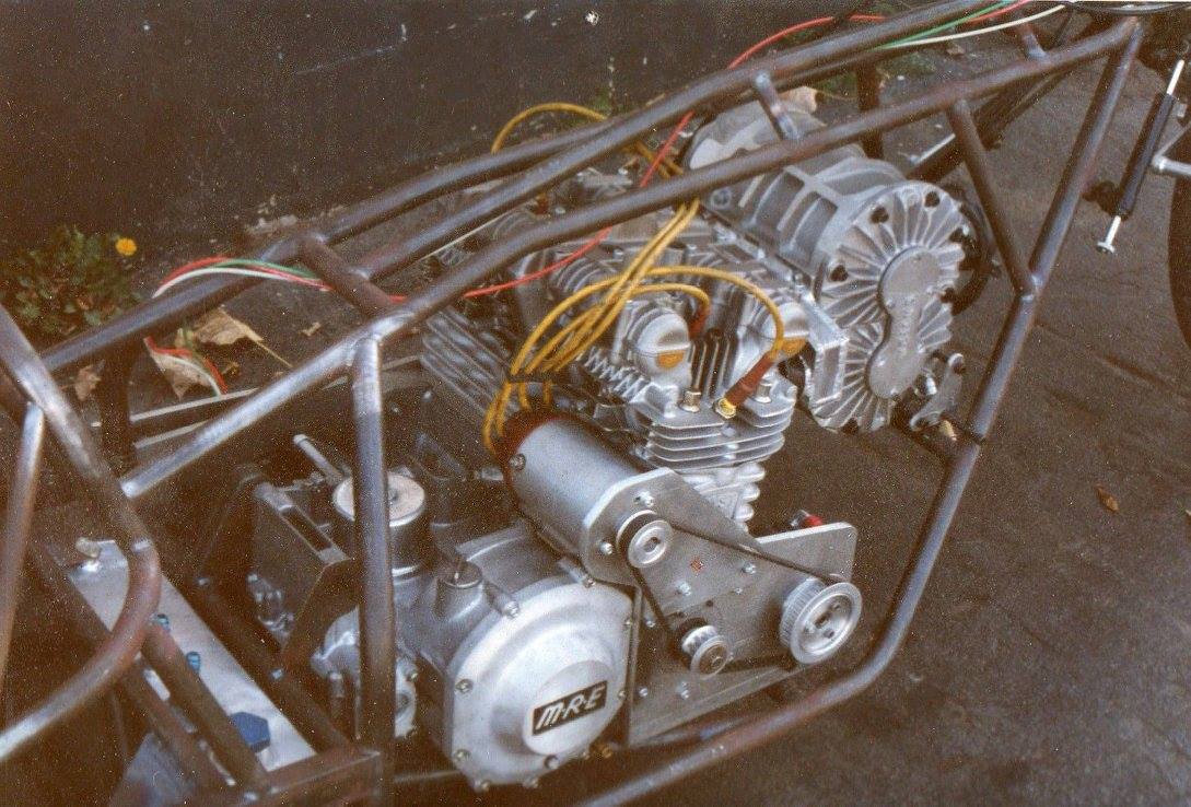

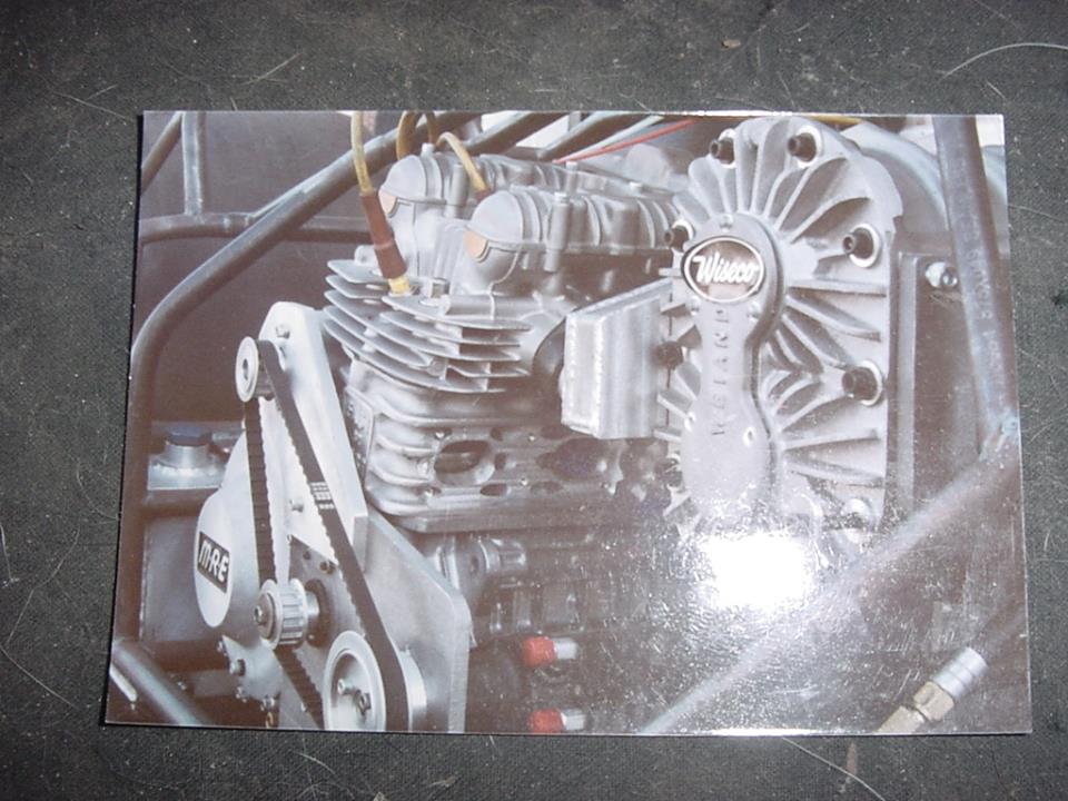

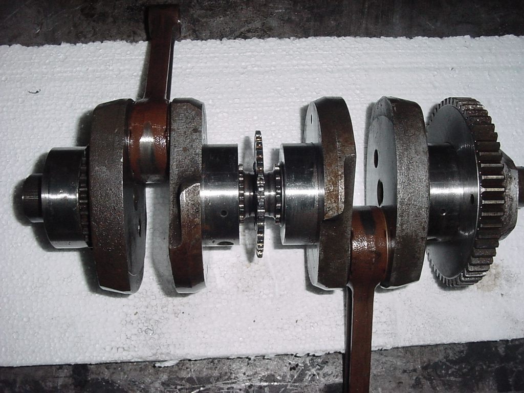

On the subject of Kawi Blocks?? This is an old picture from the late 80's. I don't think anyone will know what this is??????
No one will believe me when I say what it is! Great brain teaser!
I should make a seperate post for this.

2 stroke diesel conversion kit?
- z1kzonly
- Posts: 2815
- Thanks: 527
Re: barrel re sleeve on a zx750e
12 May 2020 22:04
You are correct Sir! Jim Mangus, "Jim's Cylinder Heads" Buffalo, NY. Diesel on Nitro. Yamaha DT 360 pistons. Got a 7.20 ET out of it. Did not work out. He gave up. This was mid-80's
