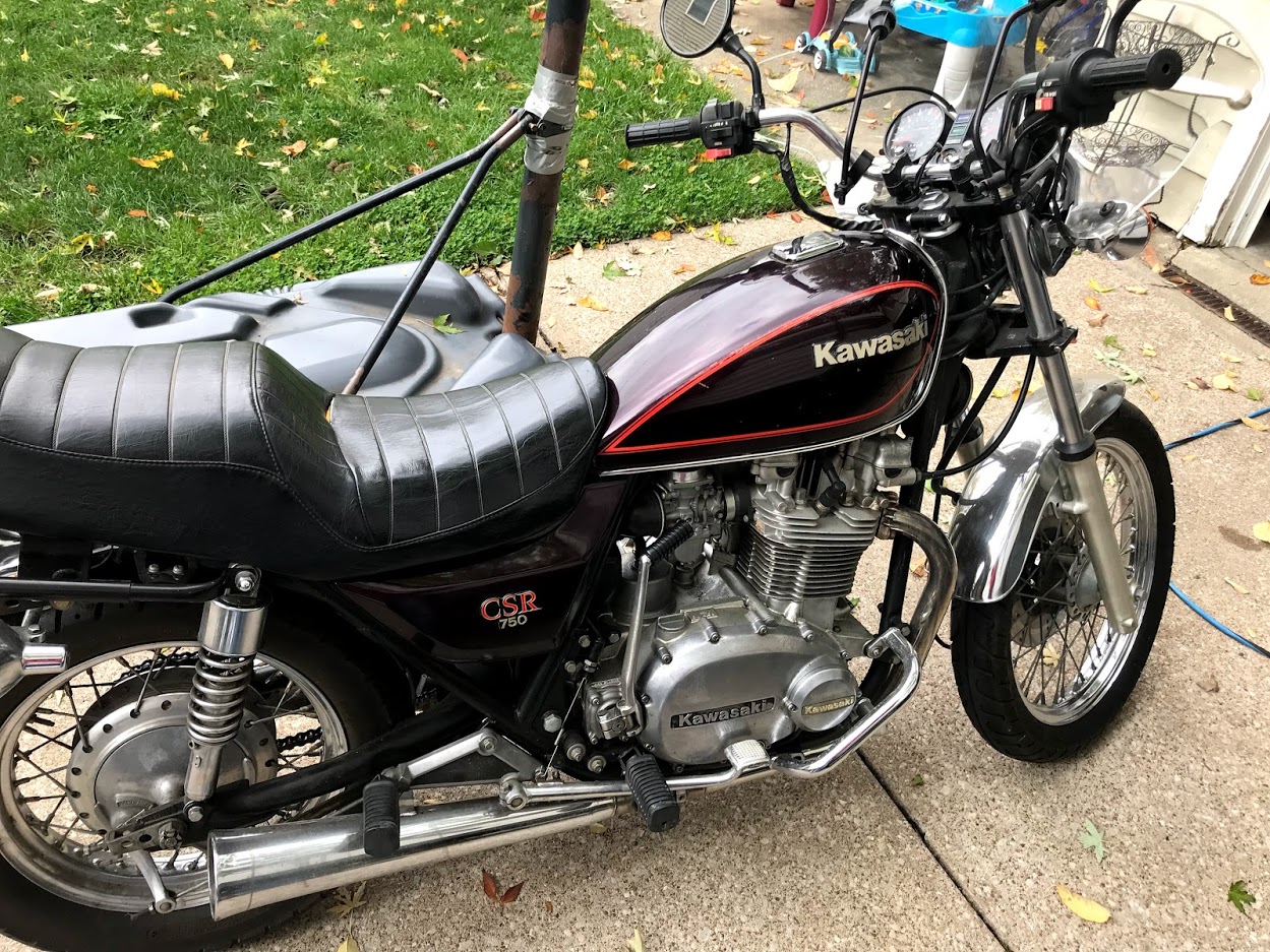

Does it look like this? I have an 82 KZ750 M1 and the VIN also starts with JKAKZDM. According to Ed's link it should be that model.

my frame is stamped 79 kz750..engine kz750b... 81 has electric speedo and tac i do belive ..yours looks mechanical
