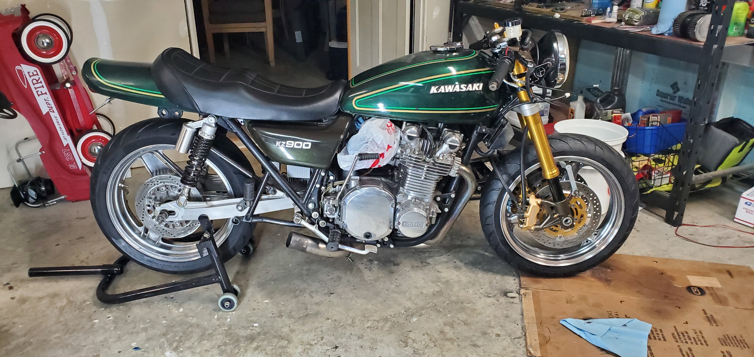

19 Dec 2019 06:21 - 19 Dec 2019 06:54
Good find, and you may be correct. The wheel is for sure off of a 88 zx10, but the hub studs are not.
Here is a pic as it currently sits.

19 Dec 2019 06:37
Nice build.
If you click Insert or Insert All when posting pics, they will appear big and pretty in the posts and lazy readers will not need to click on a thumbnail. Just sayin........

Re: 1988 - 1990 ZX10
19 Dec 2019 06:54
Thank you.
How about now
How about now

- Posts: 8414
- Thanks: 2800
19 Dec 2019 07:09 - 19 Dec 2019 07:12
Lazy readers everywhere are rejoicing!
