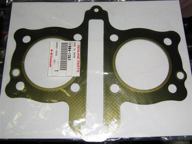

No eBay APP ID and/or Cert ID defined in Kunena configurationNOS OEM is lower risk than aftermarket. Athena brand in particular sucks, and I wouldn't buy anything with green gaskets.
If you look at OEM gaskets the later head gasket has the 1004-1055 part number (the early number is 11004-078). These gaskets are a metal sandwich with some sort of asbestos like material. If you find one in a nice clean looking package I wouldn't be afraid. The base gasket is more of a gamble but again, I'd go OEM. Oh, and any time you pull the head you should do the valve stem seals too.

Re: engine gaskets
07 Dec 2019 01:21
The best OEM head gasket is the green one, part# 11004-1267
Read here for the head gasket part# history :
kzrider.com/forum/11-projects/598240-sav...win?start=360#786804
www.z750twin.de/zylinderkopfdichtung.htm
