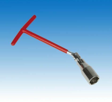

You need a long 21 mm, (exactly 20,8 mm) spark plug socket T-handel with an rubber insert to hold the spark plug.

In the U.S., that is a standard 13/16 spark plug socket.
