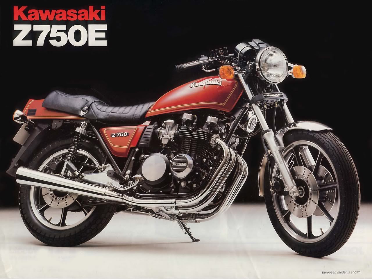

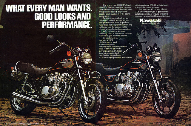

"LTDs" were the early Kawasaki "cruiser" immitators from 4-cyl standards(like the E), because that was what mostly sold in the US(still is). That was before the "real" V-twin cruisers; the Vulcans.
Thus the changes in the chassis were to make the standard look more like a "Harley"; buck horn tall bars, longer wheelbase (hence the leading axis), step seat, big rear tire....
....remember those silly, unridable choppers from the Easy Rider movie????…. those were the inspiration at the time(......yack!!!)

So basically the E is essentially the base model, and the LTD is a factory installed conversion kit. The differences are as such:
LTD has a triple tree with a few extra degrees of rake, giving it a chopper like stance.
LTD has longer forks to compensate for the extra rake.
LTD has a smaller, sleeker gas tank
LTD has mini-ape hangar handlebars.
LTD has a rear end that's basically all seat instead of the E's rear cowl.
Aside from that, they're pretty much identical. If you try to swap parts that are unique to the two models to the other, you're going to want to swap them all.
E's handle bars on an LTD bang into the tank regardless of which tank you have, due to the modified triple tree.
E's tank on an LTD, the LTD's handlebars bang into the tank because the E has a much larger tank and the handlebars can't clear the tank.
E's triple tree with LTD's forks results in a messed up looking bike that's unsafe to ride because your forks are too long and the bike is always pointing upwards.
E's forks on an LTD's triple trees has the opposite effect, the bike is always pointing down and it's horribly dangerous and I'd be worried about getting thrown off during a hard braking maneuver.
I didn't see if the E's cowl can be fitted on the LTD frame but I suspect it can, but you'd probably need the E's rear fender and seat pan as well, just like how for the front end, you either use all the parts or you leave it alone.
Also there's some wheel size differences, but I don't have any hands on experience with that side of things.
But suffice to say if you can convert between the models (except paperwork wise) by just swapping parts. They're drop in replacements for eachother because the frame is identical.
To answer the question about the engine. Yes. The engines are identical in every way... As long as you're using from the same year ranges. Clearly a 1977 750E engine isn't going to just bolt right into a 1982 750LTD frame any more than a 1977 750LTD engine will.
Since mine's an early 80s, I'll say this. from 81 to 84 I know for certain the E and LTD engines can have their engines swapped with no modifications.
I'm fuzzy on 80 and earlier, as I have no experience with them, but I have a fair degree of certainty that they 80 and earlier will not fit 81 and later.
