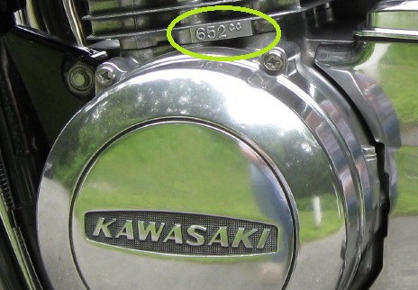

For sure that's a KZ550 frame, not a KZ650 frame. Please post the engine serial number. If it has a KZ650 engine the serial number will be on top of the engine case very near the oil filler cap, and on the other side of the engine the engine size will be molded into the cylinders as shown below. Ed

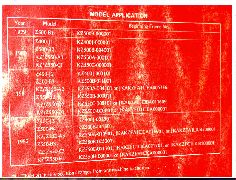

Thank you. Would that mean the bike is a 1980 because the Vin is 12 digits?
  • 650ed
  • 650ed's Avatar
  • Posts: 15334
  • Thanks: 2830
Re: VIN Number
08 Oct 2018 15:02
#792039
No eBay APP ID and/or Cert ID defined in Kunena configurationI don't know, but take a look at the back cover of the Kawasaki Service Manual in the link below. It shows the various years and frame numbers for KZ550 models. Ed

Re: VIN Number
08 Oct 2018 17:59
#792051
Here's the back cover:

Re: VIN Number
08 Oct 2018 21:31
#792059
Yup it's a 1980. Thank you
