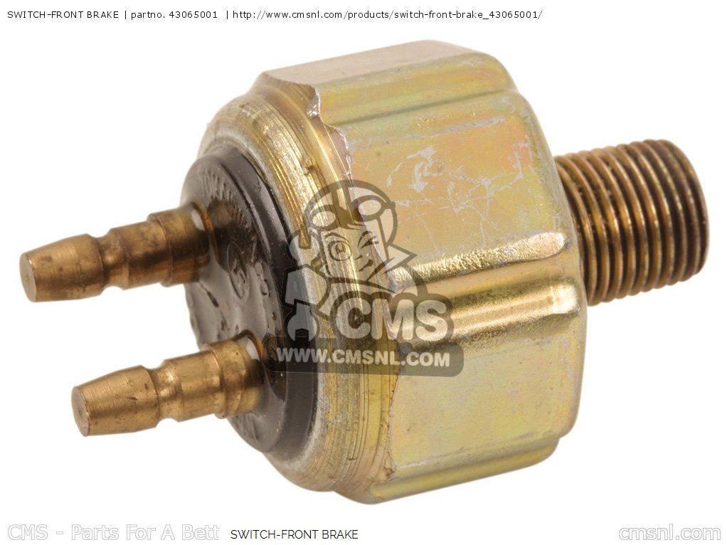

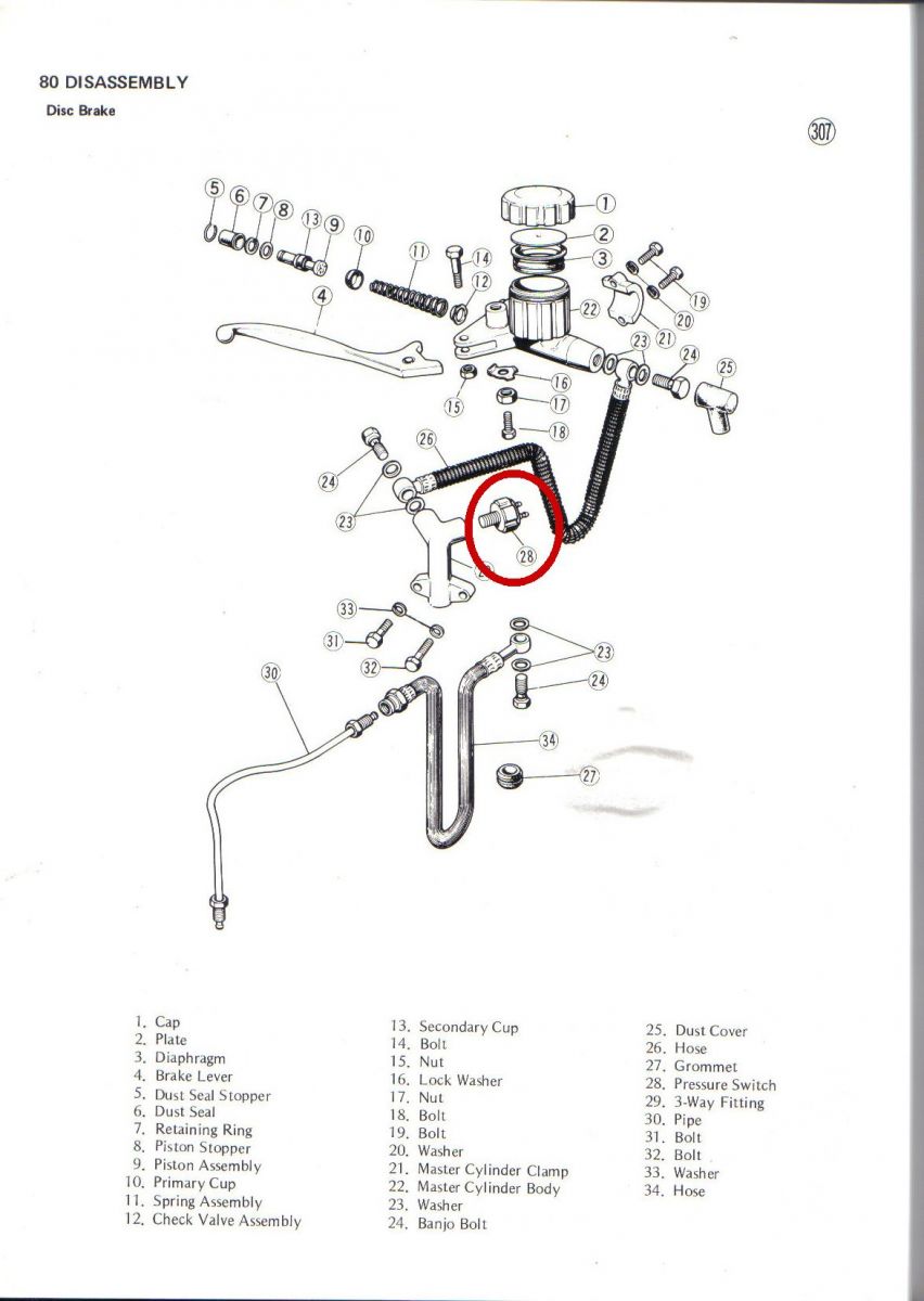

You need the break light switch #28
www.cmsnl.com/kawasaki-kz400-1974-usa-ca...59.html#.Wx8IT8Ysp-N
You can use the Z1/Z1B/Z1000 break light switch too
