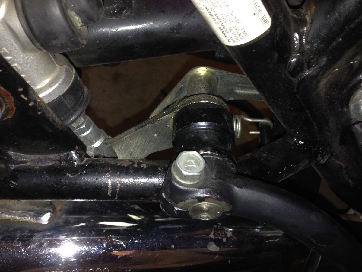

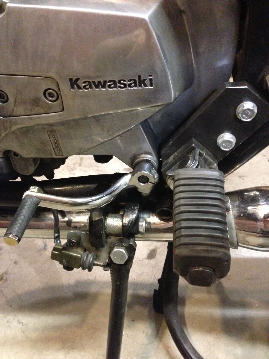

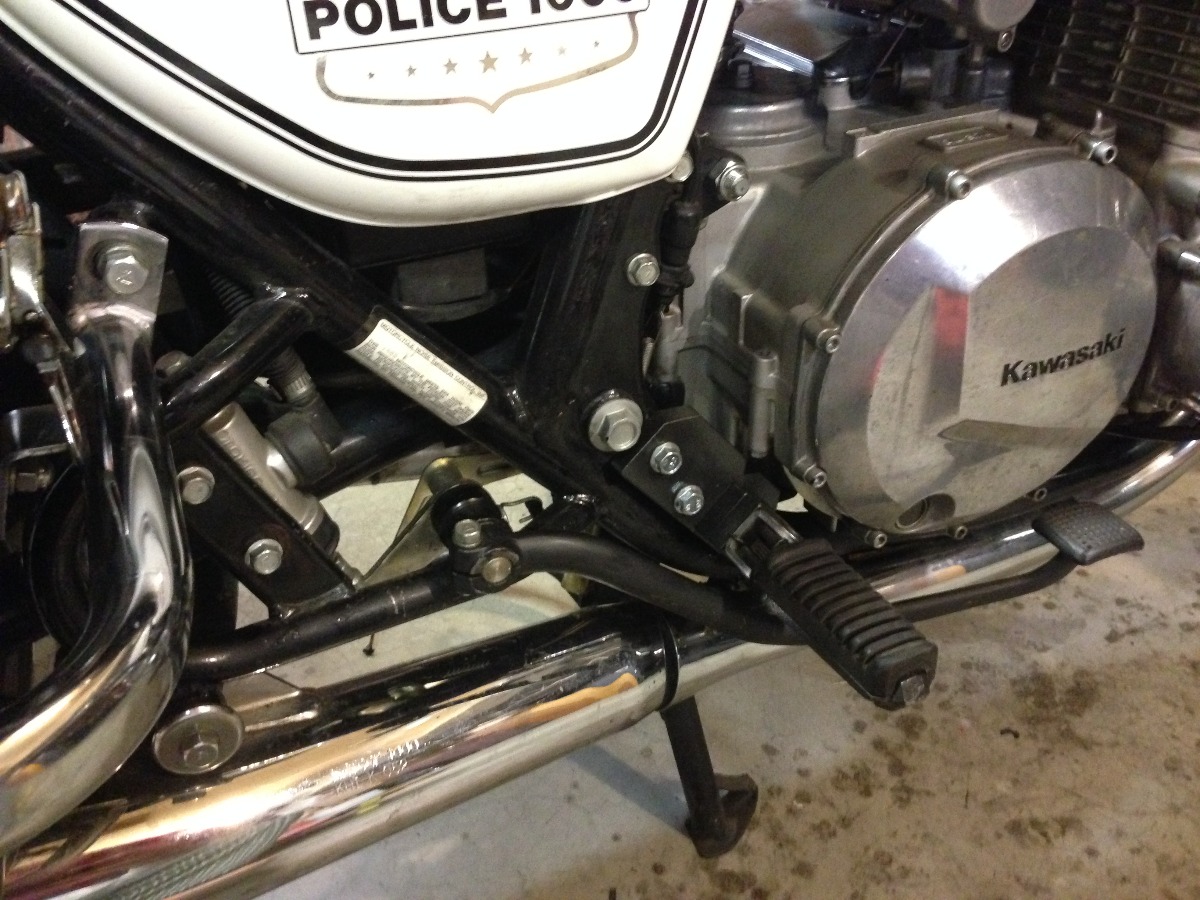

I couldn't stand the foot boards so I replaced them with pegs. Here is the link in this forum where I discuss that.. I start commenting on the second post. The images are no longer there so I'll post them again here.
I find the riding much more enjoyable with pegs. Oh, I also found a better shifter lever at a scrap yard. Longer shaft and I had to bend it a bit after heating with a torch, but now it is perfect.
