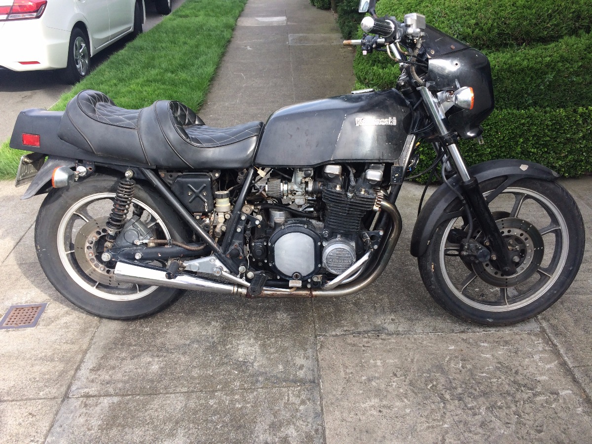

Sorry for the noob questions. This is my first KZ1000 and I'm unfamiliar with the bike. I just got this bike to rescue and it's needy.
I started looking for KZ1000 parts but having trouble know what will fit this unicorn and what won't compared to the other KZ1000 models.
What are the differences? I know the center stands, grab bars, seats, and forks are different than other models. Many pipes/headers aren't listing this model.
Any information is appreciated.

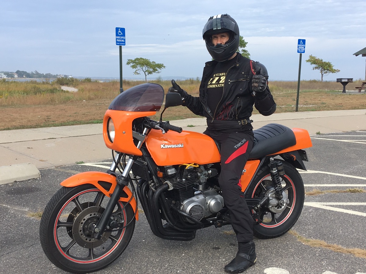

I have a 79 ST, and have done a full restoration, so here goes: the ST shares much with the MK II body wise, but the wiring is totally unique, and a real PITA : you MUST get the factory manual specifically to the ST. Pipes are nonissue. MAC and Delkevic both make ST headers and pipes for not too much.
I highly recommend replace all the rubber carb boots, carb fuel gaskets and diaphragm in the accelerator pump and fuel petcock.
With pods and 4-1 pipe, you can jet up pretty good and it runs really and very strong. New coils too and Dyna ignition.
I did a full rewire with a Motogadget M-Unit.
This is really the best option.

A nice fairing came with that bike. Really nice to have on highway. I have found that lower bars that put more of your weight forward make a huge difference in the maneuverability and balance of the ST. It rides really well if you are low on it. I had clubmans on it for a while, now drag bars, but because of the noted larger size tank, I had to add about 1.5" to the bars to make sure the switchgear clears the tank on full lock. The master cylinder is a pretty big block as well that you have to work around. Both masters were honed out and rebuilt on my ST as well.
