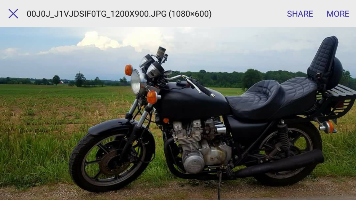

It sounds like the previous owner made some changes to it. Can you post any pictures of the bike? Ed

Egads - I would NOT buy that bike.
Both wheels, disk rotors, exhaust, and front fender have been changed to non-original items (why - was it in a wreck?); those silly velocity stacks on the carbs mean it has been sucking unfiltered grit, road grime, etc., etc. into the engine through the carbs so the engine most likely has a lot of premature wear (notice the bike is on a dirt/gravel road so lots of opportunity to suck in grit); the carbs are leaking like mad; that black paint job on everything including the fenders, shocks, exhaust, gas cap, etc. is a mess; etc.
Unless the buyer plans to spend a LOT of bucks and time turning it into a safe, reliable bike I suggest he look elsewhere. Ed

AS 650ed say, stay away from this bike. It is a never ending story
Buy a near stock bike!!!!

I agree, that thing needs to go to sleep like a sick cat. Seen it's better days. For the most part, the biggest problems, in my opinion, of the KZ650 are the points ignition, and the frequent oil leaks from use of 500 rubber orings in the engine that all go bad one at a time.
