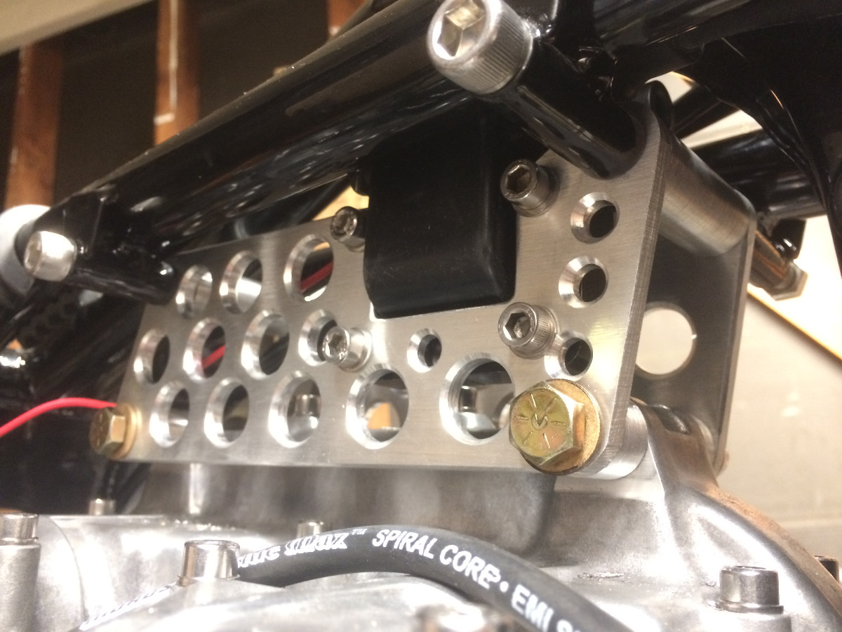

My $.02 ... I would brace the frame since it is relatively cheap and simple to do, and more importantly it will most likely help deal with the increase stiffer forks and swingarm inputs to the frame. There is a thread on here somewhere of people bracing their 1000 frames. adapt that to the 440 frame. If you want to go even further, over-sizing the motor mount bolts to remove the factory tolerances and remaking the motor plates out of aluminum plate will help tie everything together to form a more rigid structure. I have done both on my kz1000 and kz750 twin. I haven't ridden the twin yet but the 1000 is much more planted at speed.
Last edit: 22 Sep 2017 23:31 by DoctoRot.

the motor mount holes are way oversized. I went to 7/16" on the M10 holes and 3/8" on the M8s. On two M8 holes that i tried to ream out the reamer fell through without turning! lots of room for improvement. plus they look awesome, check out the upper mount on my 750 twin. you can make something like this, the inline 4 motors don't have a head mount like this but the twins do.
make sure you get a real good fit-up on the braces and weld it with the motor and swing-arm bolted in to act as a jig..
lots of info here> kzrider.com/forum/5-chassis/294594-frame-bracing?start=120
