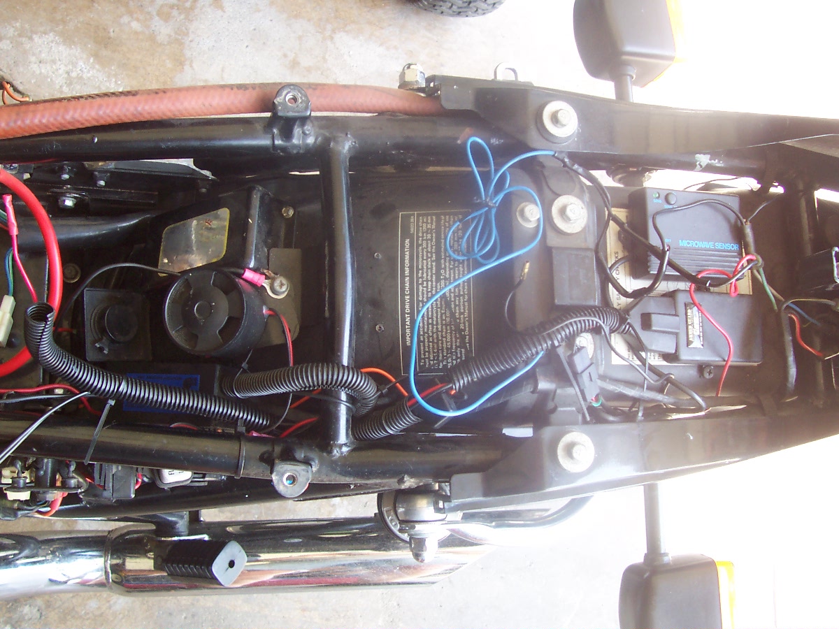

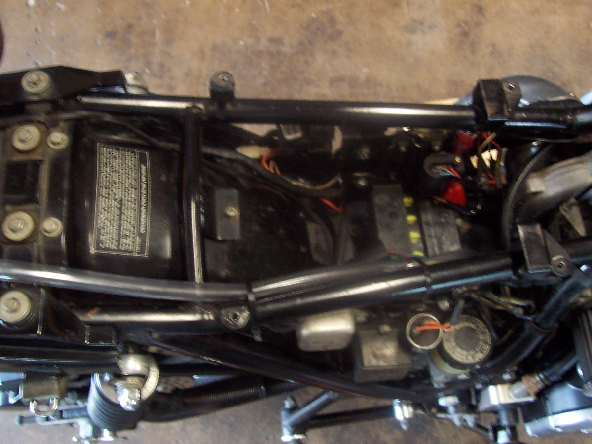

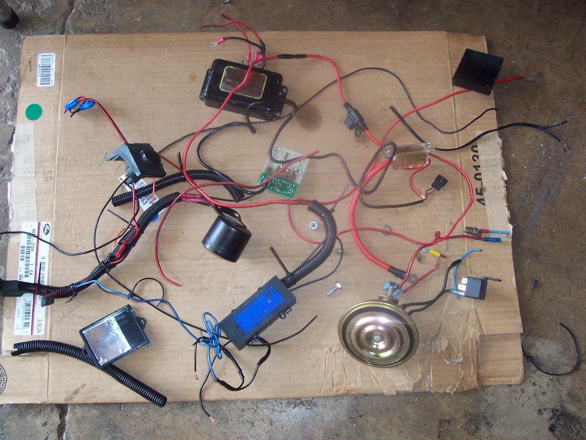

Today rained out at work at spent a few hours removing all this crap. Gus did an admiral job hooking up all this stuff. There is an alarm system , non functioning rev limiter , cigarette lighter, all this installed without cutting or butcher the original wire harness !
Before
after
Here's all the crap I took off

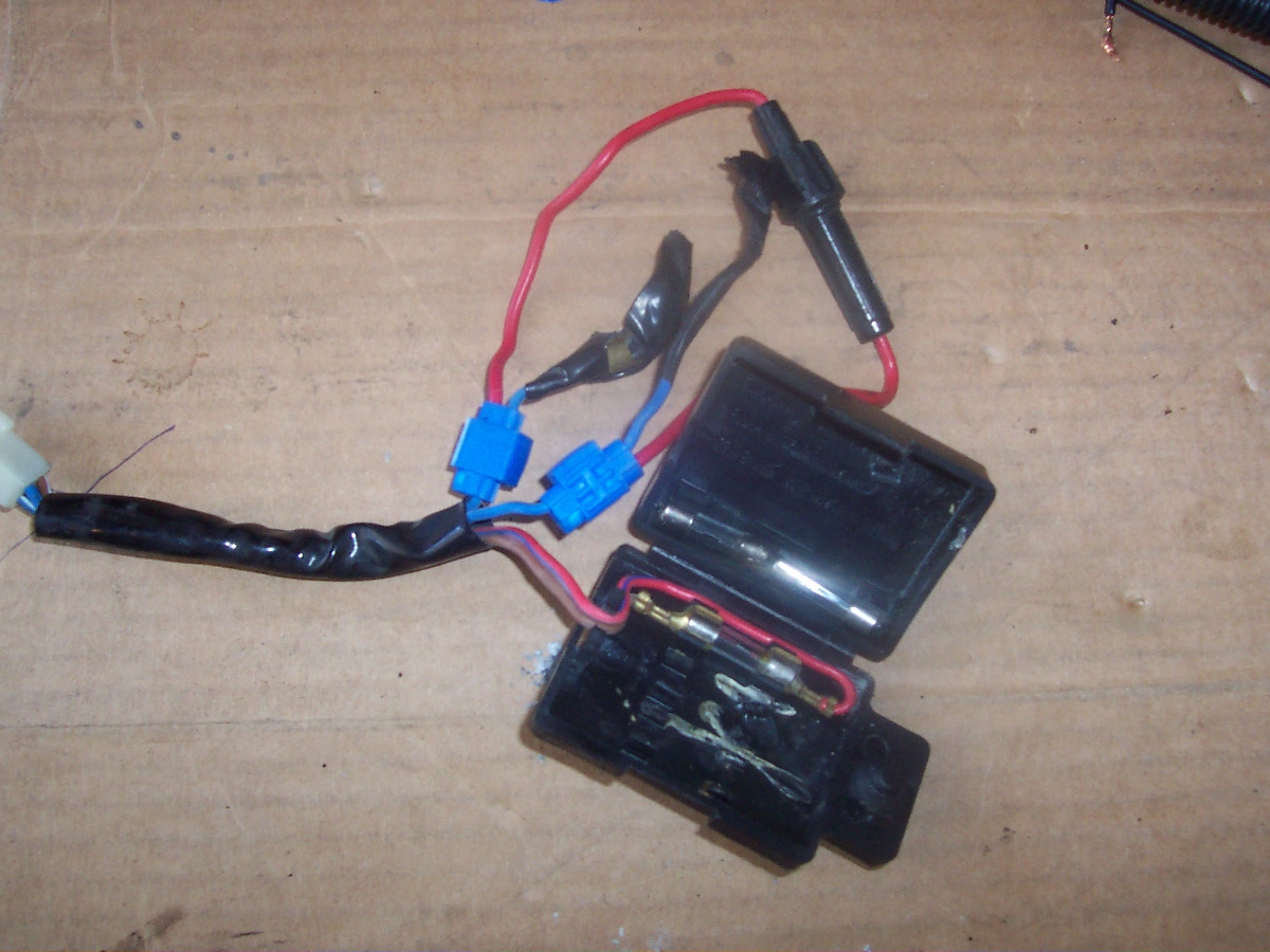

Well I did have to replace the fuse box
old
new

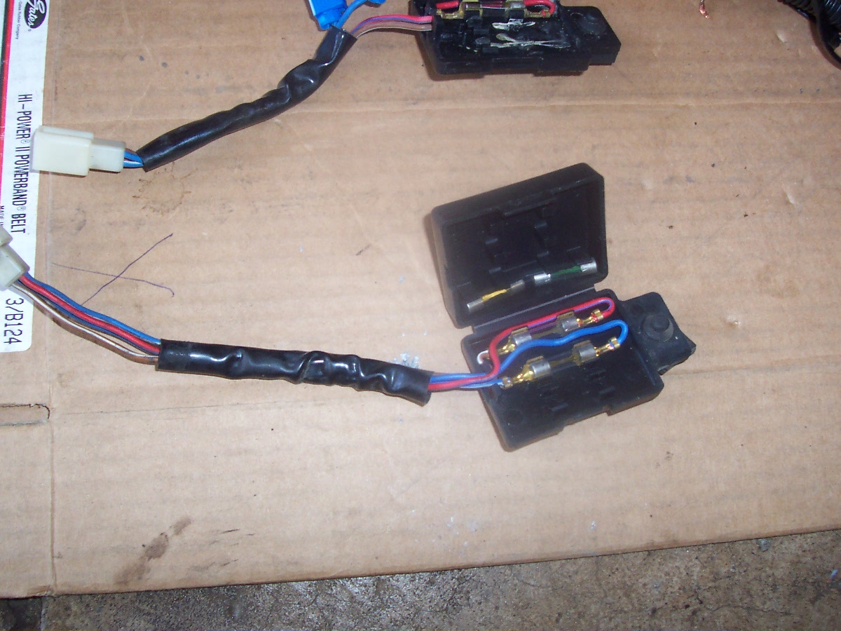

old
new
