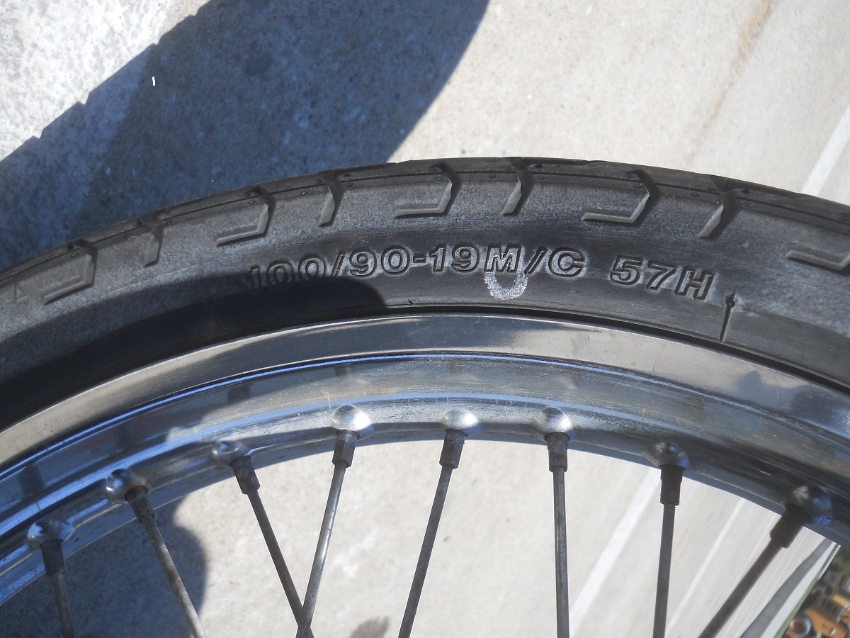

- Rainman
- and a little Kaw shall lead them
- Posts: 597
- Thanks: 76
Re: Z750b1 miss fire
03 Jul 2017 15:06
