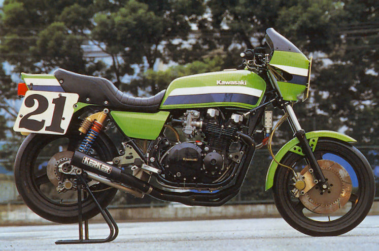

There's advantages! Do some homework on superbikes of that era and read some of the rules if you can find them. You start to see the evolution of the superbike brought on by innovation by these racers and teams. Fact based data, look at the big win years and compare to the prior years and you'll see where the changes were made to improve handling. If larger wheel/tire setups didn't work, they would still be running 18 skinnys. Realize, it is the package, same goes for frame geometry, brakes, shocks. it's a package thing!

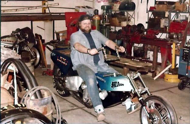

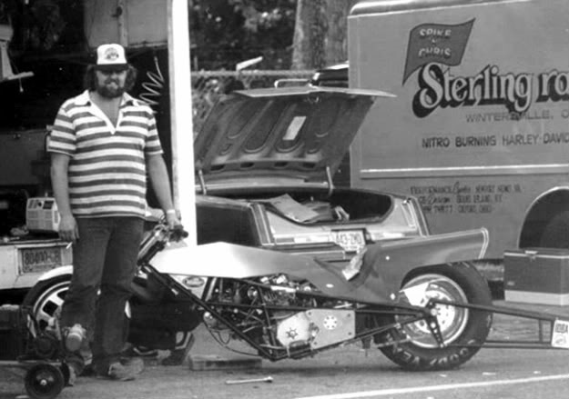

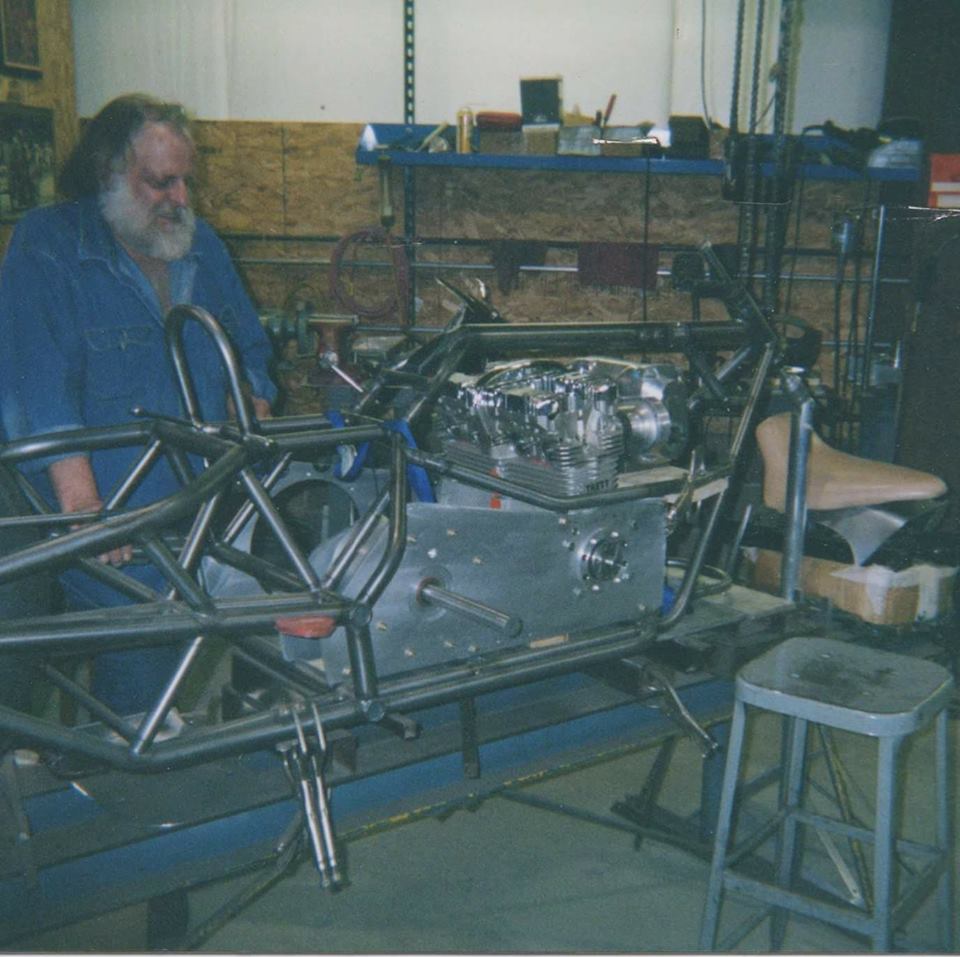

Hey 9 er! What do you want? I motorcycle for the Daytona 200? Or a mellow cruiser to got to the edible store, then go to the cruise night joint and hang out and be COOL? You have a couple of Kawi's. Build one for the cruise nights! 30-40 MPH around town! 100mph on a straight road for 10 seconds. Get that nice old school new build swing arm from Les! a 3.5 Akront rim and a 150 tire. could squeek by with a 3/8" offset. of take your Lester and a stock 16" Mag, cut those halfs off, cut the lester and make a double weld! There was a guy on here a few months back, he never stuck around! But I asked him for pics of that double weld lester. How about a $1000 Billet Victory motorcycle 8.5 x 18 wheel with a 280 tire With a $400 chromoly double club foot swing arm welded solid in a raked 79-80 Shaft drive KZ1000 frame? One of my projects After all of that. I'll probably only get $500 for the roller! Hey, I am partial to the drag style hot rod!
I hung around with the Best Builder in the World! The infamous " Puppet"

Puppet! James DiTullio, noted as the best top fuel bike chassis builder of all time. Some good reading about him out there!
Les
