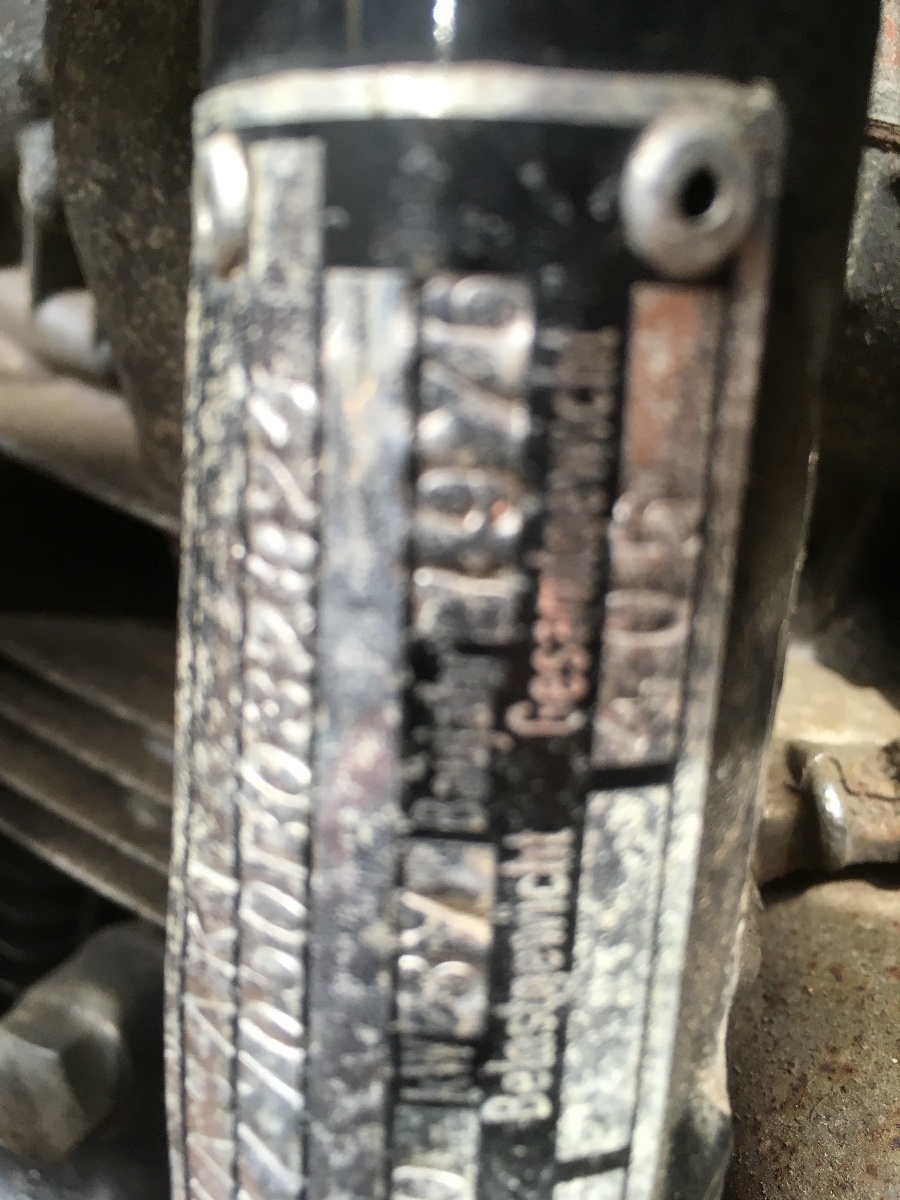

Bike identification
30 Apr 2017 02:46
I'm trying to work out the exact model i have, It should be a KZ750 twin.
Apparently it was imported from America, but the chassis plate is all in German.
The vin number is KZ7050BO32824, Year of manufacturer is 1976. The vin seems to be wrong for a 750 and the date seems early for the bikes release year.
It also has twin discs.
Just trying to order parts and not sure what model.

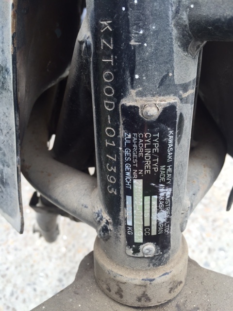

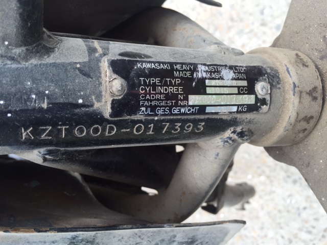

I think he is talking about this kind of chassis plate
www.kzrider.com/forum/11-projects/602564-kiwi-z1r?limitstart=0
www.kzrider.com/media/kunena/attachments/42454/IMG_4281.JPG

The vin is KZ7050, which is what is odd. The engine stamp is for a B1 and the chassis vin date is 1976

If you mean the white vin label is KZ7050, then someone may have made a replacement label. possibly because the old one was messed up. or for illegal reasons, such as to sell an untitled or stolen bike.
What number is stamped into the frame at the steering head?

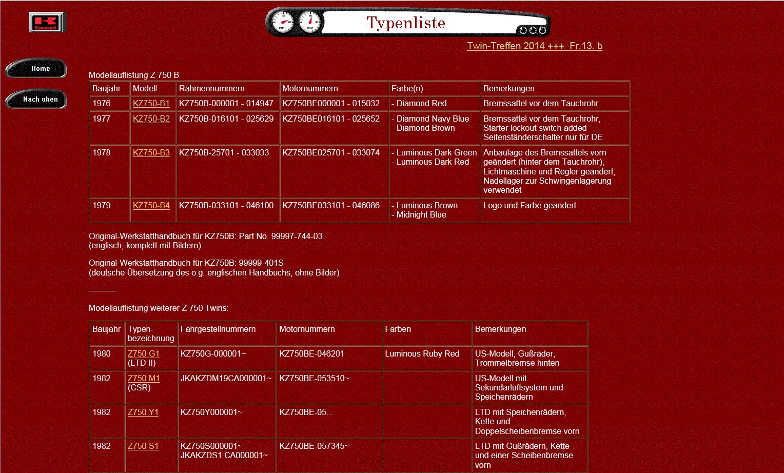

30 Apr 2017 06:10
The vin plate is a replacement with hand stamped typos
Someone stamped it wrong KZ7050, should KZ750B
KZ750 Twin German forum
www.z750twin.de/typenliste.htm
The steering head number is the real number

Forgot about the stamp at the steering head thats stamped as kz750B and the same numbers as the vin.
Looks like the vin got an extra digit.
Hope it's not stolen, will do some research.
