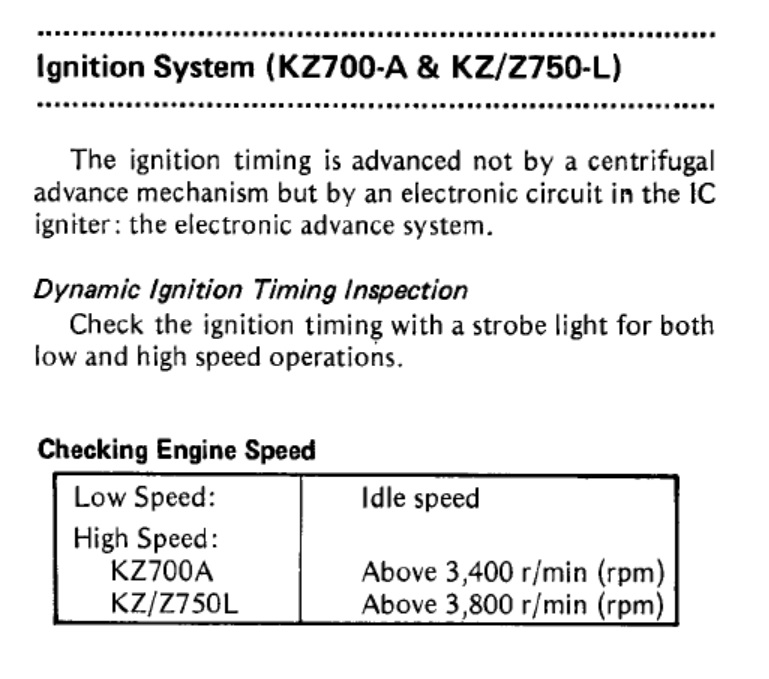

The following timing info is from page 409.
Perhaps the manual provides more detail about checking timing with a strobe light in another section dealing with a KZ750 model.

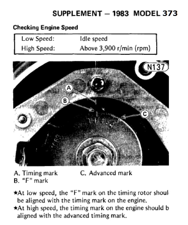

Check out page 373 --
If the timing checks out okay, would suspect imperfect carb pilot circuits.
